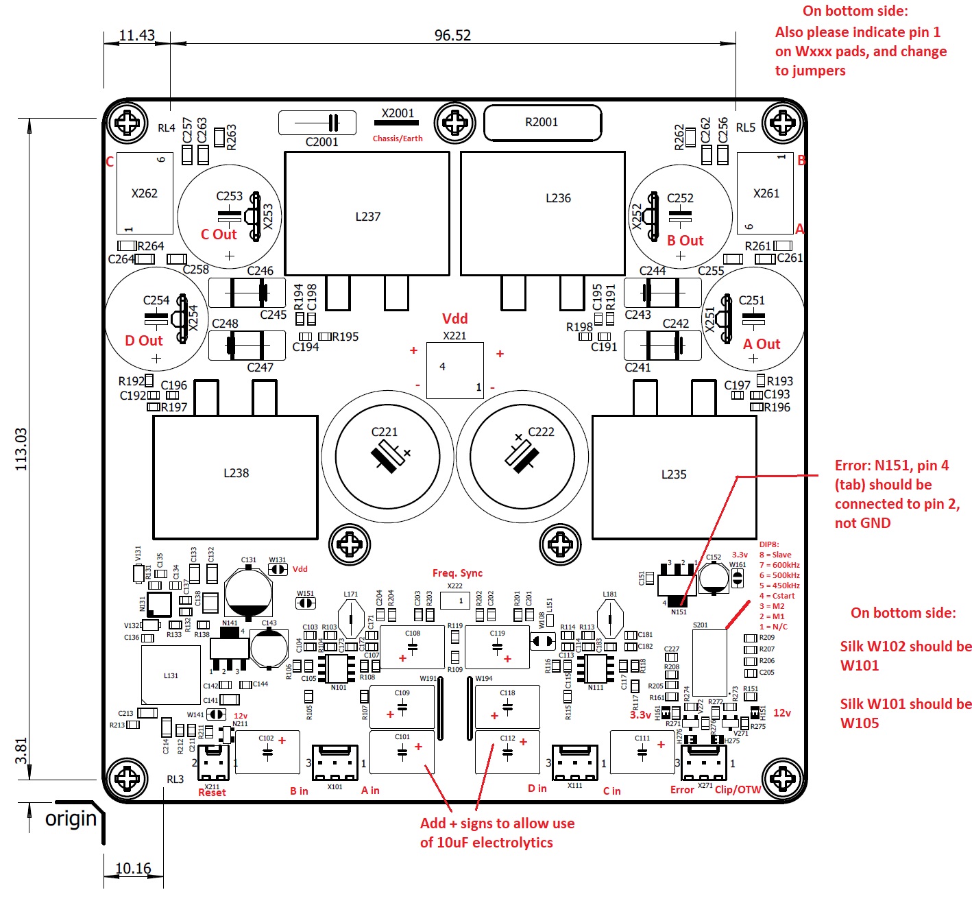

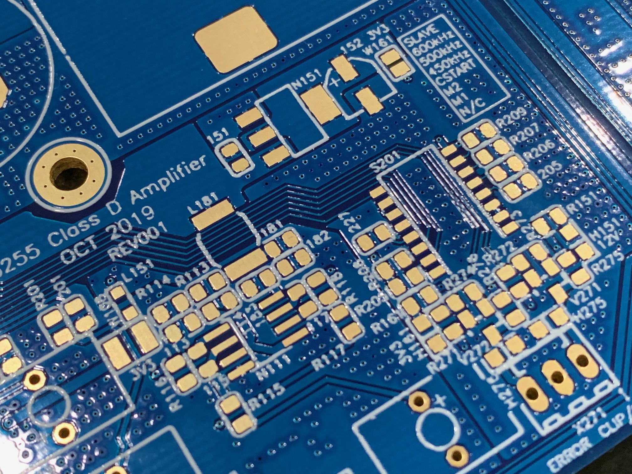

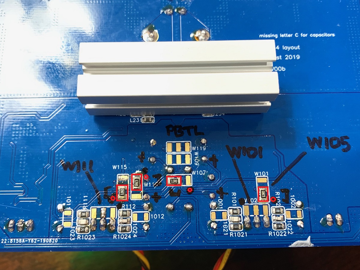

The main issue is to put a piece of Kapton or other insulator over the tab (pin 4) of N151 - the 3.3v LDO to isolate it from GND. Else there is a short. Otherwise the board is functionally fine. Take note of silkscreen typos on the Wxxx pads on the bottom. There, just follow my photograph and marked up diagram to connect solder pads for stereo BTL. I assume that’s the mode you want. Also, taken note that PVDD positive are the two pins closer to the TPA3255.
So ignore the ++ and - - on the Vdd (X221) connector on diagram below, however other notes are correct:
785744d1570209469-tpa3255-reference-design-class-amp-gb-tpa3255-v0b-revision-notes-v2-jpg

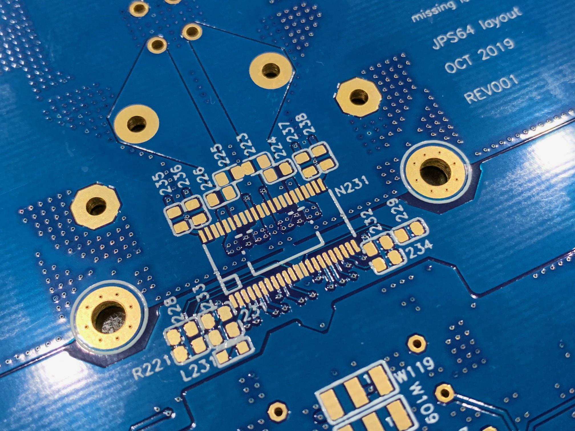

Here is photo of how to connect Wxxx jumpers (follow red rectangles) for stereo BTL with balanced inputs, use a low value 1210 resistor if you don’t have any 0R jumpers or a small piece of wire works too; red circles indicate pad number 1:
783338d1569354580-tpa3255-reference-design-class-amp-gb-tpa3255-solder-pad-jumpers-config-stereo-btl-mode-photo-jpg

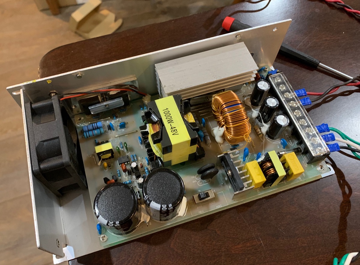

I bought one of these 800w 48v SMPS designed for LED lighting from Aliexpress a few months ago. I set its internal switch to 120VAC input (220VAC is an option), and wired it to an EIC socket with earth ground.
I connected it to the amp, not expecting much as I had already tested out a much more expensive Connexelectronic 800w SMPS ($150) and was dissappointed with the excessive added hash noise.
Well the cheap $44 one from Aliexpress surprised me. It is not noisy at all, and in fact, is close/idenmtical to the 12v battery and DC step up in terms of low noise performance.

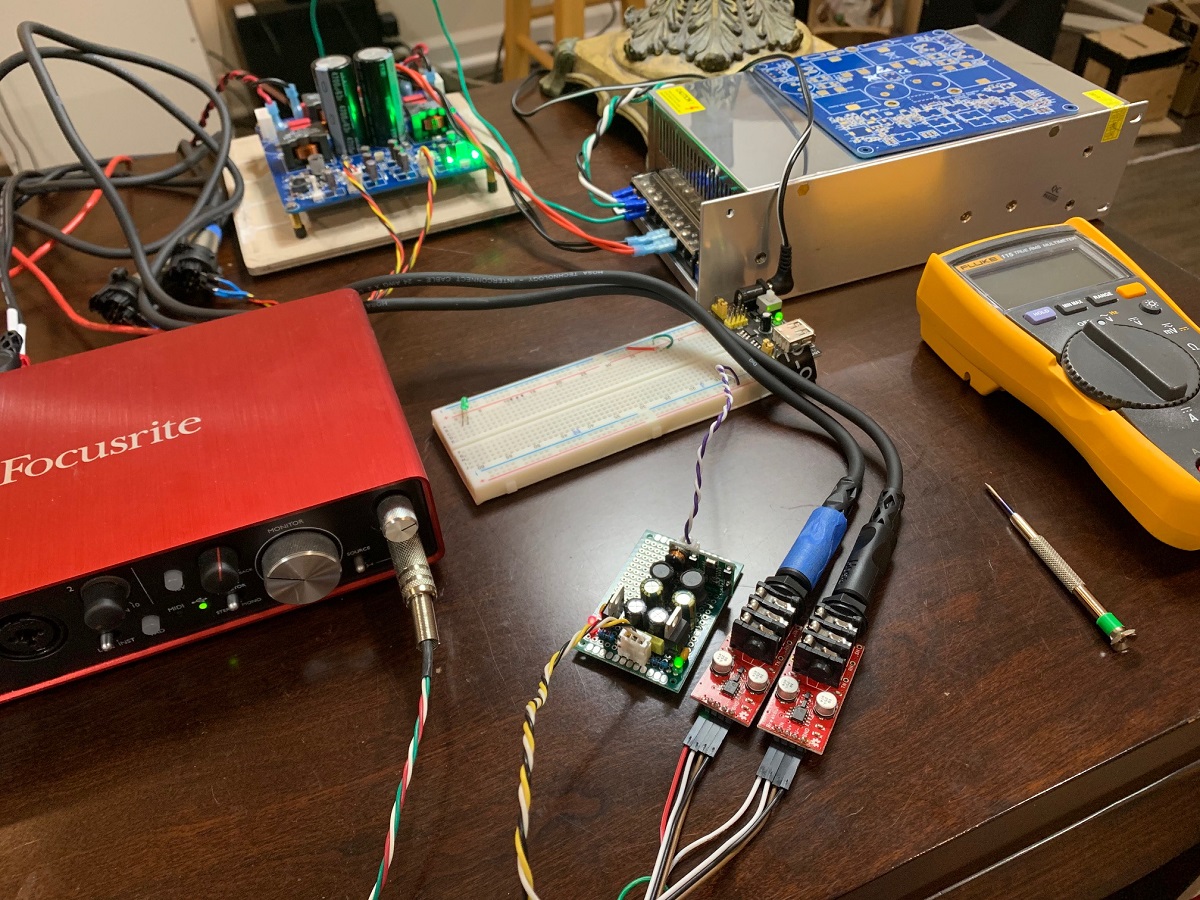

Here is a photo of the setup shown connected to speakers for listening:

Here is a closeup of the inside of one of these SPMP from venfor AIFENG on Aliexpress. I had to disconnect the internal fan cable and let it run naturally cooled for now. The fan was way too noise and this deserves a better fan. At normal volumes, it is not even warm without a fan:

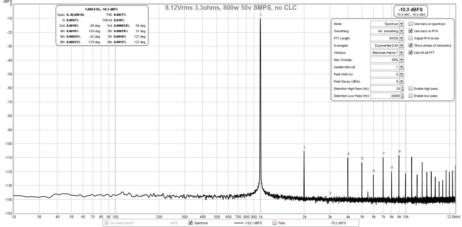

Here is the measured FFT for 8.12Vrms into 3.3ohm load:

Here is the FFT fo 4.36Vrms (graph label is incorrect) into 3.3ohm load:

Has anyone noticed the transformer labelled "48V 1000W" which does not have creepage or clearance between primary and secondary windings, as mandated by safety regulations and routinely implemented with margin tape or triple insulated wire or split windings? A Chinese Special.
You mean my $44 Chinese made SMPS doesn't have UL/CE required double insulated isolation between the mains and output? 😉
I do not know how SMPS like this work, but the transformer looks very similar to other UL-certified SMPS of same rating that I have. Could the double insulation or margin tape be embedded underneath the external copper windings?

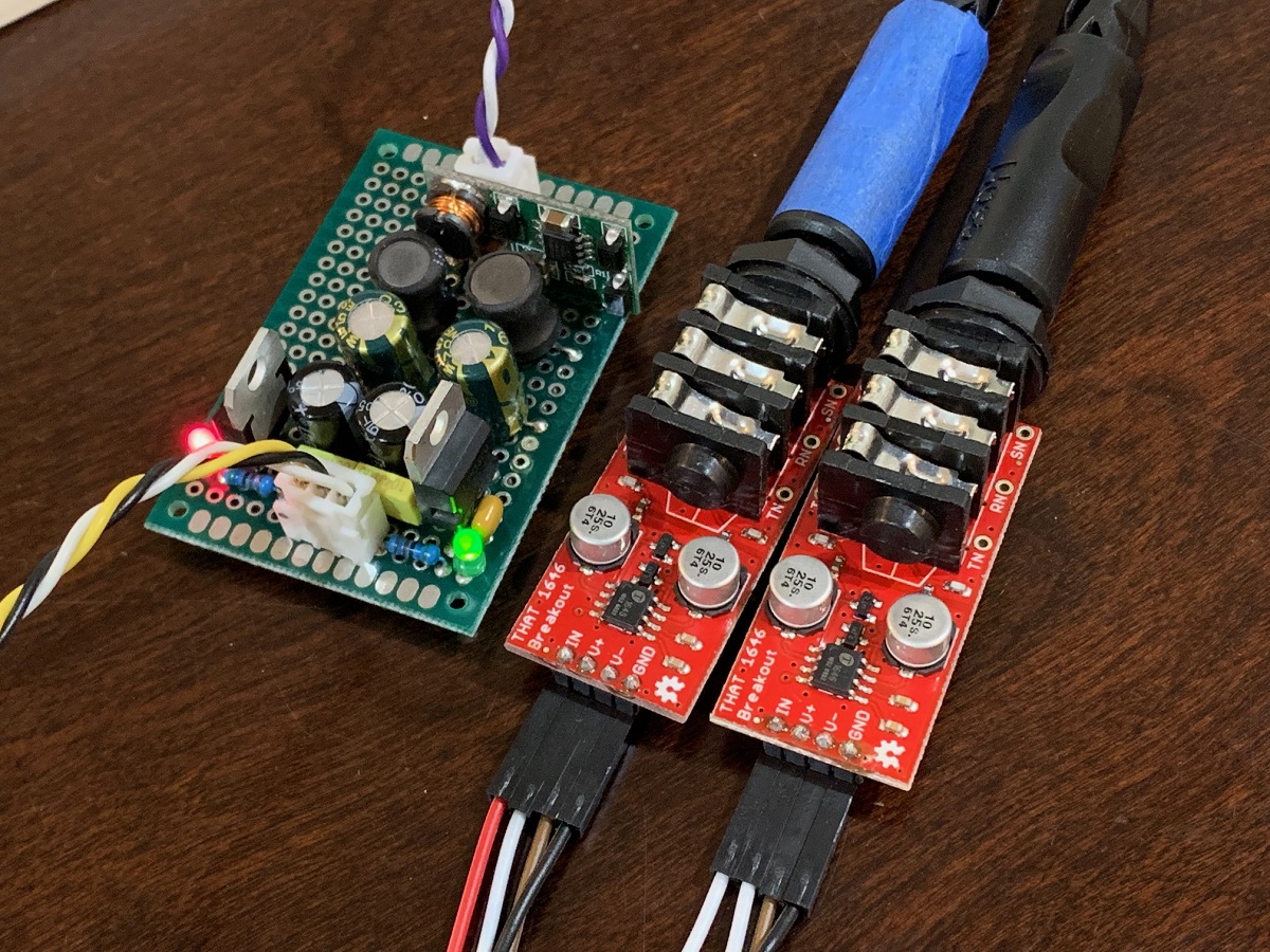

I just got some THaT1646 SE to balanced converters from Sparkfun. Nice easy to use units.
787286d1570864723-se-balanced-line-converters-that1646-se-bal-conv-test-tpa3255-02-jpg
787287d1570864723-se-balanced-line-converters-that1646-se-bal-conv-01-jpg
I made some +/-15v power supplies from a +/24v DC-DC (5v to 12v input) with LC filter and LM7815/7815 regulators.
Driving signal from headphone output of Focusrite. Works well and sounds great. Silent - no added hiss or hum at speaker cone.

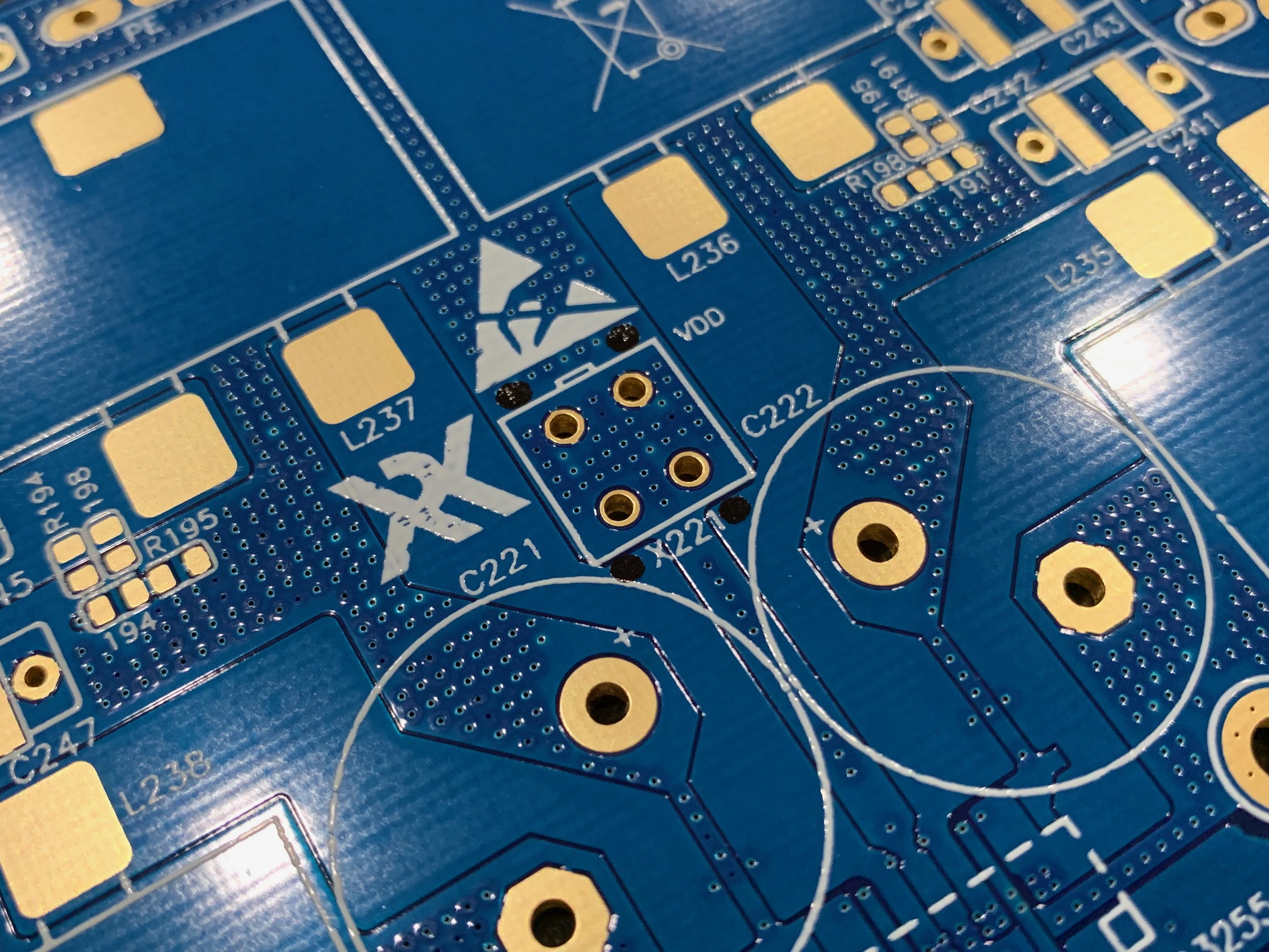

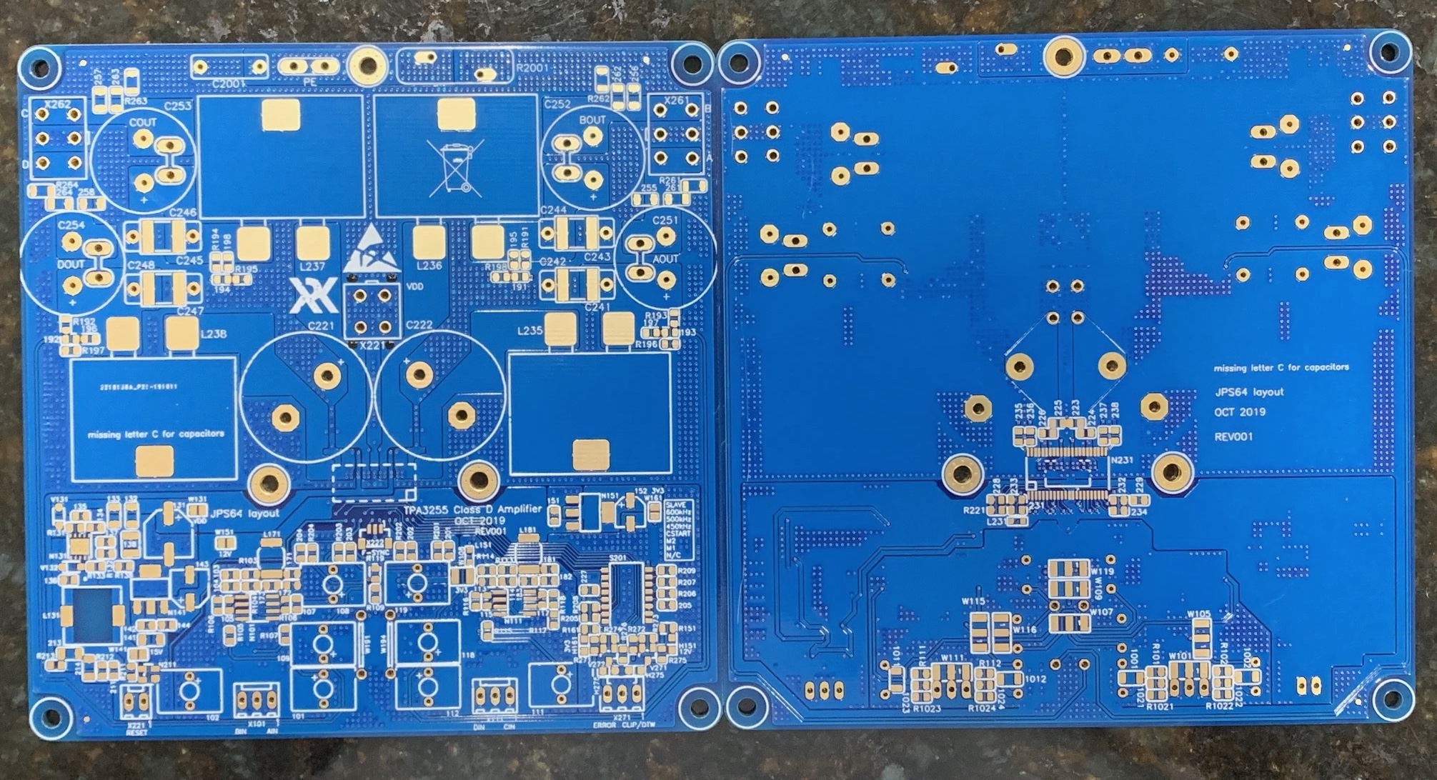

Boards have arrived. I put a black dot with a sharpie over the incorrect Vdd polarity markings. The revised 3.3v LDO pads look good.
