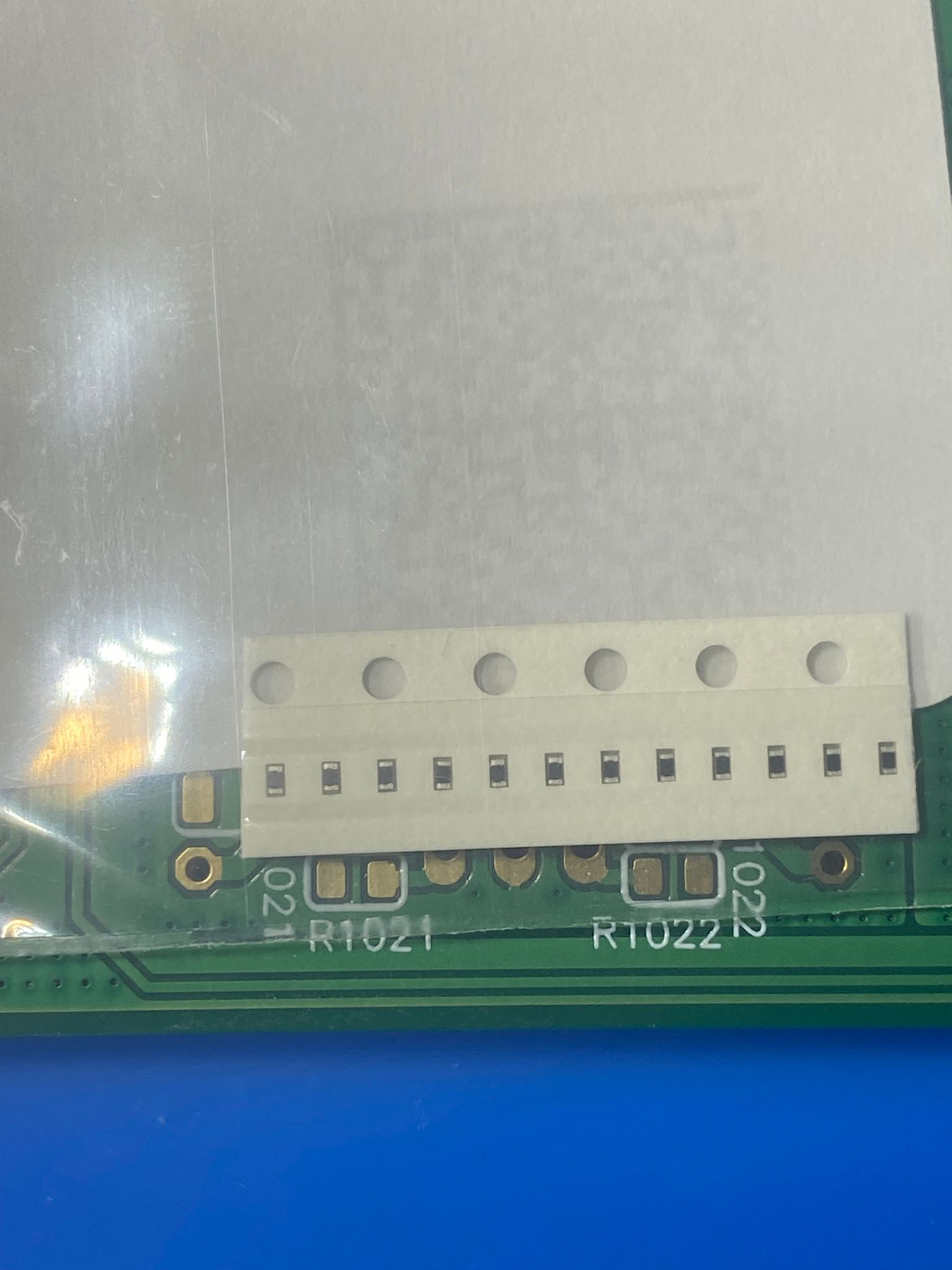

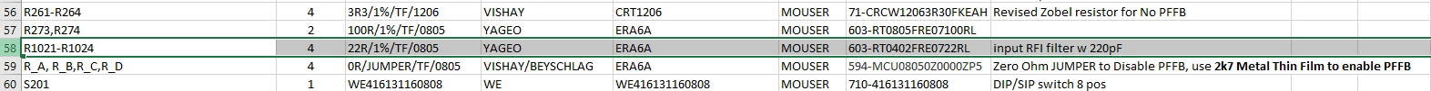

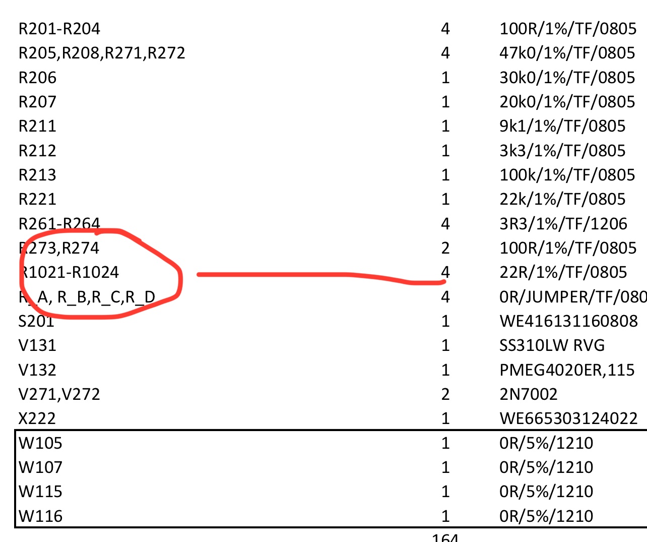

There is an issue with the BOM. Some resistors are not specified in the correct size, should be 0805 instead:
I am only passing this on from the Romanian solder slinger, so not sure if there are more parts like this.

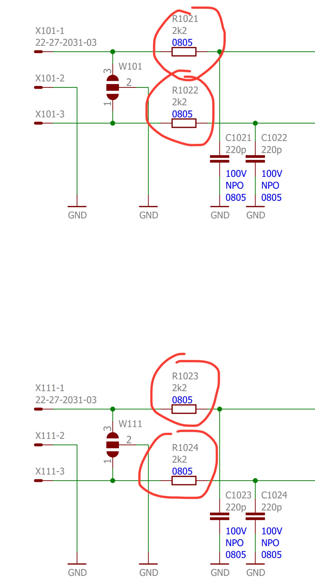

Sorry that there seems to be a mixup there. I have never had this error reported before, and in fact, hundreds of boards have been produced with the correct part. The BOM shows R1021-1024 as 22R 1% Thinfilm 0805. Please see screenshot below.There is an issue with the BOM. Some resistors are not specified in the correct size, should be 0805 instead:
Perhaps we can verify the version of the BOM that builder in Romania is using. But I see that maybe the confusion is the part number specified points to an 0402 part. That is clearly an error in the BOM.
The schematic shows this as 2k2 0805. I do see that there is an inconsistency here.
