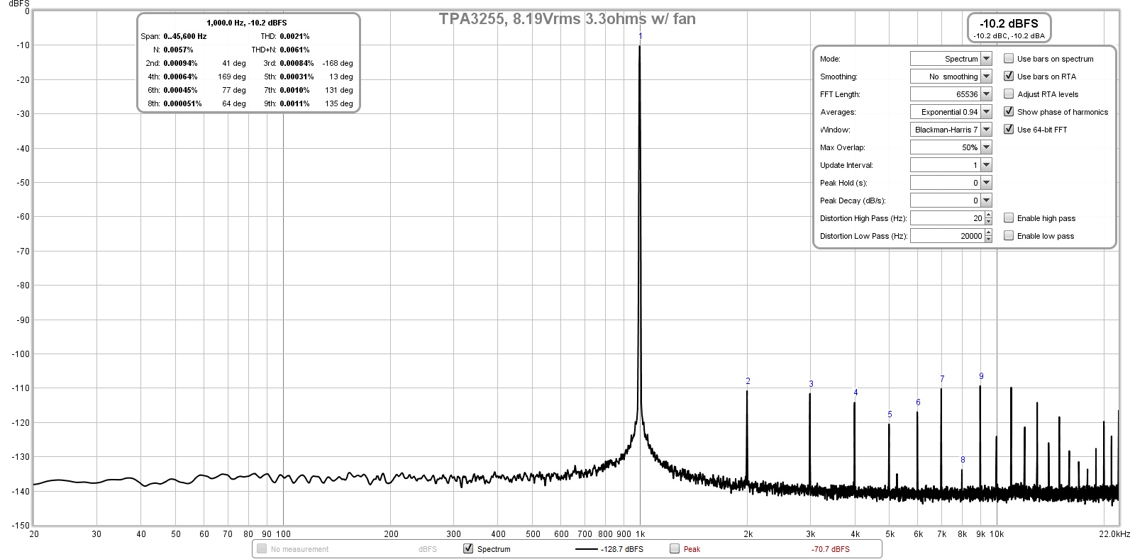

I showed this for one case back on Post 165, distortion is remarkably flat vs higher freuency (higher orders by about 10dB increase from 1khz to 10kHz, but overall THD is about the same):
783516d1569420234-tpa3255-reference-design-class-amp-gb-tpa3255-rev0b-5-14vrms-6-6ohms-btl-sweep-jpg
The graph depicts H2=-84dBc and H3=-90dBc @5.14V into 6R6. Not too bad, but not really impressive. The seemingly flat response may be due to the relative high levels even at low frequencies, compared to the TI-EVM. This measured here H2=-92/-100dBc (outAB/CD) - but at 10Vrms into 5 Ohms. My personal mono reference showed H2=-102.7dBc. So there should be room for 10-20dB improvement, specially concerning H2 distortion.

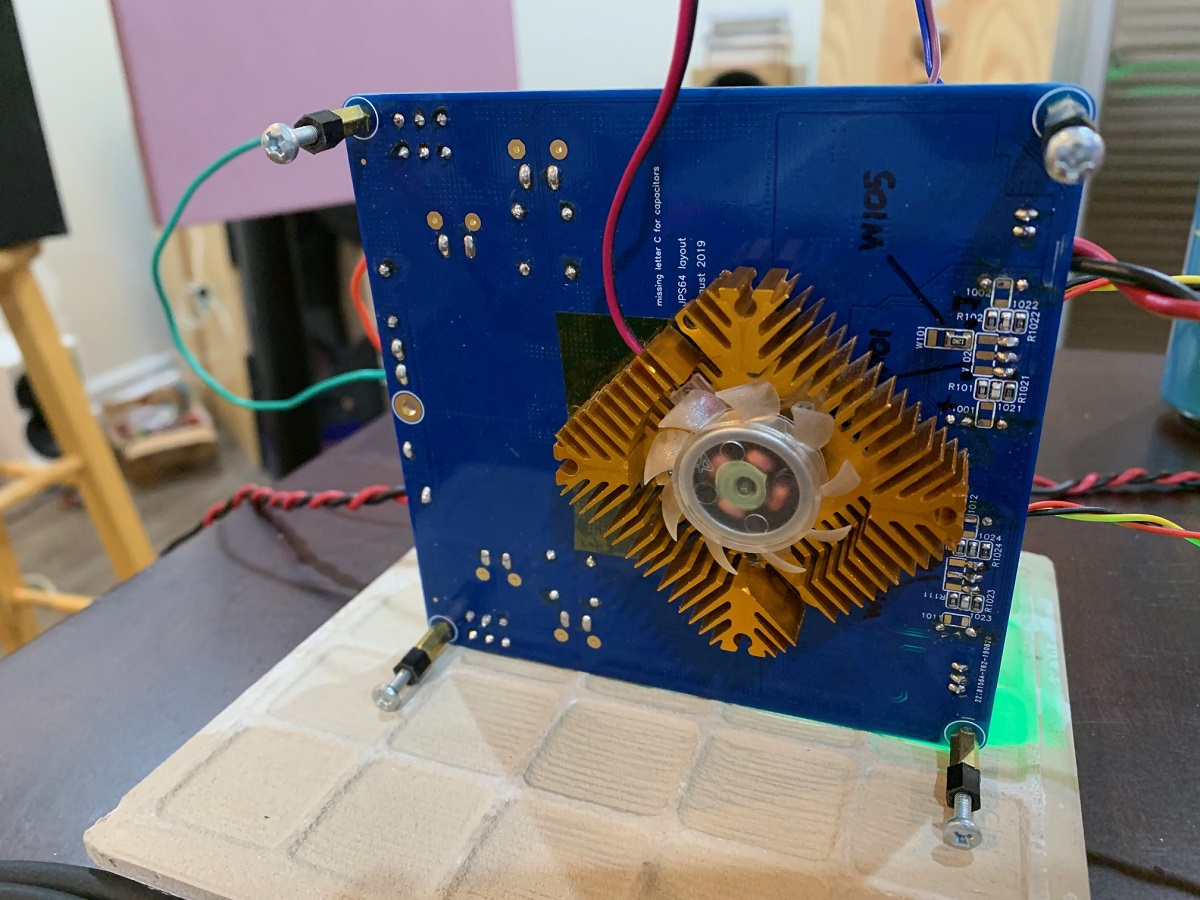

One final test to get high power before I proceed with the production of assembled boards, exposed a few errors on my part. (1) there appeared to be a cold solder joint on one of the legs leading to the bootstrap cap - so I touched and reflowed that with a soldering iron. It may or may not have been a good connection.(2) I saw that my R121 was still at 220k, and so replaced it with a 22k (not sure how that happened because I made a note as if I had changed that). Replacing that fixed the problem and the amp will actually run at higher powers now without hitting the OTW/Error light.
I added a fan cooled CPU to for good measure to run at higher powers. I am able to get 25Wrms into 3.3ohms with the fan off. I used a 100ohm 1W resistor between the fan and the on-board 12vdc supply to quiet the fan down. Connecting the fan with the on-board PSU seems to generate a -100dB ground loop peak at 60Hz for some reason. Very strange as it is only connected to the on board 12v supply and analog ground. Short story is: us a larger passive heatsink or an external PSU for the fan if you must. Or attach it to a metal chassis bottom plate, as designed.

The measurement of the FFT, THD, and SNR at 8.12Vrms into 3.3ohms shows 0.0021% THD and H2 and H3 about the same relative level now. This is down from 0.0026%THD previously measured at the same setting. Slight improvement. SNR is 127dB as measured.

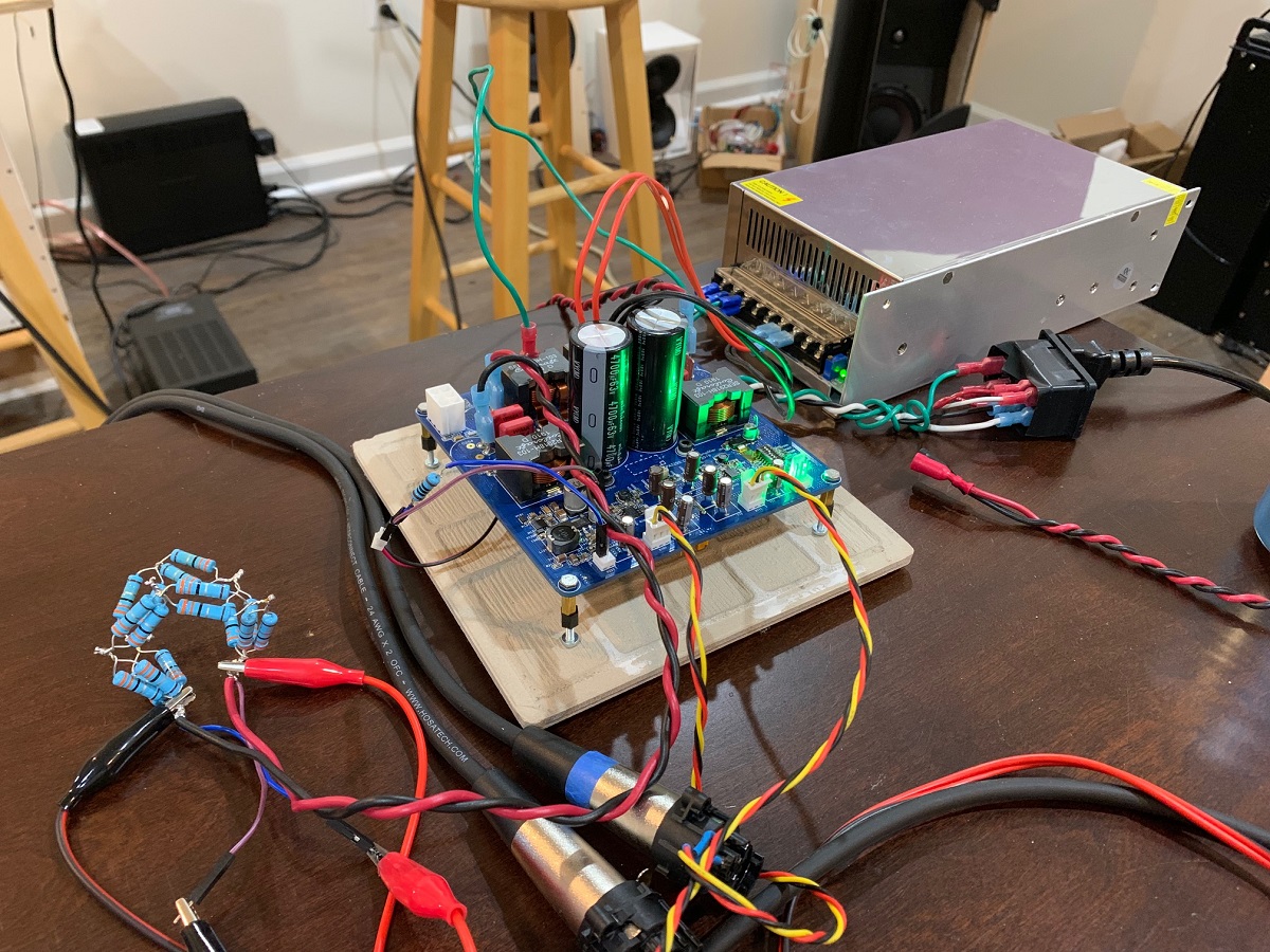

Will have to drag out the big 200w 4ohm resistor to do the big power test.

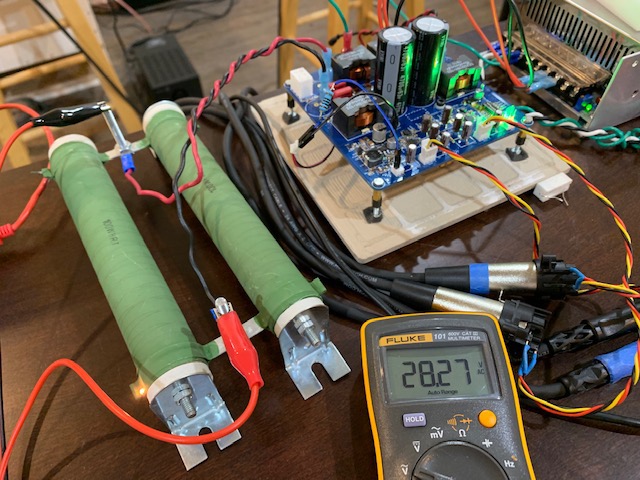

Final test shows 28.27 vrms into 4ohm load (200Wrms) is easily made without issues using the $44 SMPS.
794241d1573562561-tpa3255-diy-discussion-design-etc-a5d73f3c-af52-4a95-8847-96be8d8ad004-jpeg
Amp is now fully tested and verified to go to assembled production as balanced input BTL stereo output amps.
