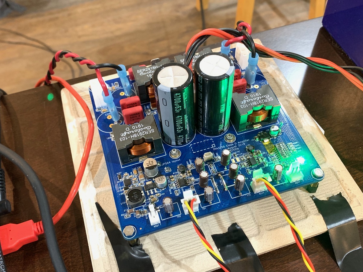

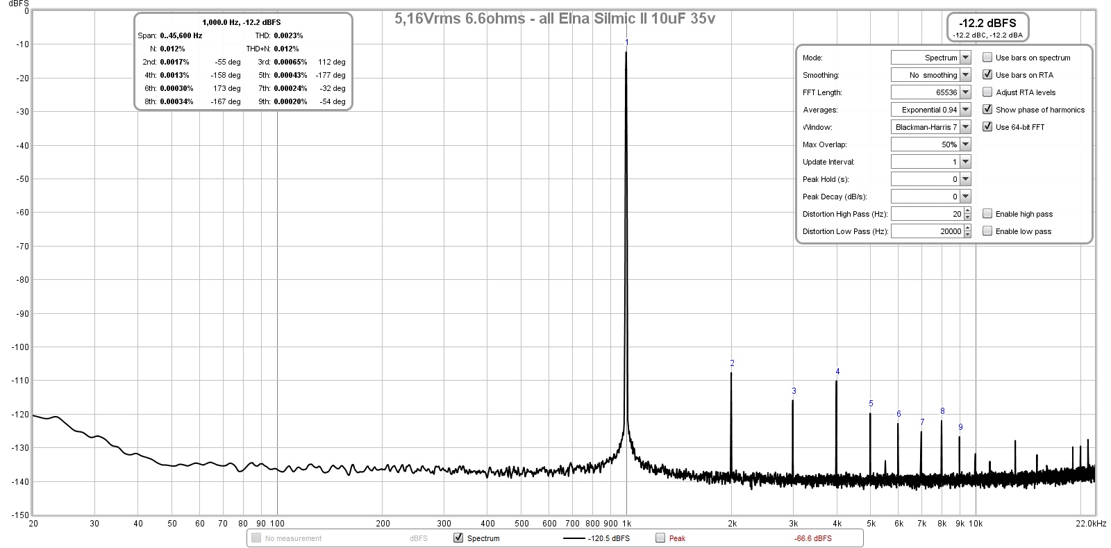

I removed the CLC filter between the DC-DC step up and the amp. Also changed out the 2.2uF film caps for all 10uF 35v Elna Silmic II's to get the full bass extension. Listening tests now and it sounds great. The removal of the filter did not hurt the noise spectrum. THD at 5.16Vrms and 6.6ohms is now a bit lower at 0.0023%, still H2 dominant.

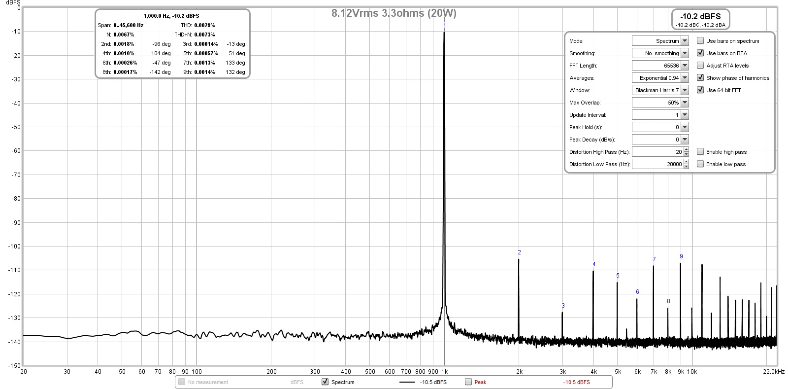

I made a 3.3ohm 32w resistor with 16 series parallel 3.3ohm 2W resistors. I set the amp at 8.12Vrms for 20W power. A moderate level that would correspond to pretty loud music playing.
Here is FFT for 20W into 3.3ohms, about 0.0029% THD and still second harmonic dominant but higher orders 7th and 9th are appearing.:

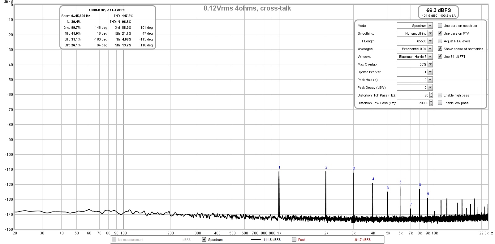

Here is Crosstalk for driving 8.12Vrms into 4ohms, monitoring 3.3ohm load on un-driven channel with audio input on undriven channel disconnected. About -101dB crosstalk measured:
attachment.php

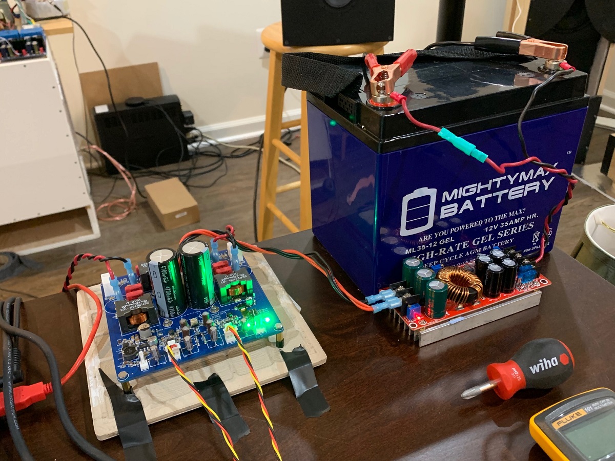

The battery option is less expensive than the 800w 48v Connexelectronic ($150 w/ shipping). $70 for 35Ahr Gelcell and $15 for DC-DC step up, and $15 1A automatic trickle charger - which as far as I can see, adds no noise if left connected full time. You will have a very powerful portable amp with this option and not deal with any 120vac mains. If left connected with the trickle charger in place, and you never run the amp more than 5 hrs continuously at 120wrms, you should be fine with it acting as if it was a "wall mains powered" amp.
