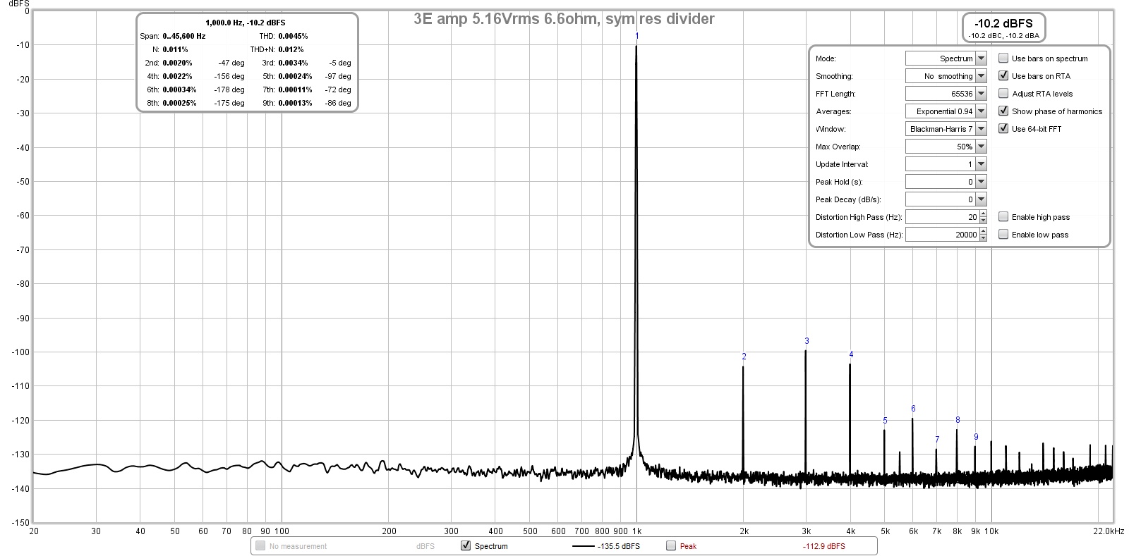

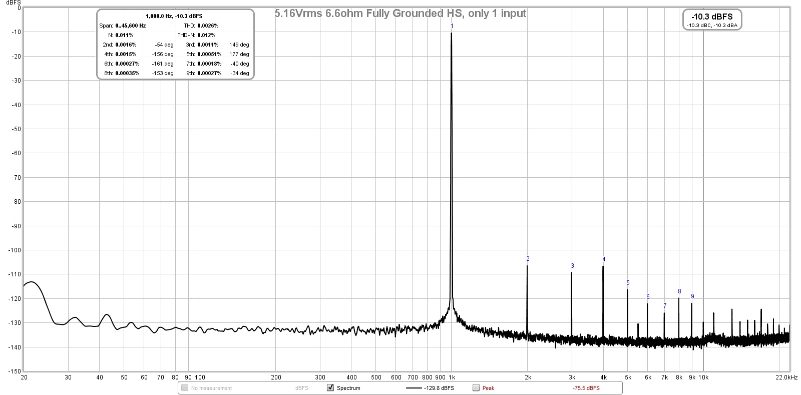

Here is the FFT for 5.16Vrms into 6.6ohms, the THD went down from the previous measurement, but still higher than the present amp designed in this thread (0.0046% THD), also note that the harmonic distortion is 3rd order dominant:

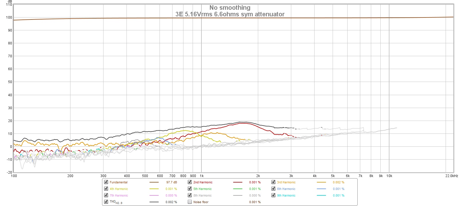

Here are the harmonic distortion components as a function of frequency, the overall behavior is very similar to the present amp from this thread:

Thanks! The setup is the same except for the 3E, I used a big 100W 8ohm resistor dummy load for high power testing, and I had an asymmetric voltage divider. For the above tests, I used the symmetric voltage divider as suggested by Voltwide, and through my own experimentation, I found that qnty 8x 2w 1% metal thin film resistors in series/parallel provides a nice low-distortion 6.6ohm load. In general, I have found that metal thin film resistors used for dummy loads, add less harmonic distortion than wirewounds. So I repeated the measurements with the same exact rig and same setting of 5.14Vrms (4W into 6.6ohms) on the 3E amp as I was already looking at the quiescennt current.

Dr Mord,
I just looked carefully at the plot:
So it looks like if one could not have a heatsink, it is lower distortion? Is that why you say to make one bolt non-conductive to prevent a current loop through the heatsink path? We can do that on the final spin, but to test it, I could drill out the hole and add a nylon shoulder washer - same as used on a TO-220 local heatsink bolt.
Not directly, but it shows that you can have increased THD just by bad grounding and/or layout regarding ground loops, signal loops, ground planes etc.
These issues where fixed at a later layout.
All those tests I mentioned can be a base for further discussion as Voltwide and me did really extensive measurements and tests regarding almost every aspect with these chips.

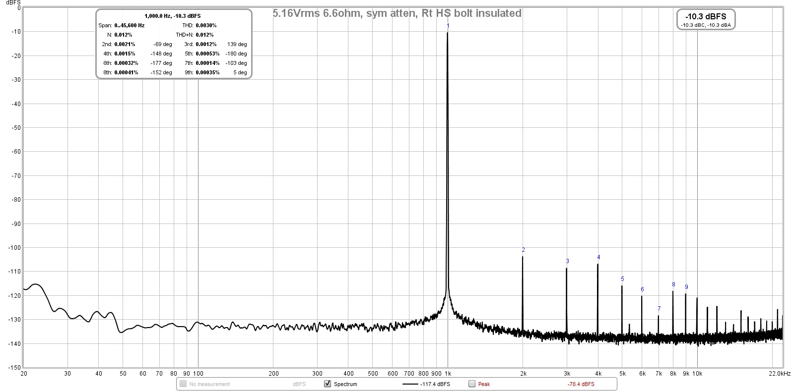

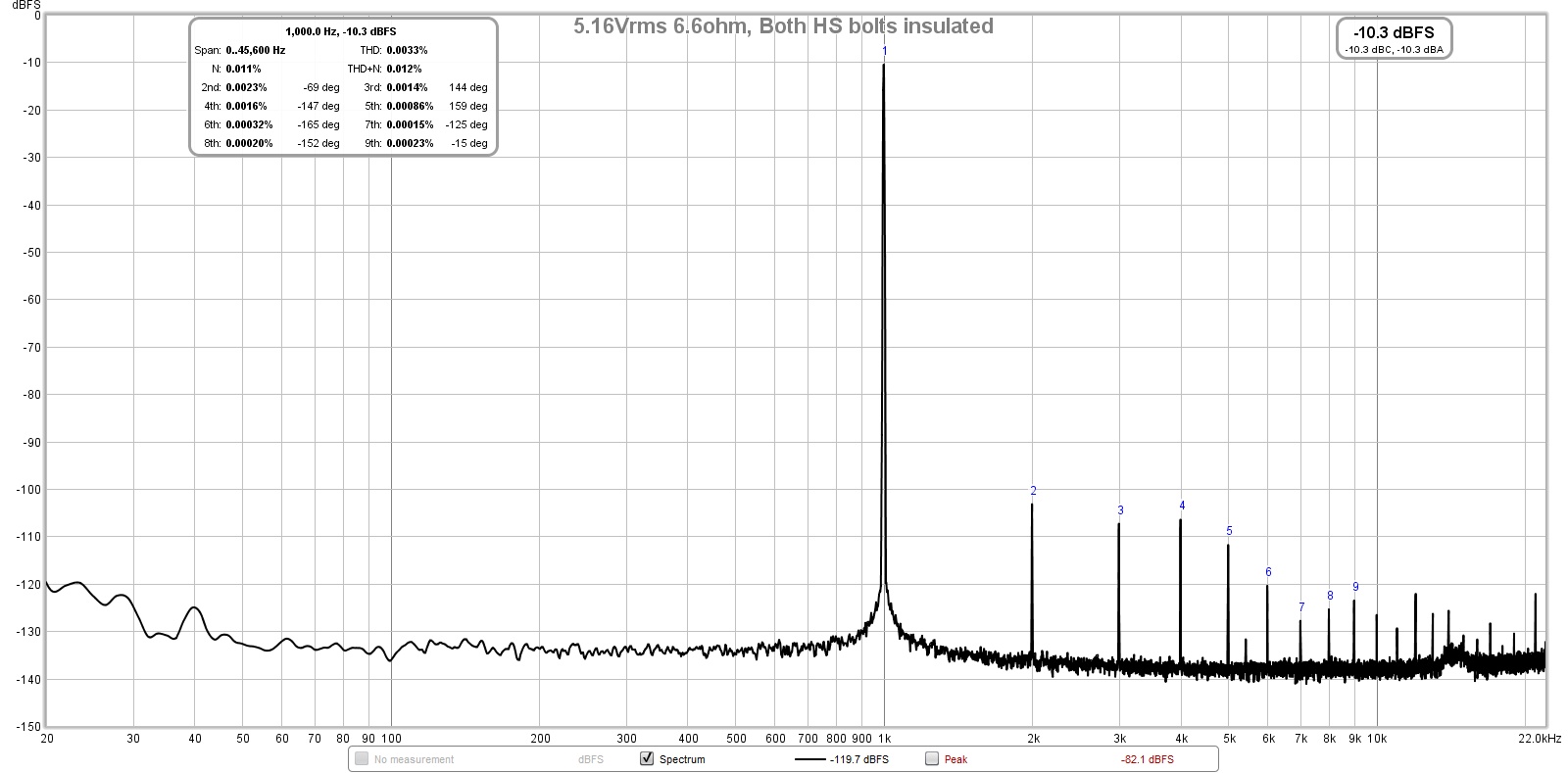

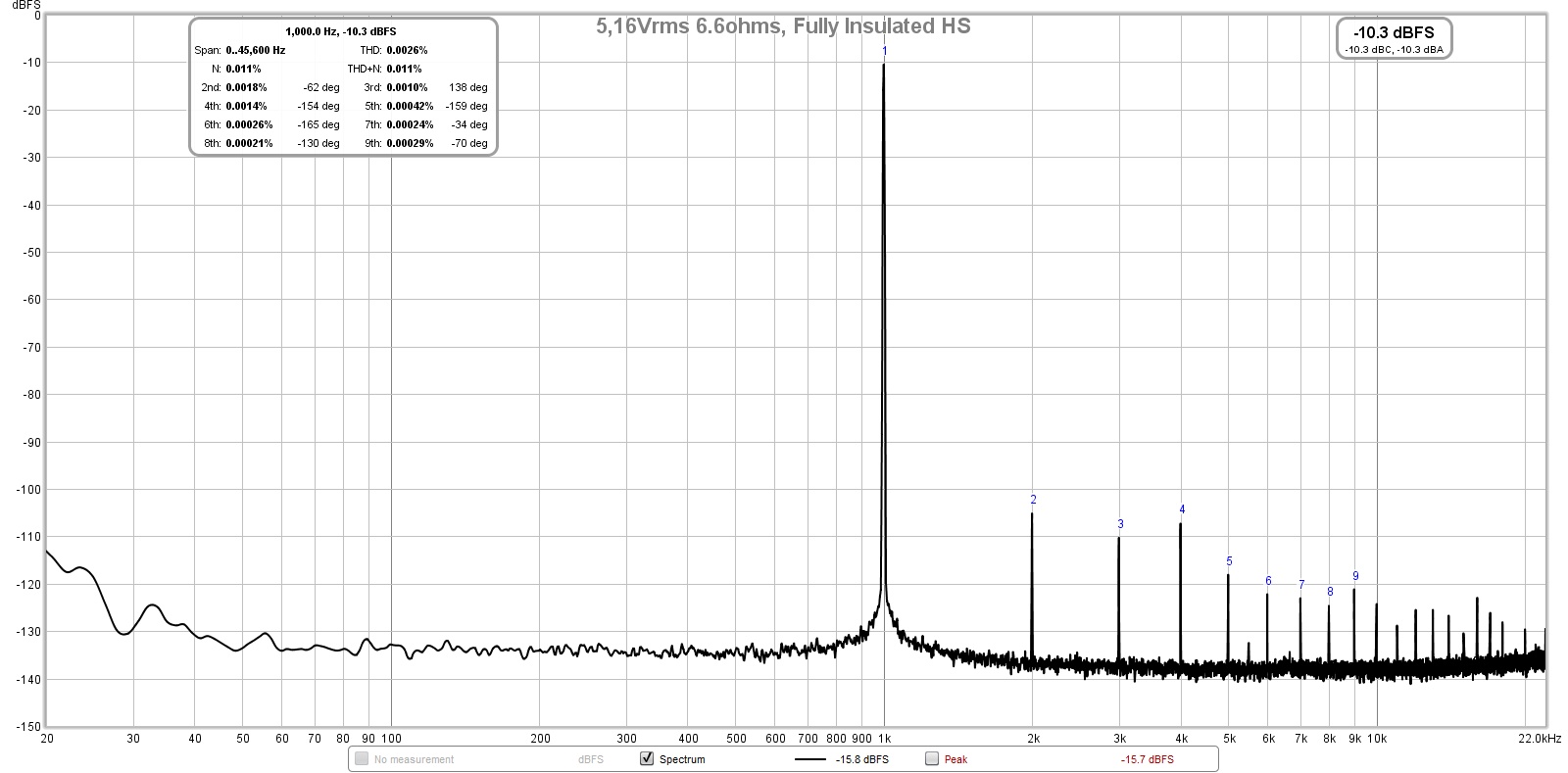

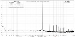

I tested the effect of grounded vs non-grounded heatsink and effect of one or both bolts insulated.

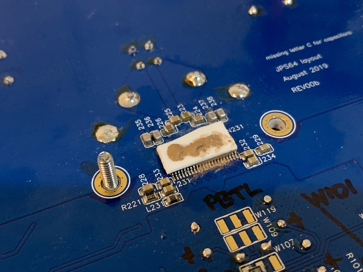

Here is photo of a ceramic inuslator spacer being installed on the TPA3255:
Here is heatsink fully grounded at the TPA3255 powerpad and at the two clamp bolts:

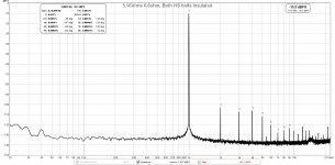

Here is one of the bolts insulated:
Here is both bolts insulated and powerpad insulated with a ceramic spacer:
So it seems that either fully insulated or fully grounded is the same, but partial insulated bolts has higher distortion. I will run with fully grounded config (default).

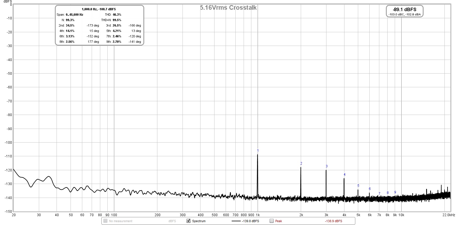

Here is crosstalk from one channel (excited) to the other (not excited):

TPA3255-3E-amp-5.16Vrms-6.6ohms-BTL-FFT-HS-Fully-Grounded-6.jpg202.4 KB · Views: 982
TPA3255-3E-amp-5.16Vrms-6.6ohms-BTL-FFT-HS-Grounded-Rt-bolt-Insulated-Symm-Atten-5.jpg203.6 KB · Views: 991
TPA3255-3E-amp-5.16Vrms-6.6ohms-BTL-FFT-HS-Grounded-Both-bolt-Insulated-Symm-Atten-5.jpg201.3 KB · Views: 78

TPA3255-3E-amp-5.16Vrms-6.6ohms-BTL-FFT-HS-Fully-Insulated-6-Crosstalk.jpg193.4 KB · Views: 1,049

Is this crosstalk at 4W?
Yes

Hi Voltwide,
What levels of crosstalk are you getting on your best implementation? Also, are my quiescent currents ok?
In my experience, -99dB crosstalk is quite respectable for a stereo monolithic chip. By the very nature of the output devices being mounted on the same die makes it very had to be as good as dual monoblocks. Dual PBTL is the way to go for zero crosstalk.
