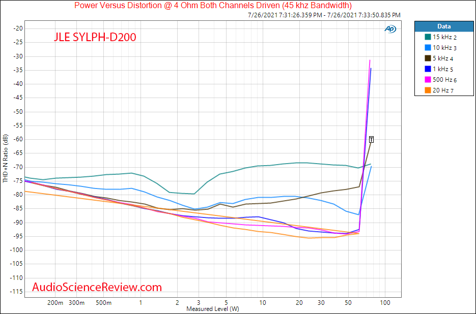

  • JLE SYLPH-D200 power vs frequency vs distortion into 4 ohm Measurements TPA3255 STEREO amplifi...png
"I am happy to recommend the JLE Sylph-D200 amplifier module" of the panther.

I am pretty surprised about the power @ 8 ohms / 35W for both channels.
It remains light but sufficient for listening in a non-oversized room
So you can compare :
The A07 TPA3255 @48V / 3A will provide you 61W / 8R
VS @32V / 5A = 48W / 8R

Hi Daniel,
We identified that the early clipping was due to overloading of the input of PFFB.
Since your amp has unity gain buffers, it should get the appropriate power output. You can check by measuring voltage before clipping light indicator lights up.
Lester
