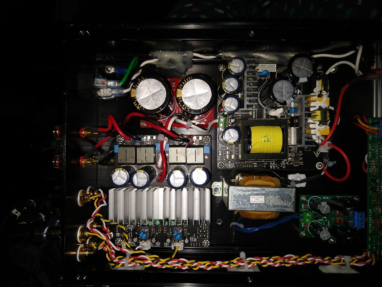

I'm also using the same power supply SMPS300RS, got the 38V DC output type, but I decided to use 36V so I removed the adjustment pot and placed SMT resistors underneath. (I think the included pot will degrade over time and will mess up the output voltage if I adjust it since it is an open-type pot and was submerged in an insulating varnish).
I also upgraded the caps, the resistor across the output is to bleed the voltage faster on power-off.

What's the value of that resistor (?K, ?W).
1.8K, 3W.
As a rule of thumb I divide the power rating of the resistor by 4 to get the power dissipation that will not cause the resistor to produce too much heat, specially when chassis ambient temp is high.
Since only 3W resistor can fit between the leads, 3W/4 = 0.75W dissipation is allowed. Then use ohms law to get the desired resistance, and get the nearest value resistor.
If you want faster bleeding, use higher wattage resistor and lower resistance. It's a balancing act, of course you don't want excessive power dissipation and current draw, 1W additional idle power draw I think is too much for a class-D setup lol.

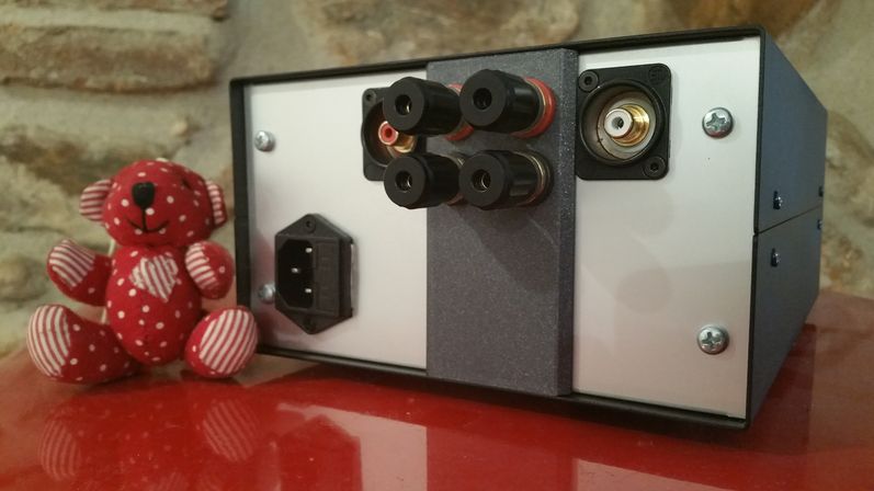

Okay, hi everyone, I'm coming back for a little feedback. For now, I have made a small test prototype, while waiting for the availability of the 2 other power supplies necessary for my project :
The choice of RCA inputs is voluntary, as it is easily interchangeable with XLR terminals.

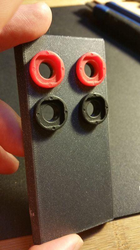

Also, As you can see I printed a small offset for the speaker terminals. This is due to the shape of the base of the terminal blocks in question, see for yourself:

- 3e Audio EAUMT-0260-2-B
- Connexelectronic SMPS 300W 36V
- EMI/RFI filter KTEMC 115/230V 3A
- Housing : HIFI 2000 ECO EP1001825
- RCA : Neutrik
- Speaker terminals : EIZZ EZ-301
- Electric cables lying around...
EDIT : And I forgot, this is my first DIY assembly in audio electronics. It was quite simple and certainly within the reach of everyone!

Very clean and orderly! Nicely done.
I would have intertwined each input’s +&- wires more tightly and not had them cross over the amp on way to their board’s connections. That’s just me. I figure you probably used the wire leads provided with the amp rather than making new ones. The 3e audio class D boards are competent little units.
Cheers
Indeed, I used those provided by 3e Audio. So I hesitated anyway, but ultimately more from fear than harm. No audible interference. Besides, it was supposed to be a test prototype. But, when I hear what I'm hearing right now I tell myself it's really not bad at all.

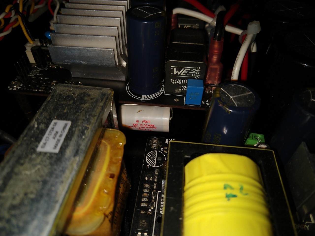

FYI, I attached Mundorf MKP 3.3uF caps across each of the leads of the four big caps on the 3e board (amongst other upgrades) and I thought it gave an improvement in the upper frequency responses and provided a bit more depth to the music. The downside to this was that I had to put 20,000uF caps in between the SMPS and the amp in order suppress the clipping indicator from going off when I drove the amp to louder levels.

turion64 said:
except restaurants can’t find enough servers
yes, same here !
By "upper frequency" do you mean beyond 3kHz? For my part, on the small Qa3010, the treble seems to me frankly very well treated. The cymbals for example - on the album "Blue Maqams" (Anouar Brahem, 2017) - sound very natural with a very accurate reproduction of the movement of air around them. The Oud is also perfectly transcribed. On these speakers only the double bass seems to lack weight; a bit normal in view of the small 10cm mid-bass speaker.
