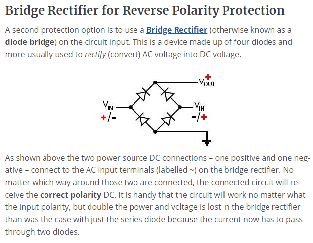

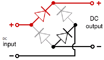

Just get a buck converter for the volume module, and adjust the buck converter's output to 10VDC. You can connect it in any orientation since the volume module has a bridge rectifier on it.

Your LITE MV06 volume module includes a rectifier/regulator circuit, which is intended to convert AC voltage - typically from a power transformer - to DC voltage.for the power supply of the Lite MV06 volume control module (not yet received), it is requested from 9-12V AC.
So I suggest you simply provide an AC transformer, but not that bulky and expensive toroidal transformer you mentioned.

I can see 7805 dropout regulator which means that LITE MV06 volume module is using 5V rails. So you can use DC as well for the volume module's power supply. The bridge rectifier will drop some voltage (Usually 1.4V), and dropout voltage of 7805 is around 2V so if you will feed DC on the AC input, you need at least 7VDC after the rectifier. (Assuming that the DC supply has no voltage drop on loaded output)
Do not feed DC on modules with AC inputs that have voltage doubler, or voltage multiplier on them.
Advantages of using AC input for your LITE MV06 module are fast ramp-down of voltage on power-off (because some users might input DC with large bulk caps), and absence of spurious high frequency noise from switching supplies. The rectifier will also act as reverse polarity protection if anyone feeds DC on it.
Otherwise linuxfan is correct in recommending a transformer since this is what the designer has intended to use on the module.
