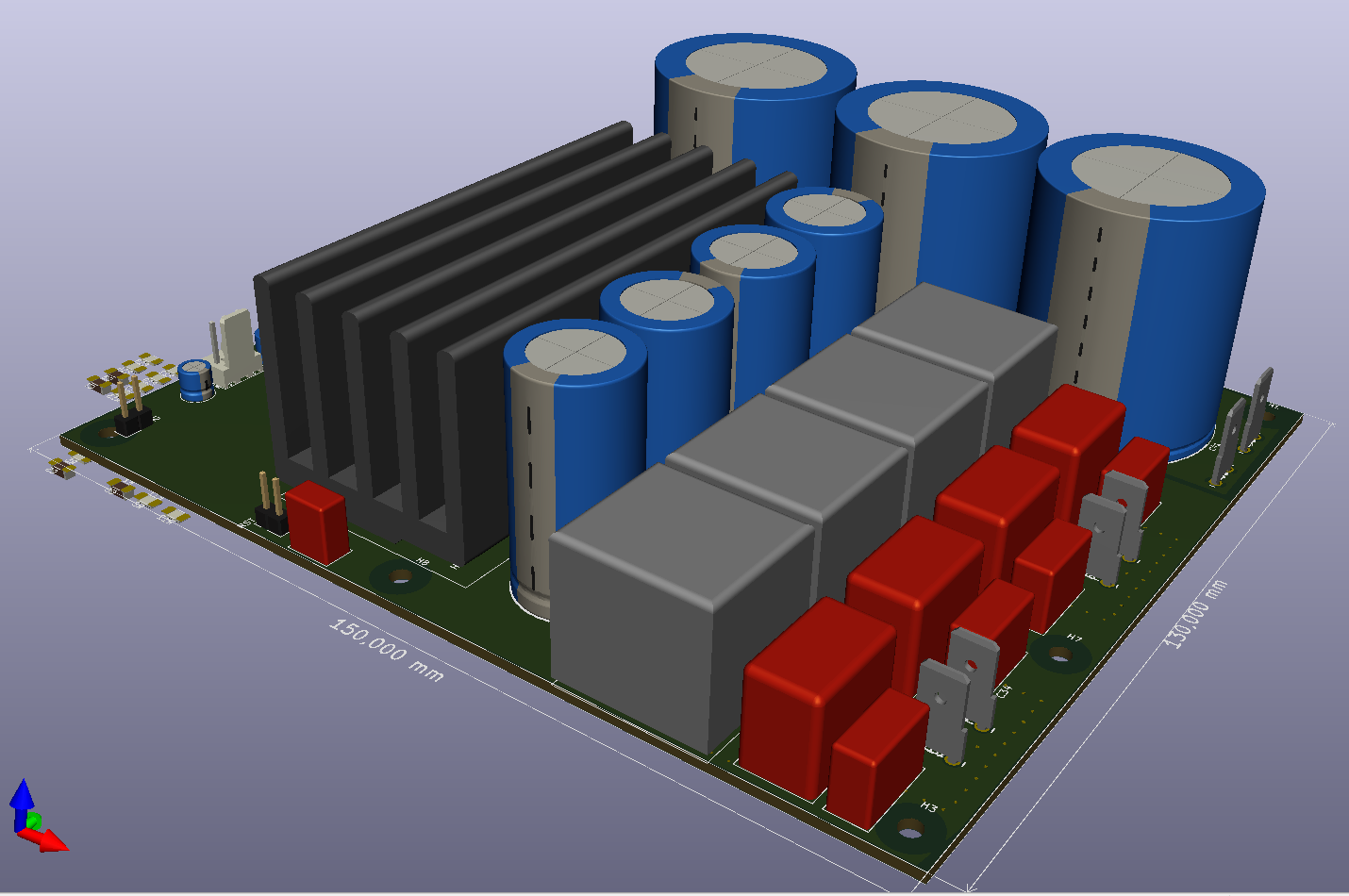

Just started a layout, in order to practice with Kicad and shake off my Eagle habits. Bog standard stereo BTL, mostly inspired by the TI EVM. Just adding most of a linear PS onboard, as well as a proper instrumentation amp style input.
I'll post the kicad files once I'm done. That might take a while though :eek:
  • tpa3255-schem.pdf
