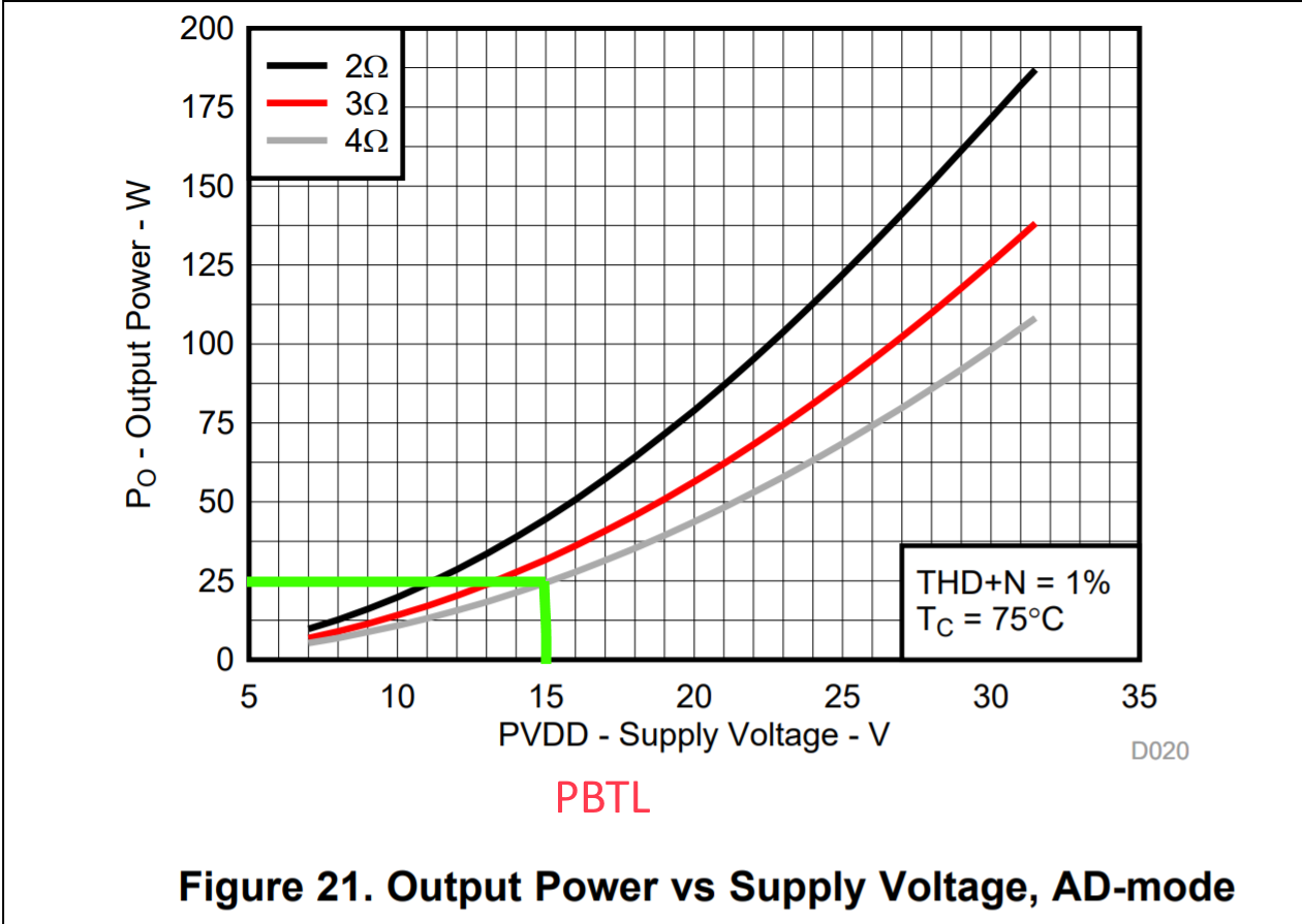

I wonder about the 15V though.
Assuming they did dual mono to use each chip in PBTL-mode, 15V is just 25W in 4Ohms (1%THD) and probably half that into 8Ohms.
The main caps are 35V so they might have planned for ~30V initially!?
Either they tested very conservatively with sinewaves and found the heatsink hot enough at 15V supply voltage or they had other problems with the amp at higher voltages (oscillation or simply that the 5V regulator gets too hot).

Keep in mind that this is a double MONO version so it is much more than 25W / 4R.
I did not measure but with the stock 15V / 7A I drive my high ends floor speakers without difficulty for a more than comfortable listening in a room of 30m2. My speakers are about 100RMS / 8R, 2.5 way with ribbon tweeters.
In my humble opinion we must be close to 60W / 8R when I compare VS my Hypex NC252MP ( 2X150W / 8R) : which is more than sufficient in many situations

60 watts into 8 ohms is 22 volts RMS.In my humble opinion we must be close to 60W / 8R when I compare VS my Hypex NC252MP ( 2X150W / 8R) : which is more than sufficient in many situations
Do not make me laugh.

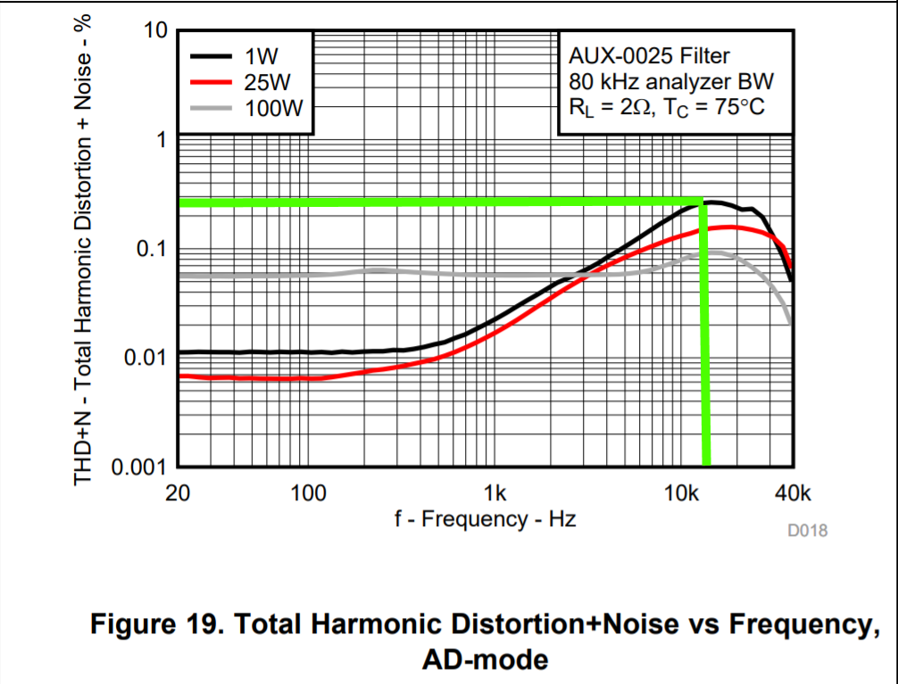

When powered by 15 volts in PBTL mode, the maximum power is 25 watts. At 4 ohms load.
With the sensitivity of your "super floor speakers" below 87 dB. one can only dream of high fidelity of sound ... With the distortions that these amplifiers have. It's funny.
First read the datasheet, then write nonsense about 60 watts on the forum ...
This is for a 4 ohm load. For 8 ohms it will be even worse. Possibly only 12.5 watts. I don't even want to write about distortions ...

some **** with a power of 12 watts and distortions higher than 0.2% for a price twice as much as my amplifier ... They made fun again ...

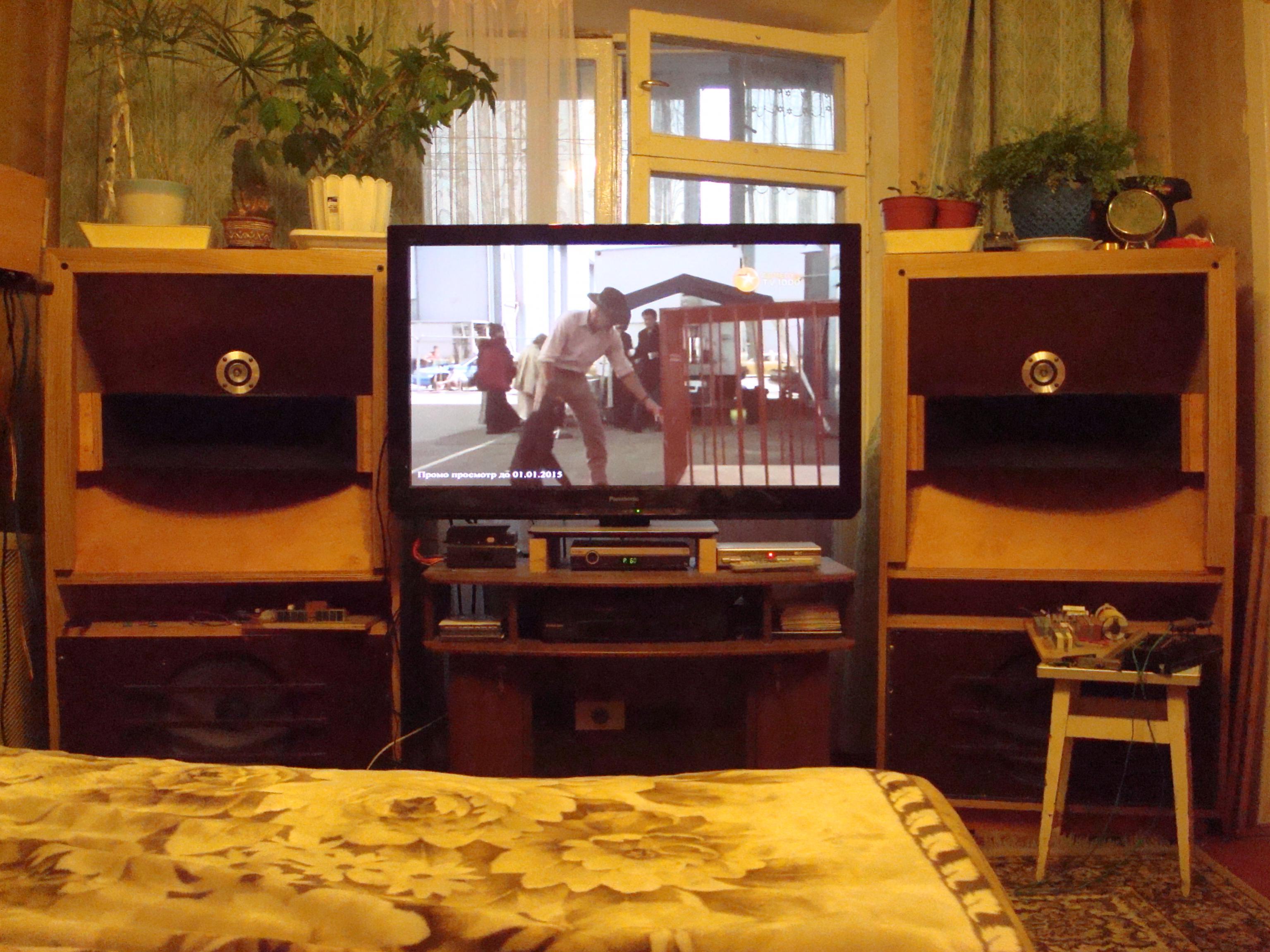

Your speakers are not "high fidelity" - by definition.My speakers are about 100RMS / 8R, 2.5 way with ribbon tweeters.
Your room is not a "normal high fidelity listening room" ...
From the word "ALL" ...
100RMS is not 100 volts RMS, otherwise your speakers would have a nominal power of 1250 watts ...
Far from it. Ordinary modern "birdhouses" (as I call them), which have nothing to do with good acoustic systems.
I meant 100W... you understood perfectly

What are the names of your speakers ???
Woofer brand and name ??? Frequency response can lay out your speakers?DIY speakers.
When can I wait for you to start correctly inserting images into your posts ???
Например так... Do-it-yourself speakers too ...
