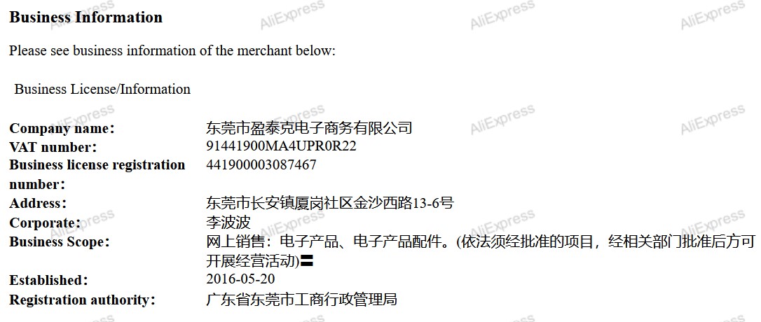

Does anyone have an email address for Weiliang Audio as I am unable to contact them through AliExpress.
Many thanks
I think they evaporated into thin air: WEILIANG AUDIO Store - Amazing prodcuts with exclusive discounts on AliExpress
