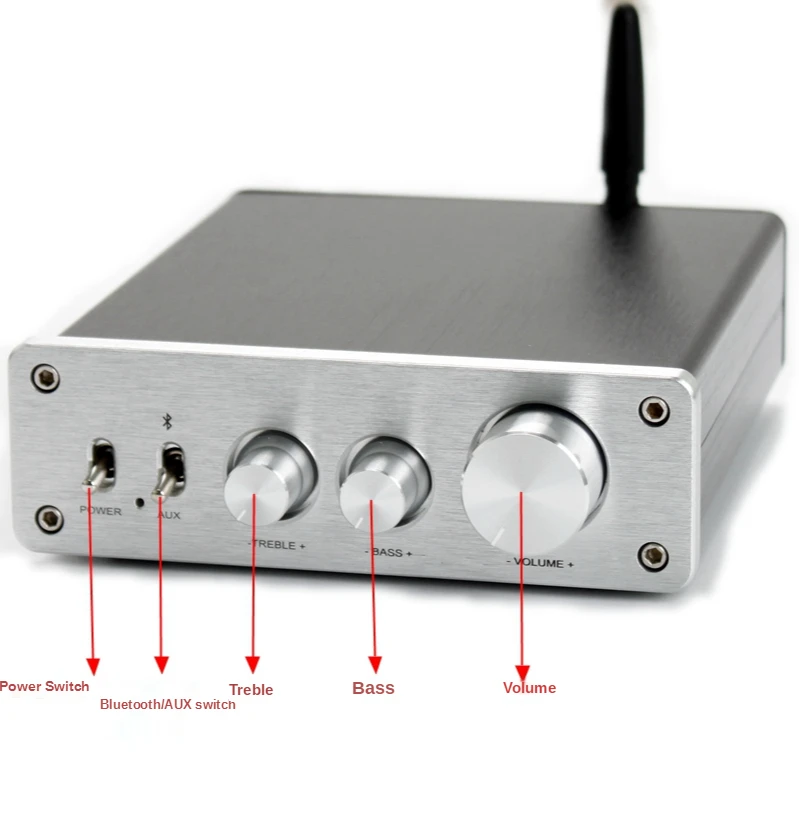

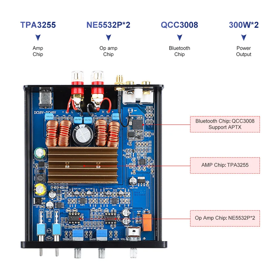

Has anybody had experience with this amp? It's a Bluetooth TPA3255 amp from Aiyima, but somewhat different from all the BT amps I've seen mentioned here. Notice it has a BT/aux toggle, but uses external power supply.

I have purchased two of these products and are currently using them.
The price is cheap, but the manufacturing quality is very good.
The sound quality is as good as AIYIMA A07 & A04.
There is no pop noise when the power is turned on / off.
White noise when there is no sound is a level that cannot be confirmed unless the ear is attached to the speaker unit.
It is convenient to have a tone control for normal use.
There is only one point to worry about.
Every time the power is turned on, continuous noise with a high frequency of about 10 seconds is generated. (piee ...)
The noise level is very small and does not matter. After 10 seconds, the noise will stop and become quiet.
This symptom is not limited to this unit, but is common to amplifiers equipped with other BTs.
Thanks Toku. Very useful information.
I went on mouser to buy OPA1656 for Aiyima, there are 2 of them (OPA1656ID and OPA1656IDR), not sure which one to buy. Also does the chip fit directly on the dip-8 socket, or do I need an adapter?

The OP amplifier is the same. However, the structure of the package is different.
OPA1656IDR is a reel-shaped tape packaged with 2500 chips.
OPA1656ID is packaged in tape in units of 75 pieces.
When you place an order, we will cut and ship the required number from them.
