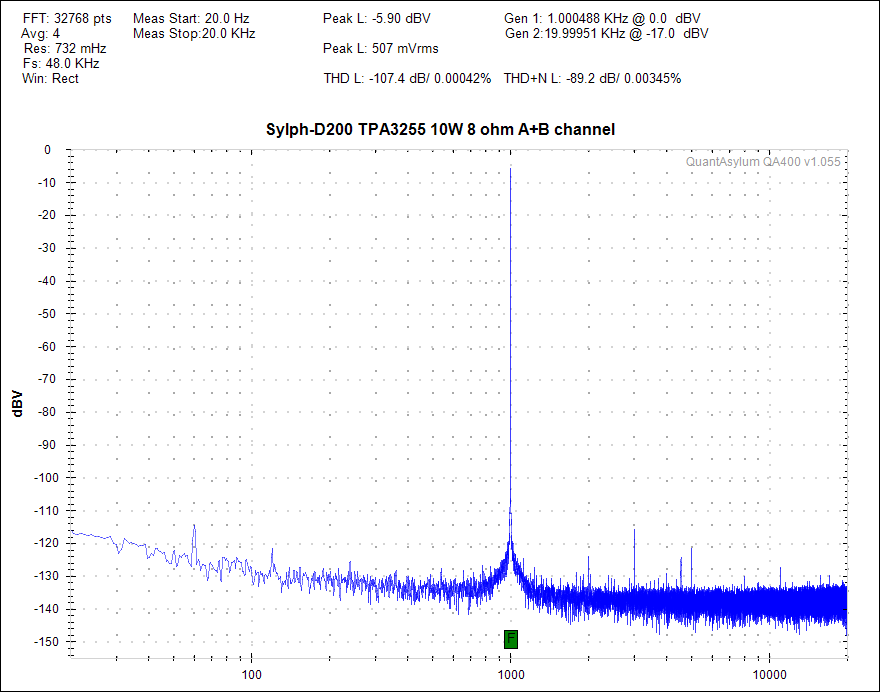

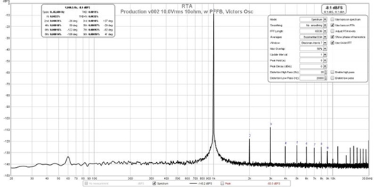

Measurements of three different TPA3255 amps... anyone care to comment on how to interpret the differences?
In particular the shape around the base of the test tone (sharp vs slower rise/leading edge) and the noise floor surrounding the test tone:
What effect would this have?

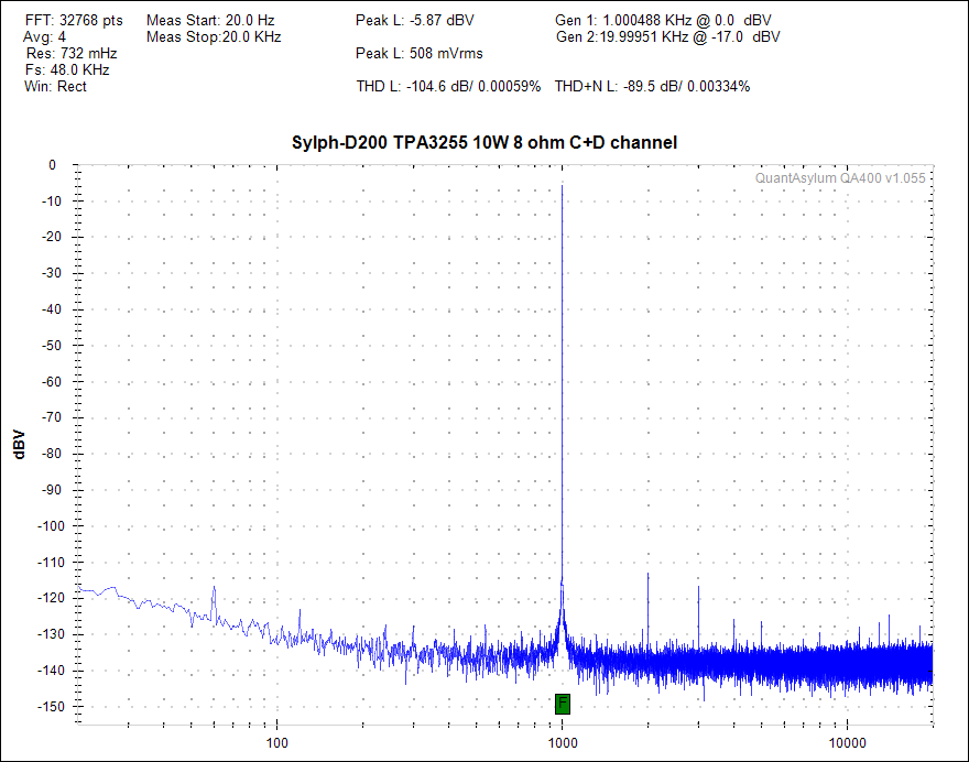

XRK and JLesters. I am thinking that the slower leading edge and fall of XRK's TPA3255 is simply there because the noise floor is lower? But if this would actually be audible?
You can ignore the shape since XRK is using a different FFT window function, and uses more averaging. Please check Amir's video on understanding FFT in audio measurements. Understanding FFT in Audio Measurements | Audio Science Review (ASR) Forum
Also you can't directly compare those graphs because they have different setups like output wattage and load resistance dBFS vs dBV etc..
Here's Sylph-D200 @10W 8 ohms. I'm currently creating a complete build so that I can send it for objective measurements (hopefully to Amir)
