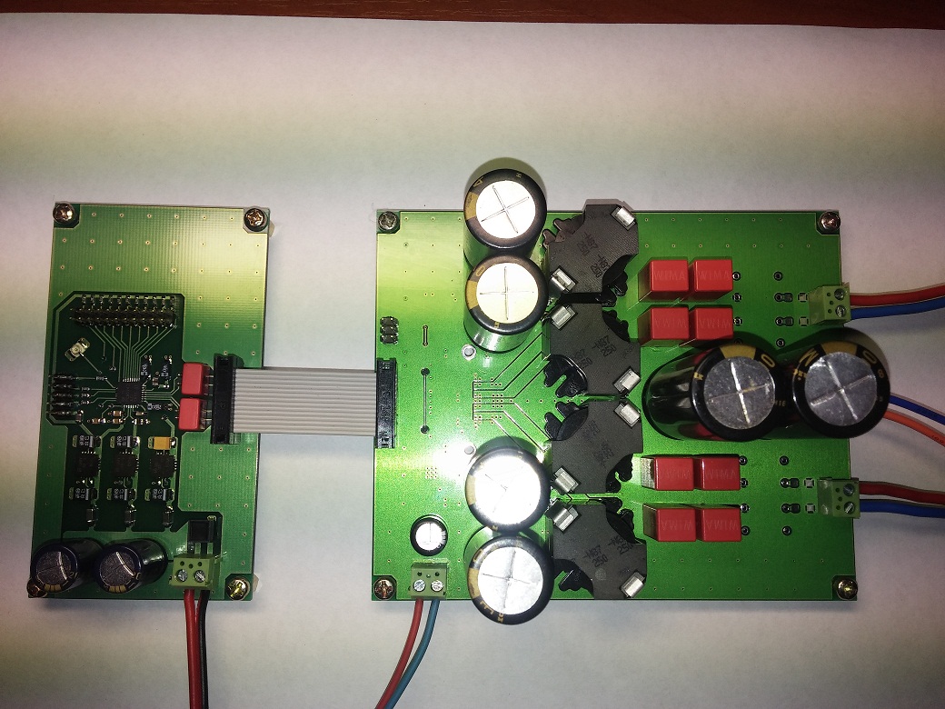

I think the combination of TPA325x and PCM5242 is an exercise in technical simplicity - to get digital sources to amplification with the minimum of devices and circuitry. The PCM5242 requires no I/V stage so its (differential) outputs can go straight to the unbuffered inputs of a TPA325x amp.TPA325x with DAC PCM5242
No opamps, no PFFB.
In fact this is virtually the same as TI's own equivalent product - the TAS3251, except that drMordor has possibly provided the PCM5242 with better clocks and better caps.
or tas3251 would have been a better choice, less digital to analog conversion.
the TAS3251 is good alternative if you are looking for a digital input.
