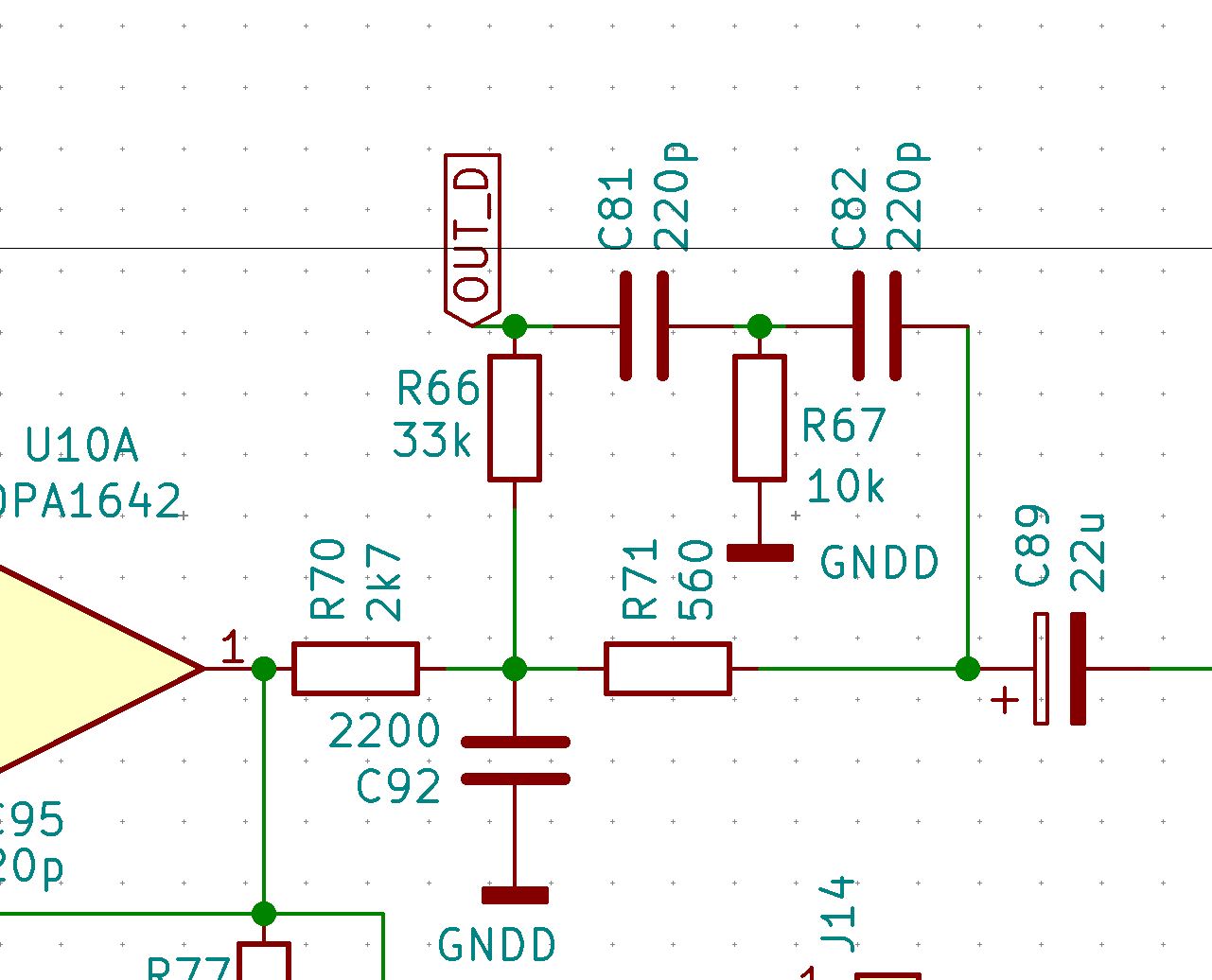

I use the improved PFFB, out of 46 amps sold, only the first person said he didn't like the sound. Maybe reason source?
Hi DrM...were these changes to PFFB made on the board I bought from you? Which components need to be altered if that’s not the case? The picture shows a opa1642 but you’ve been using 1656 now, correct?
Thanks, Pete

I changed the OPA and it's much better, but again, the middles are excellent, super clear but lack body.
Maybe it's a problem that we cannot understand or maybe my speakers are not so good for this amplifier.
