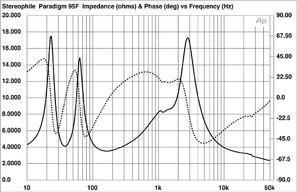

There is a lack of body and texture.
The bass is a bit tight.
For me, it's too bright.
I have Paradigm Prestige 95.

You are included in the percentage of population that doesn't like PFFB sound.
Too much negative feedback kills the full bodied midrange sound.
You can fix it by reducing negative feedback of PFFB. Ask dr. Mordor for R_fb and R_fb_ground values for reduced PFFB.
Problem with non-PFFB TPA3255 is that it has a harsh 'sss' and 'cchh' sounds.
So with PFFB config, we want to get the best sibilance / highs while maintaining the full bodied midrange sound. (This is what I'm doing these days)
If Dr. Mordor's amp uses SLAA788A values, This one also helps in improving the sound
Reduce R_op-fb (depending on opamp feedback resistor)
Set cutoff frequency to >= 450kHz

Paradigm Prestige 95F input impedance drops below 4 ohms at the upper range. The Class D output filter may need optimization: Paradigm Prestige 95F loudspeaker Measurements | Stereophile.com
TI TPA3255 Application note....LC Filter Design (Rev. A)
Fig.1 Paradigm Prestige 95F, electrical impedance (solid) and phase (dashed) (2 ohms/vertical div.).
Yes this might be also the case, please check if 3e audio's module and dr. Mordor's module have different output filter values. TPA3255's passive PFFB will slightly correct the frequency response to a certain extent.
