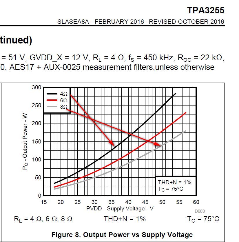

Is there a consensus on what voltage to feed these boards? I've seen reports that 48v causes them to run too hot so some are recommending 36v instead. Also some discussion depending on 4ohm vs 8ohm loads? Should I just get a good 48v LLC SMPS?
Also any considerations for running two boards off of the same power supply? I've been leaning towards the SMPS600RS.
If I had a 4 ohm speaker load, I would choose 36V. If the load was 8 ohm ohm, 48V may be a better choice.

Adding a small fan would be my recommendation.
A tiny 12v 60-80mm fan running at 5v will bring temperatures way down and be silent from any listening distance
The heatsink on the 3E board is actually quite nice (and well optimised for passive cooling), best to make the use of that IMO
Joined 2019
Is it difficult or even impossible to change the heatsink on the 3E board?
Got a 48V PSU on it's way, so I'm guessing it will have to be that or adding a fan.
When I ran my 3e amp with a 48V PS the heat sink got warm but not exceedingly so. It was the inductors that got really hot. I have 8 ohm speakers if that’s important to know. You couldn’t keep your fingers on the openings at the top for any good length of time.
