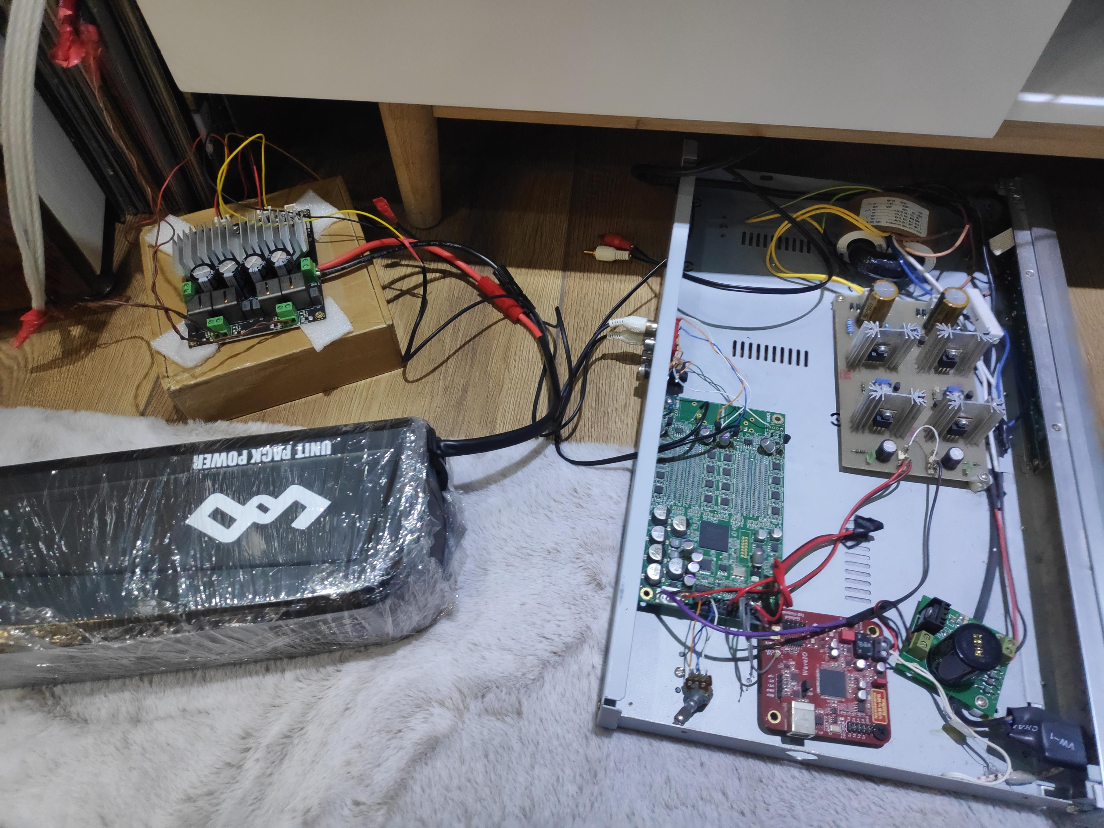

Hi amigos,
Just finished my new Shui Yuan Amplifier. Sounds very very well )
Some pictures so you can compare with my updated Aiyima A04
As per reminder, what I did :
Stock version
A small 110*70*35MM TPA3255 module with :
SAGAMI 7W14A inductors
Full Nichicon caps, as below :
Nichicon 2200UF/63V VZ serie power caps
Nichicon FW serie Buffer caps (Audio Grade)
DIP8 OP amps socket
My minor Updates :
For TPA3255 module : Remove 2X Nichicon VZ serie 2200UF/63V > Install 2X Nichicon 4700UF KW serie (low ESR Audio grade)
For LLC SMPS PSU : Remove Output Caps 2X Nichicon PM serie 50V/1800UF > Install 2X Nichicon 2200UF KW serie
OP amps : Remove NES5532 Op amps > Install OPA1656
Full Setup:
Updated TPA3255 Module with full Nichicon Audio Grade caps (110*70*35MM)
SMPS LLC 600W 48V PSU small factor Nichicon caps (113mm * 67mm * 56mm)
Aiyima A50 AC DC Filter (anti RMI/RFI) board
Full Copper twisted wires
Full Aluminium black case BRZHIFI (131*249*55mm.)
Premium Banana plugs
I still want to point out that I took enormous risks in assembling this amplifier. Indeed, the Nichicon KW caps and the PSU radiator have to fit within 1mm in the case) I was lucky. Keep in mind that the maximum size of installable caps is 20x40 for the module and if you want to update the film caps, the pitch is between 0.5 and 0.75mm per information.
I I highly recommend going for this case instead, which is slightly taller and longer :
Boitier DIY Preamplificateur DAC 100% Aluminium interrupteur 300x190x70mm Noir - Audiophonics
Concerning my first long listening (I will come back to this point later ...) At this price, this amp is a little bomb! We find the grain of the lovely TPA3255, no doubt about it! But what amazed me about in this model is that it goes very low in the bass, more than the other Chinese models that I have been able to test. I have the feeling that the made mods have something to do with it. I have also found the OPA1656 / Nichicon FW (25V 10UF) combo to pair well ! The mids are well detached when listening, everything is balanced and clean. The vocals are well highlighted on the front of the soundstage and the treble never aggressive, I really like what I hear)
The amplifier is really silent and has no POP on switching on and off.
I wouldn't want to say anything stupid ... but I really have the feeling that the added filter and the ferrite between the PSU and the module contain the interference caused by my BT connection; it is certainly not perfect but it is is very good ( I stream via BT Aptx HD).
I will share a video tonight )
