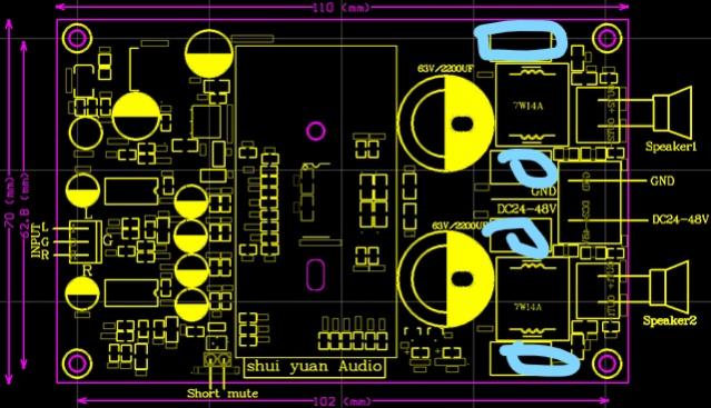

Actually, I also ordered this amp board a few days ago. However, I am worried that this type of amplifier board has insufficient measures against pop noise.

Dead silence, no pop ON / OFF, seems to be a very good module !

Can you tell me the footprint of the output cap?
Will order too
Stock power caps (Radial) : Nichicon VZ serie : 18 x 35.5mm
Update caps : Nichicon KW : 20X40mm (fit well but you can't go over diameter 20mm)
Buffer caps : Nichicon FW : 5x11mm
It goes without saying that the height of the caps will be conditioned by the size of the chosen case)
