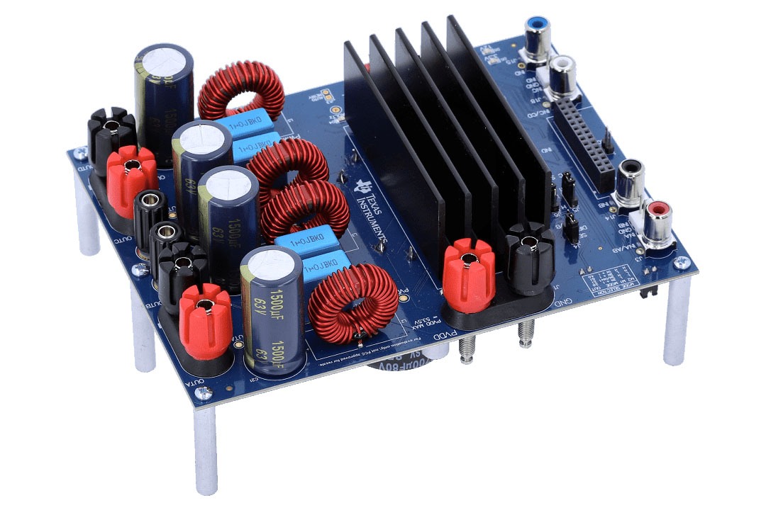

It is always not recommended to connect audio ground and chassis ground which may be connected to earth!
That's conventional wisdom for a portion of the audio community, but my own theory is that this notion of keeping AGD and earth separate on an amplifier is linked to the apprehension that some other device in a user's (unbalanced) audio chain may have its AGD connected to earth - and of course this will result in a ground loop. But the counterpoint to this argument is -
it's OK (even beneficial) to have AGD connected to earth in an unbalanced system, provided it's only done at one device in the chain.
It's my preference (encouraged by other members of this forum) to have this AGD-to-earth connection at the amplifier, all other devices in my chain to have floating GND.
So how does Texas Instruments feel about this matter? The TPA3255 evaluation module (which I purchased in 2018) comes supplied with 5x metal standoffs (image attached) for which TI obviously wants the end-user to mount to the chassis. And guess what - all 5 standoffs make contact with the circuit board's GND plane.
