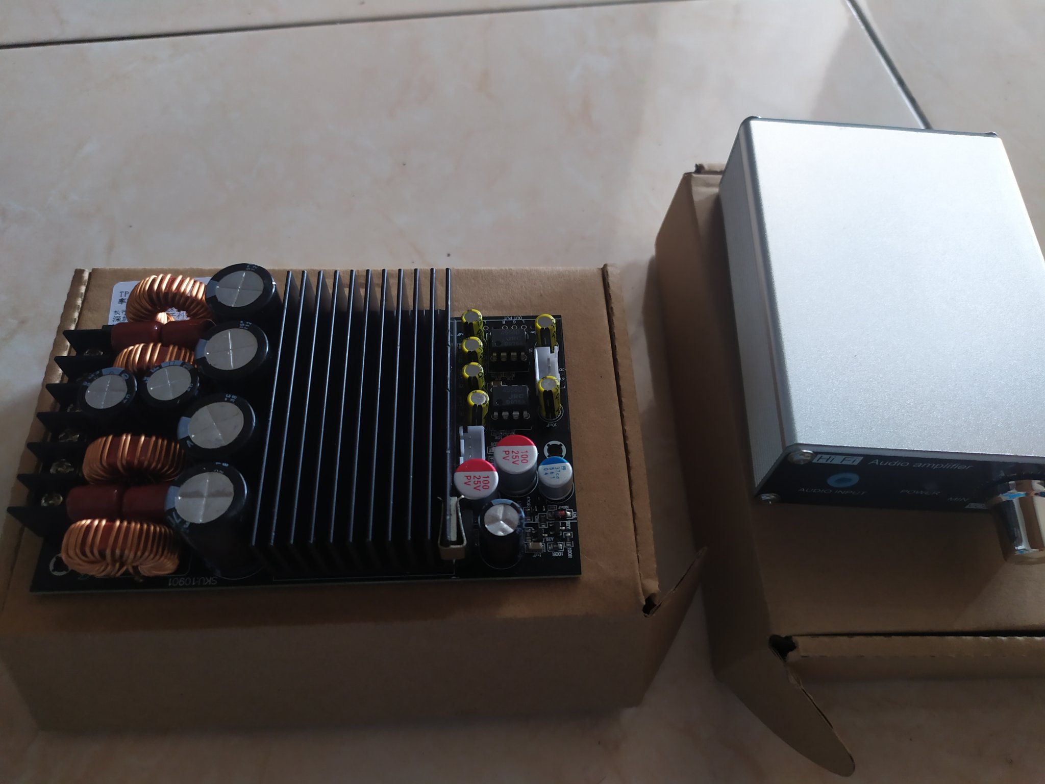

hii.. im test this TPA3255 board with 42V, but why the sound/volume still loud 2xTPA3116(with 24V)?? im test both with volume potentiometer at 50%..my board is coming.. i'll follow your mod 😆
the different is so far..
from datasheet TPA3255(with 42V) should be greater than TPA3116(with 24V)..
or i miss something??
The amp PSU voltage has nothing to do with the loudness, it sets max power output. Look at the intrinsic gain of the amps.
TPA3255 without PFFB mod is 22dB. TPA3116 standard gain varies between 20dB and 36dB depending on resistors set. If set to typical 20dB, they will have similar apparent loudness for same input level assuming clipping has not been reached on one of the amps first.

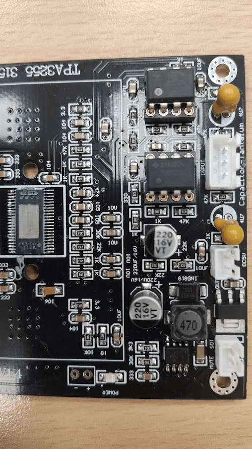

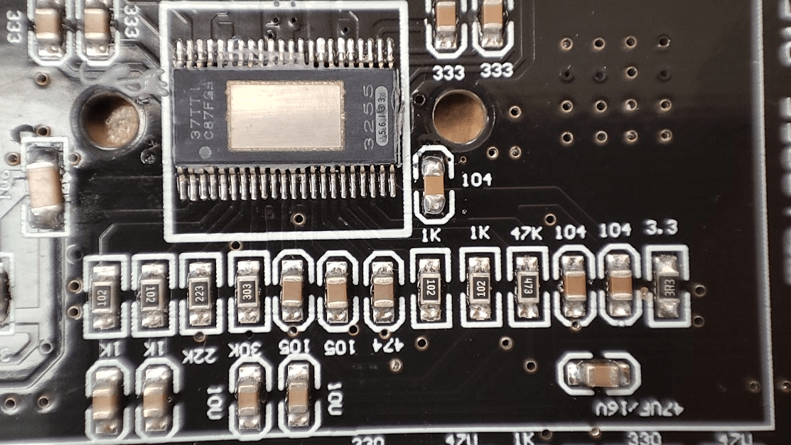

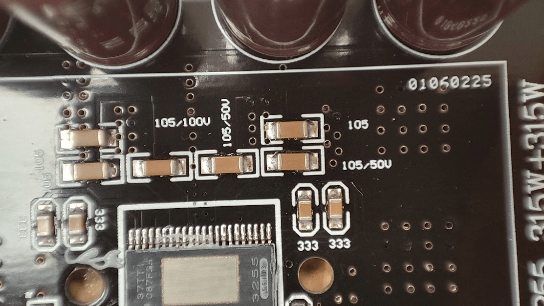

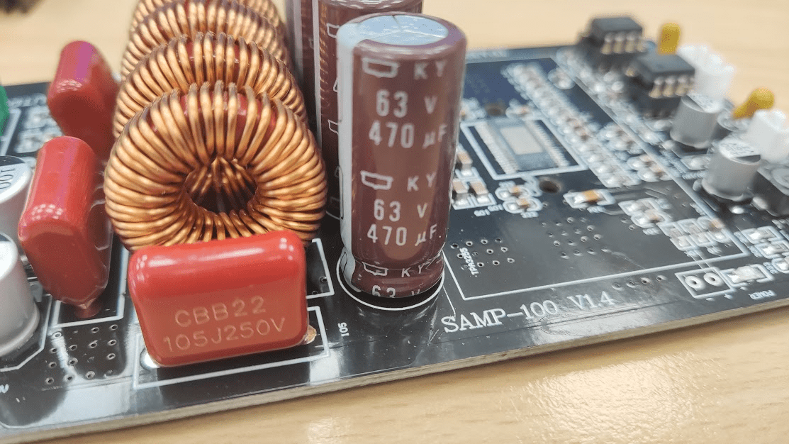

Hi
Recently purchased SAMP-100 V1.4.
It has no speaker bump on switch on, so some improvements are made.
The sound is amazing with Magnepan SMG-C SE.
I take some pictures to compare it with older versions.
Will do more hearing tests and get back with result.

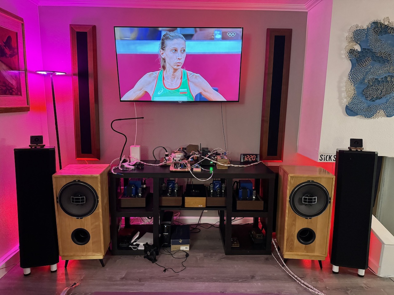

I have one of this board hooked up to 500W linear power system. This board sounds incredible given its price point. Go ahead and give it the best wires, connectors, opamps and PS, it is so transparent it will show each level of qualities bare right in front of you.Intresting dual 3255 board
