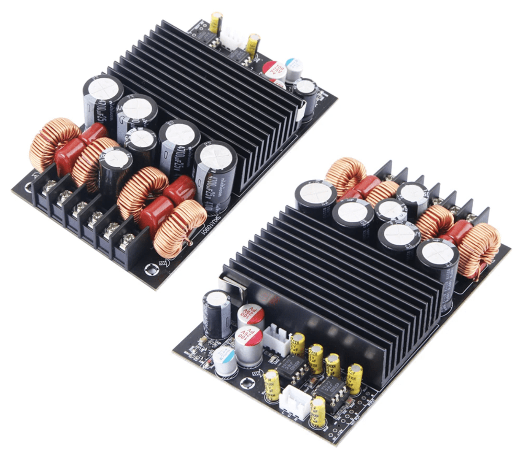

Four capacitors beside heatsink are series-connected 4700uF/25V.
So a total of 4350uF capacitance is embedded.
It's not a good idea from the point of view ESR. 😱

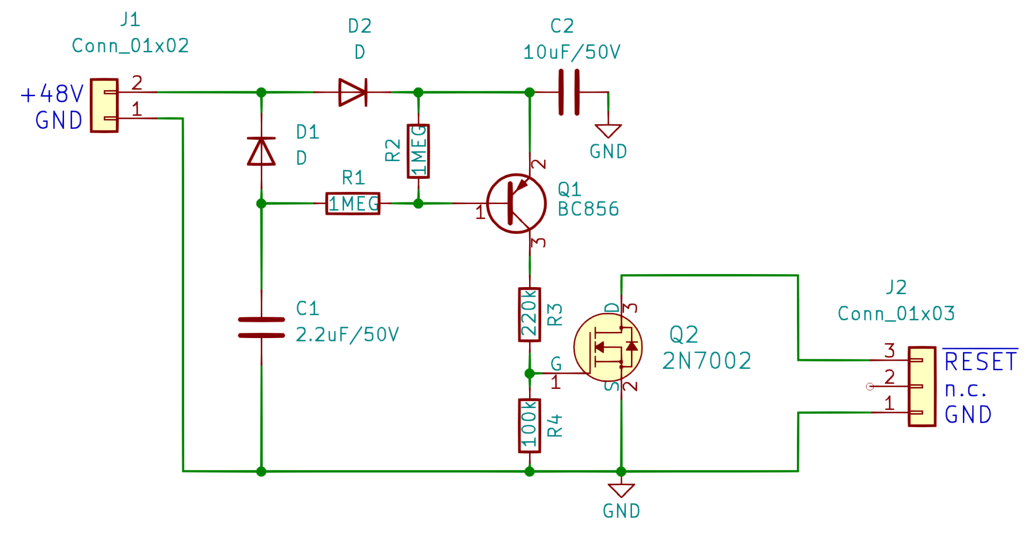

The speaker output makes a pop noise during Power-up and Power-down. So I developed an automatic reset control circuit.
This can eliminate pop sound without manual reset switch control operations. 😉
Hope this will help you easier.

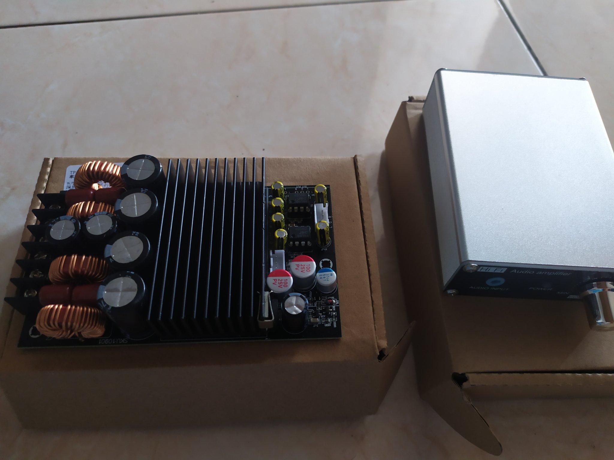

2 new 3255 bords

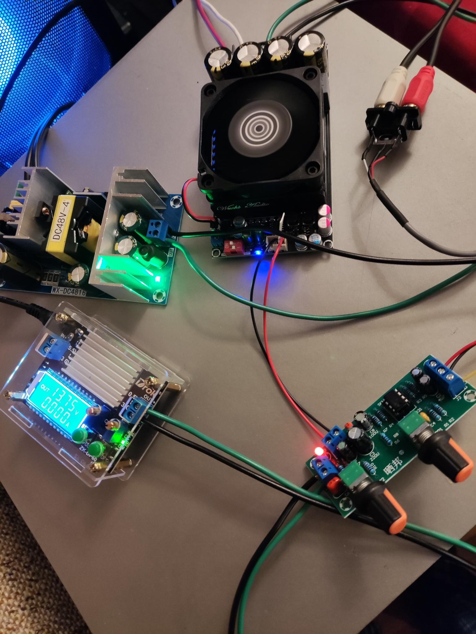

I purchased the ZK-3002 amp, it is the updated board, and am using with a Noyito 48v 4a (192w) rated 5a (240w) max (WX-DC4816). It's connected to a JBL Sub 145 (8" ported enclosure) in place of the failed 100w plate amp that i'm the process of repairing. In this example also have it connected to a low-pass subwoofer pre-am board that is being powered by a 12v DC power board. This is just a mockup test and does get very loud that my wife complains of the vibration so I have to turn the volume down to not disturb her.

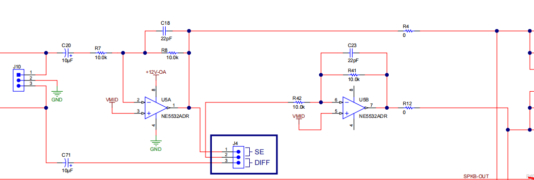

I saw it in the data book that the magnification(NE5532) of the device is 1。(R8/R7)×(R41/R42)=1.
So why do I need it? If there is no amplification, can I remove it?
I would appreciate it if you would kindly enlighten me.
