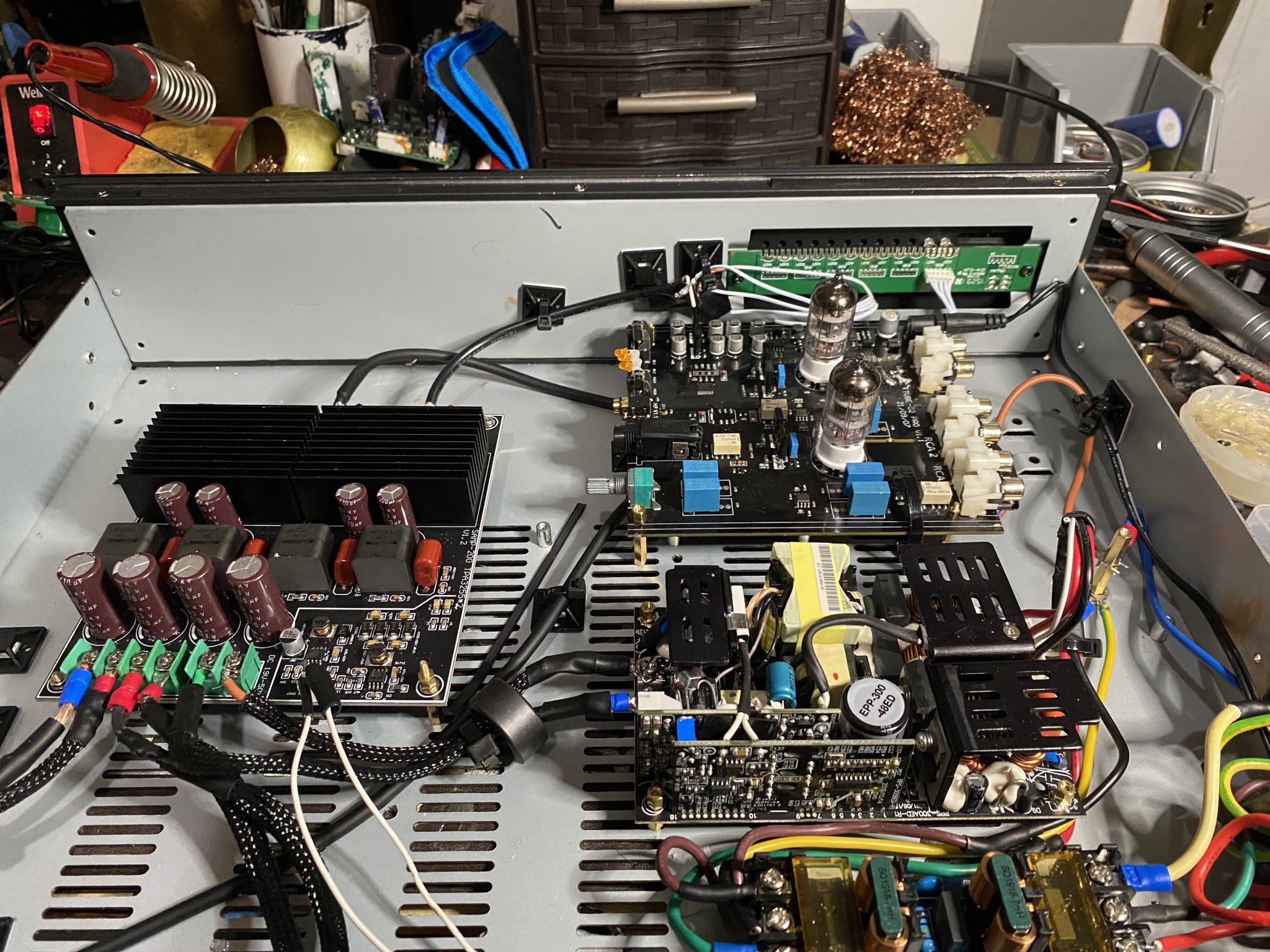

About finalized this build with Dual chip TPA3255, Integrated a tube preamp class A no OPamps in the pre. Im getting some noise in the tubes 2 sets, so not the tubes. All boards grounded to earth. I have ferrite magnets ac input, DC out to TPA. Im running the Tube preamps a FX AUdiotube 02 pro ive repurposed and powering it seprately via DC jack on external chassis and running anoth DC line to the preamp itself. Ive grounded the preamp output to chassis earth. ANy ideas?
🤣...Do not connect the signal ground to the chassis .
