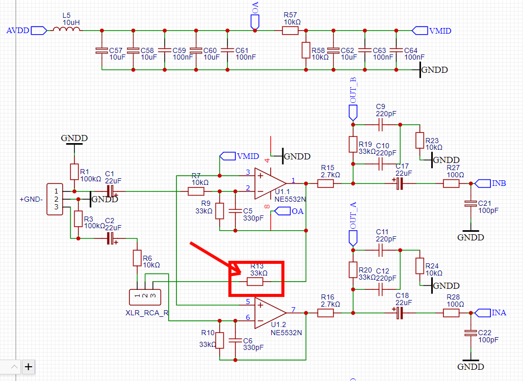

Hi! Please tell me, am I using the resistor value correctly? Or do I need to use 10kO to connect the SE?
Joined 2009
You don’t want to use a 150W class D for a headphone amp. There will be some residual Class D switching noise (beat frequency from 400kHz and other sources) you might hear, and in event of a pop from turn on/off or when accidentally hot plugging a jack, it will blow your headphones in an instant.
You want Class A and 1W or so for a headphone amp.

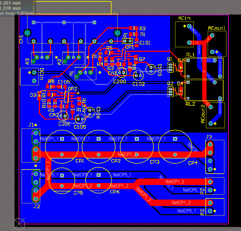

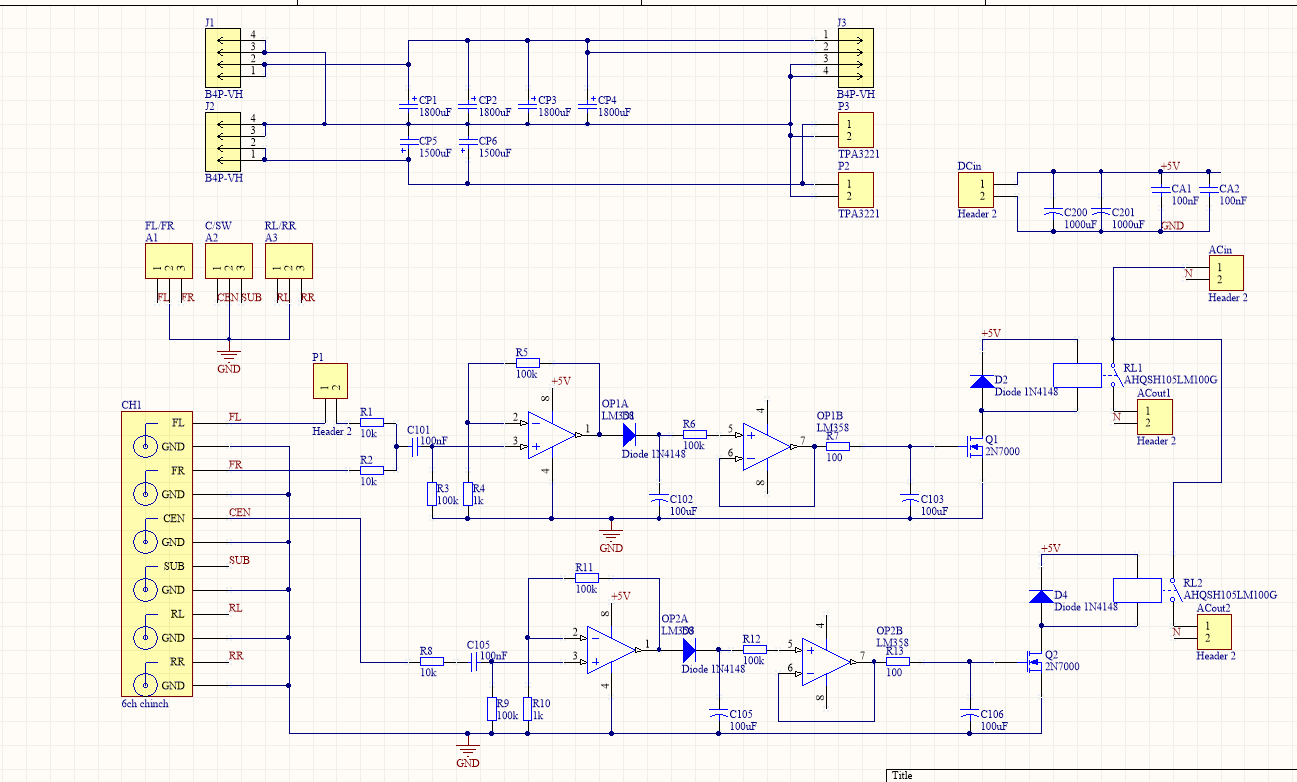

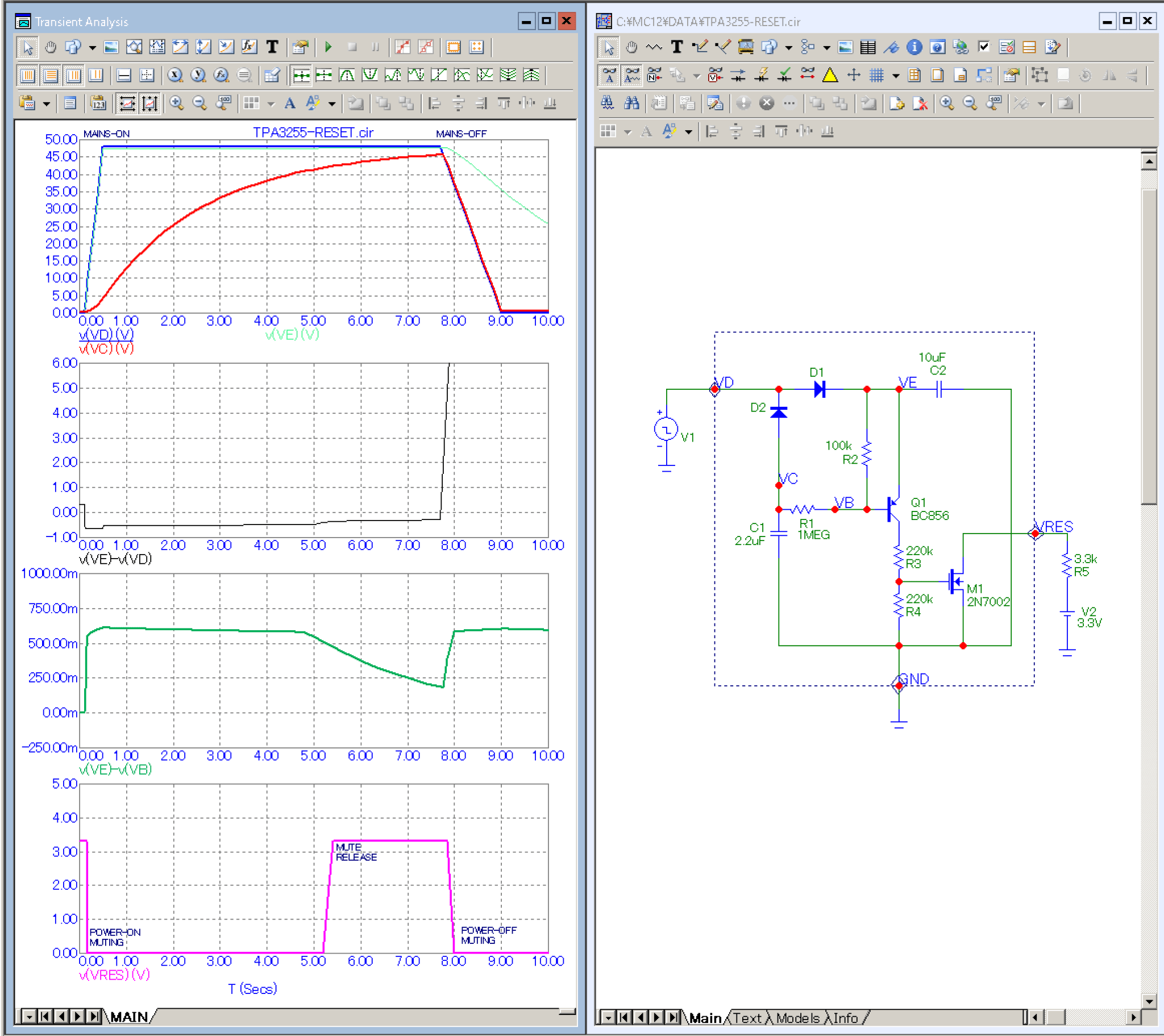

Hello dear friend, Im plannung multichannel amplifier with TPA3251 and TPA3221.
I found schematic for audio auto on off. I make 2 of them for only power up TPA3251 when stereo music is listeing and one couplet from center channel for secondary power supply.
LOF225-23B36R2 for 1x TPA3251
LOF120-20B27 for 2x TPA3221
Are the 230V part for the PSU okay? Does they not make problem with the rest of the PCB? What do you think about the routing?

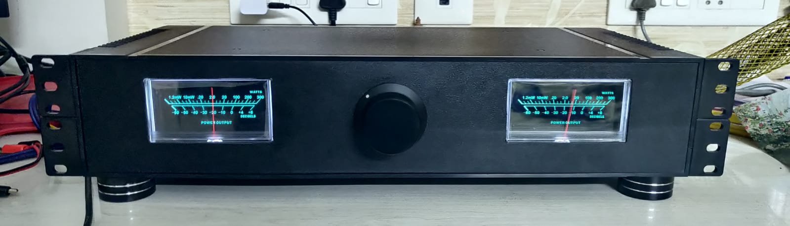

Finally i completed my build and this is how it looks like. The sound is decent. As of now i am running it off my test speakers. The pre-amp is a Nobsound E6. The amplifier makes a pop sound when i power it off. A bit scared due to this to connect them to my main speakers. Any suggestions on how to avoid getting the pop sound ?

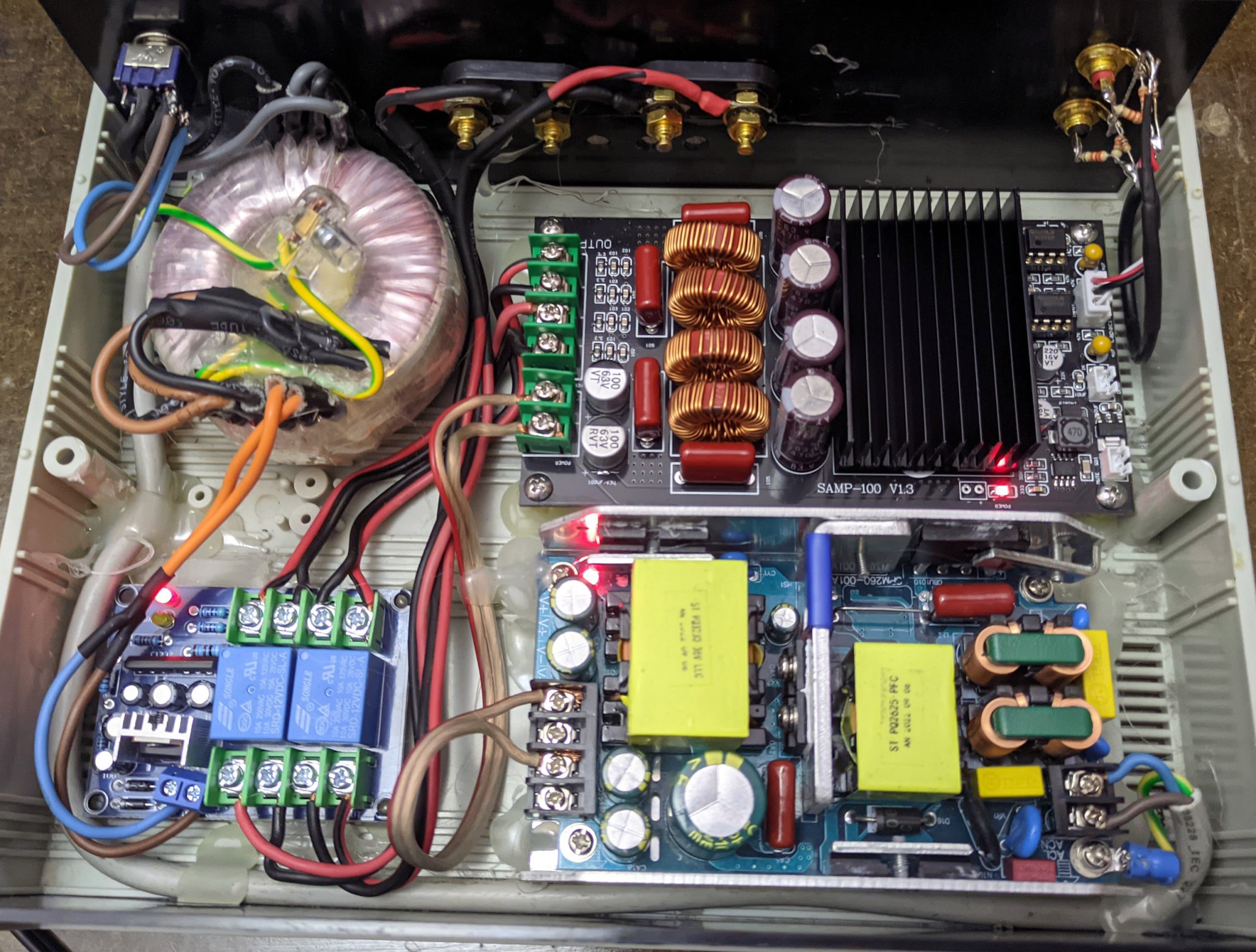

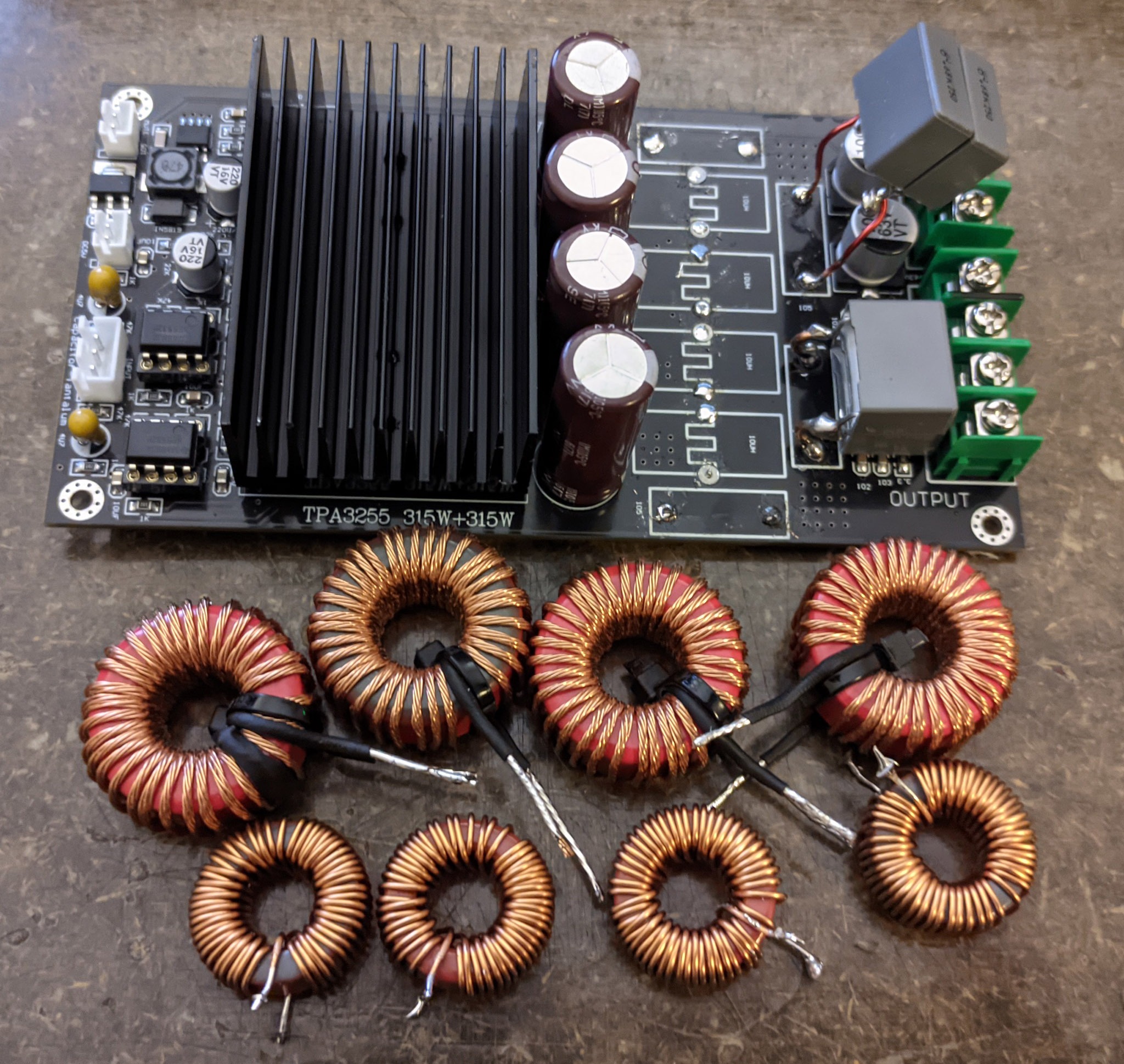

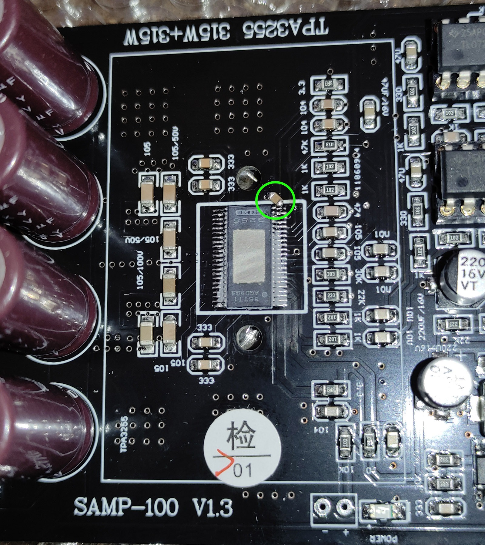

Hello Everyone.
About a month ago, I've bought a chinese TPA3255 board off Aliexpress (Link Here). Powered off a 36V smps PSU (LLC, active PFC). I'm having some issues with one of the channels (mostly the right one) triggering a latched OLP at medium volume. Speakers are 4 ohm, Indiana Line Tesi 261.
The board is mostly default TI's schematic, I've tried replacing a bodge capacitor that got added by the seller on pin 22 and also adding one on pin 1 to ground (gate drive decoupling) with no difference.
The output filter looks to be decently sized, with 12µH inductors and 1µF capacitors. I've also tried replacing the whole stage with larger inductors (suspecting saturation, as the cores are just 2cm in diameter and wired with 0.7mm enamelled) and better caps (2x0.68uF).
Any idea what could be causing this behavior? The last thing I can try is replacing the PSU with a non-switching one as I've got a suitable 24V 150VA toroidal.

Founder of XSA-Labs
Joined 2012
Check the quality of the thermal contact between the chip and the heatsink. Use solvent to clean and remove all the heatsink compound that has touched the pins. The compound has metal powder in it for thermal conductivity. This may be causing some electrical issues. Use a high quality thermal paste sparingly so it doesn’t touch the pins. Make sure heatsink has a mechanical mesa (riser pad) to prevent adjacent parts from touching heatsink.
Also, check that the maximum current setting resistor is the correct value. It looks like it might be correct - it’s the 22k value located near the corner of the front edge.
Forgot to mention that, I had already cleared the heatsink and between pins with isopropyl, gave it a good dry and repasted with some arctic MX5. The heatsink does have a riser pad and doesn't contact any component. The overcurrent resistor is correctly set for 22K.
I've also tried paralleling 100nF caps on every 33nF cap used as bootstrap (marked 333 near the IC), still nothing changed.
I'm at a loss with this board, think I've tried everything possible with it.
