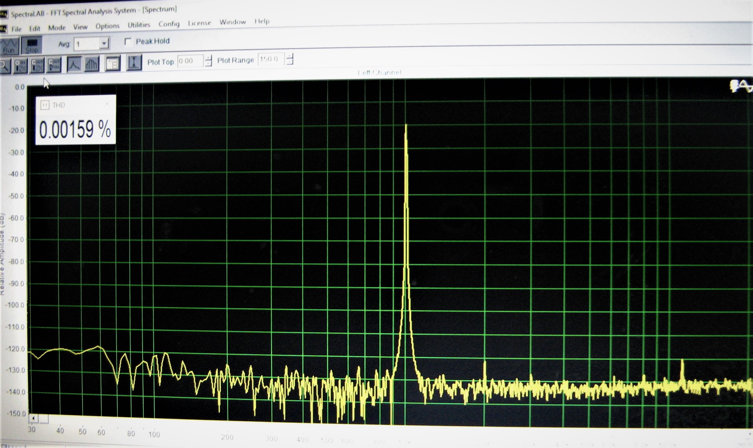

If the opamp does not whistle, then the distortion spectrum on all TPA32xx should be something like this. Regardless of the type of op-amp.

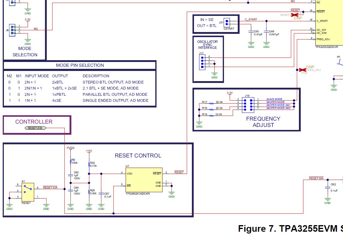

It is possible to switch to 1PBTL + 2BTL mode.
I have three speakers in each speaker. I connect the PBTL channel at the low frequency, and at the midrange and high frequencies through the BTL channel.

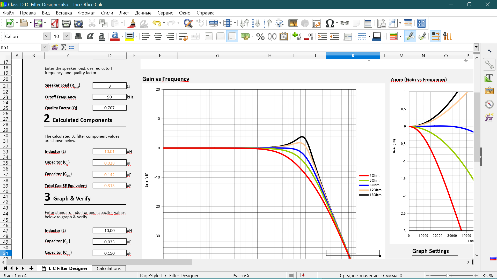

THD measurement at 10 watts RMS into 8 ohm load.
The noise level is about 100 dB.
P.S. The filter calculation is available on the TI website.
I tried to recalculate the filter so that the frequency response does not fall over to the high frequency when the driver resistance is 8 ohms. It turned out that the filter frequency should be 90 kHz. for 10uH coil.
Or change the inductor.
This is clear. Didn't want to change inductance ...
To increase the inductance means to buy another one and wait for it to arrive - a month or more. This is not an option.
It is not clear why ULFs are designed for a load of 4 Ohms?
Does everyone have car speakers in their acoustics? :)
My speakers have 16 Ohm drivers for LF and MF.
P.S. I'll leave it as it is for now. I will equalize with an equalizer ...
Try to make feedback from the filter output -PFFB . The effect of the filter will decrease.
