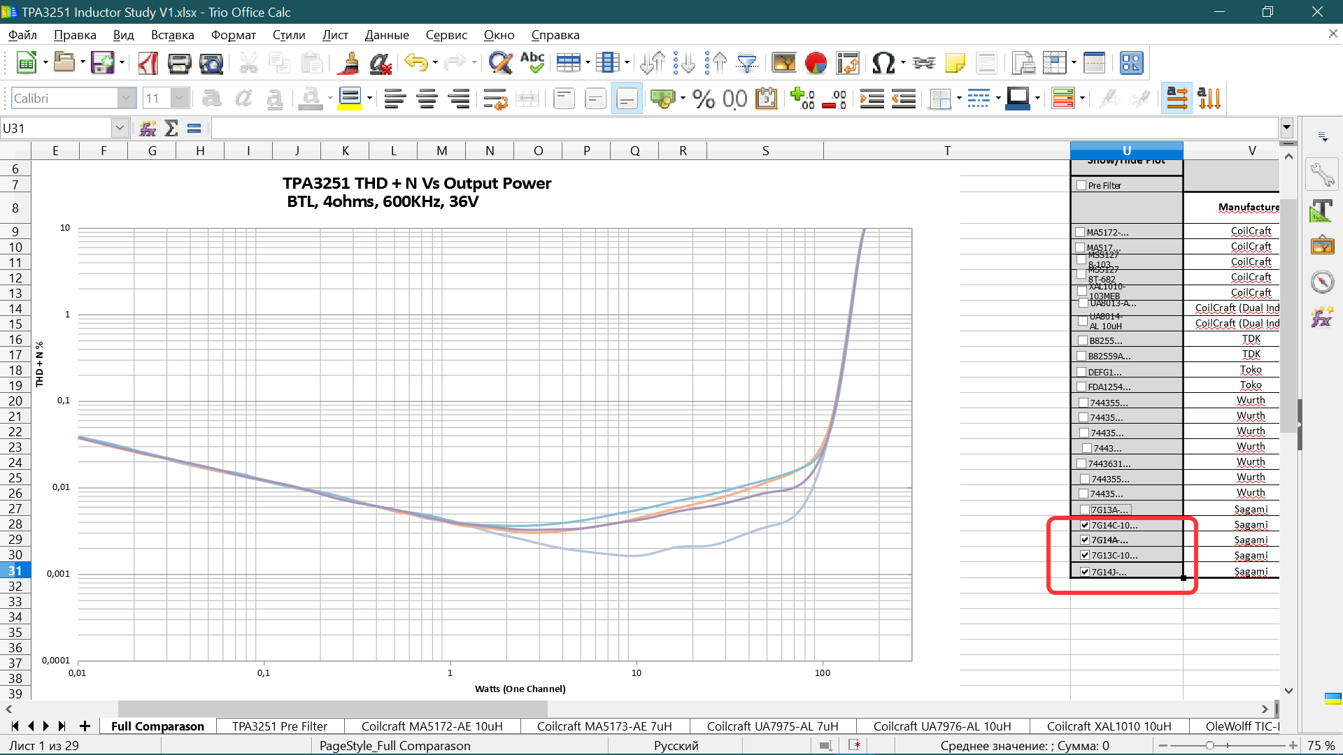

for those folks trying to optimize the output filter, please remember that speakers are not a pure restive load. The way to fine tune the filter is to attach the speakers and measure the output with an AC voltmeter that is accurate to the frequency of interest or an oscilloscope. If you have an accurate impedance model of your speaker that will work as well. Things get more complicated if there is a crossover. What happens if your speaker is 6Ohms at 10KHZ and 12 Ohms at 20Khz or visa versa?
No. The way to "fine tune" the output filter is not adapting it to your specific speaker but find a solution that yields a low impedance over the entire audio band. This can be achieved by PFFB.

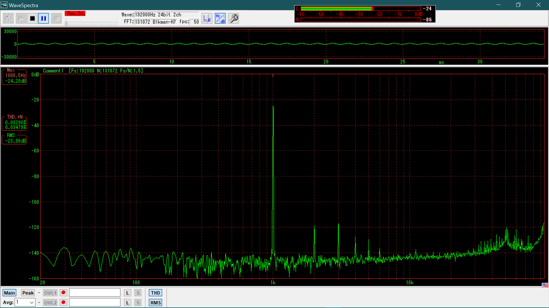

Polevka,Okay! Harmonic analyzer software?

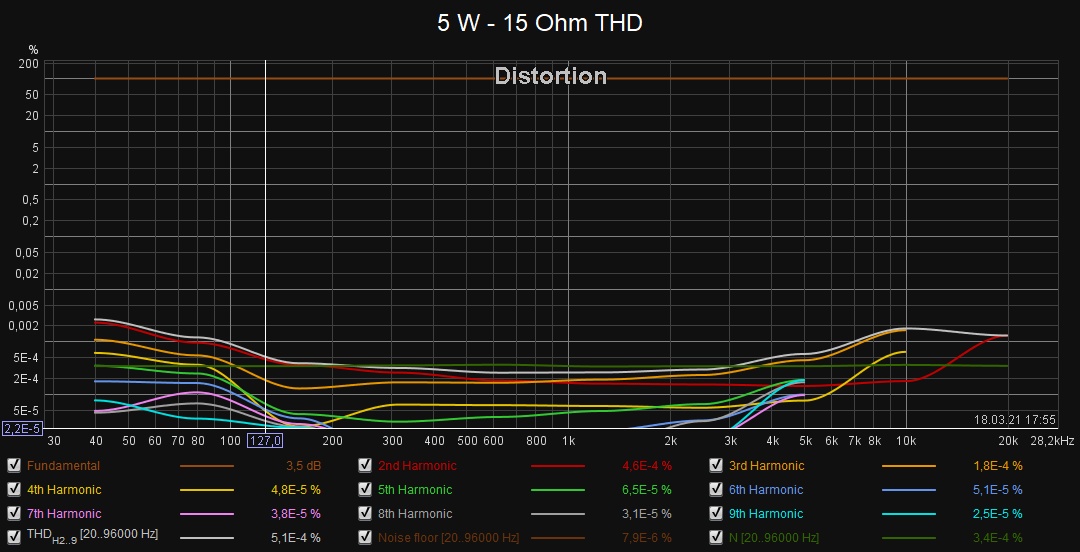

Confused? :) It's static. In dynamics, everything is much worse. At LF and HF, due to small chokes, distortion is large. Distortion measurement at 1 kHz. does not say anything ... They can be small, but on LF and HF they will be large.
REW program. I have been using it for a long time. A wonderful thing.

At low frequencies, distortion increases due to electrolytes. It is necessary to increase the capacity by 5 times and it will be good.
Excellent, matches the datasheet.
Fine. Thanks for the advice! I will definitely try to replace the electrolytic capacitors.
Take a closer look. The noise floor is less than 90 dB. at HF.
How will the MW LRS-200-36 power supply react to the increase in capacitor capacity?
Doubled the capacity of the capacitors. Nothing changed.
I assume that the problem is not in the capacitance of the capacitor.

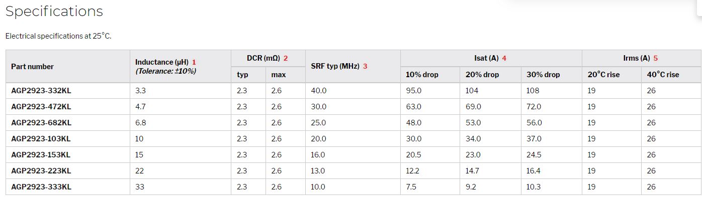

The problem is there is not enough open loop gain to make the feedback adequate. The inductor adds distortion and large amounts of feedback around the inductor would help to minimize it. Also, if the inductor is running too close to saturation it may be more non-linear. Running close to saturation creates more harmonic distortion.

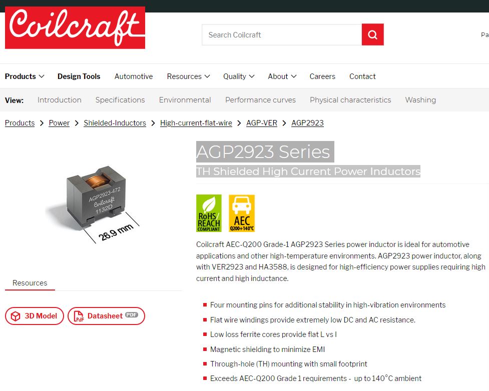

This inductor looks like it might be pretty good choice for the TPA3255 designs... AGP2923 Series TH Shielded High Current Power Inductors: AGP2923 Series TH Shielded High Current Power Inductors | Coilcraft
Use TPA3255 for its intended purpose and there will be no questions about the inductors used. When used in PBTL mode, it doesn't really matter what kind of inductors you have.
For good stereo with low distortion (if there are passive filters in the speaker), you must use two TPA3255 microcircuits in PBTL mode. Even the cheapest filters from SAGAMI (7G14J-100M-R) provide very little signal distortion. Perhaps the best.
Distortion plots showing only 1 kHz frequency. are not the main ones.
