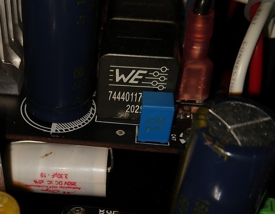

I don't know if anybody can answer this "newbie" question: using the TI-EV Board (apparently optimized for a 4 ohm load) on an 8 ohm speaker - does one get more or less high frequency output - in other words: is replacing those 1uF caps useful or not (new coils are already on the way)?
FYI, I attached Mundorf MKP 3.3uF caps across each of the leads of the four big caps on the 3e board (amongst other upgrades) and I thought it gave an improvement in the upper frequency responses and provided a bit more depth to the music. The downside to this was that I had to put 20,000uF caps in between the SMPS and the amp in order suppress the clipping indicator from going off when I drove the amp to louder levels.

BTW: I replaced Coilcraft with Würth coils (same value) and the difference is quite noticeable - equally clear but a lot softer.....go figure.
Yup not all inductors are created the same, even Coilcraft SER2918 and VER2923 have different performance graphs even though they have the same flat wire coil and similar structure.
What's important is we need to see the published L vs current graph, otherwise we are just doing trial and error.
Ok thanks, yes the inductor's linearity is more important than the inductance value itself. I saw some codaca 10uH inductors that have better linearity than their 7uH counterpart.
Lester: they are Wurth 22uH inductors, part # 7444011715220, and the blue caps should be 0.68uF. I changed out the ones that originally came with the 3e amp to those values based on the values listed in the attached article (see "LC filter Design", pg 6) because my speakers are 8ohm (nominal) and not the 4ohm everyone wants to design their LC filters for on most of these 3255 amps (and I’m guessing everyone wanted to copy the specs on original TI 3255 amp board document).
I just wanted to see if changing the LC filter components brought any greater higher frequency depth & sparkle to the amp. The 3e was a really good amp just out of the box but not as audibly rewarding as my My_ref Fremen EVO A build. I was just fooling around with it and after the addition of the 3.3uF bypass caps plus the necessity of the 20000uF power caps, I thought it finally sounded pretty good.
