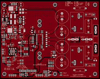

I think that JLP has done a great job especially with BTL. JLP try to use PBTL you should gain some db .
Thanks, I already sent the PBTL mono module to the manufacturer, We expect it to arrive next week (but there's a looming Delta Variant preemptive lockdown in our place)
I placed screw mounts for 2 types of ATS heatsink so supply issue will not be a problem.
Then LM2940 for TPA3255 xVDD and split supply LM317(input from LM2940) + TPS7A3001 for the opamp. Since using TPS7A4901 looks overkill.
PFFB can be enabled/disabled by easily accessible jumpers on top PCB.
This will redeem the Sylph-D name for SINAD and power rating hehe
Board size 100 x 130mm so it can fit in a smaller chassis.

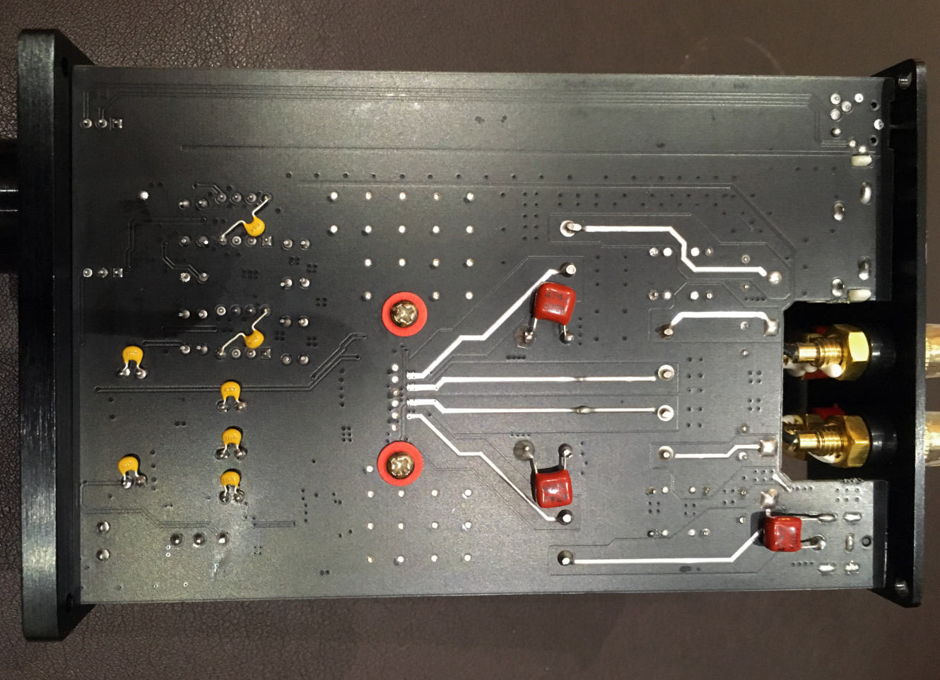

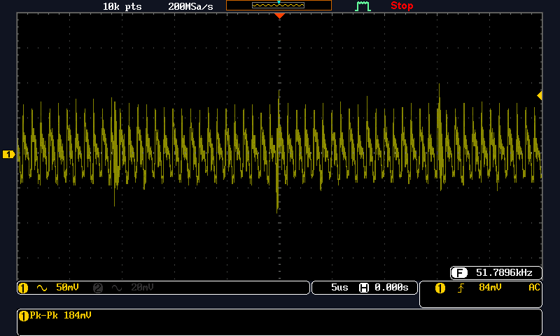

Posting because I'm sharing a few of oscilloscope traces for your interest. These show switching noise on the main supply rails. This noise is most likely due to the digital switching noise when the TPA3255 is operating. There is little that can be done to reduce this noise since accessibility to circuitry is blocked by the heatsink and the fact there is little spare room inside the small case. I did add a few supply decoupling caps to the main supply and across the 12V preamp supply. These made only a very small difference to the noise amplitude.
The first scope trace shows the main supply rail when the TPA is asleep (the A07 has a switch on the front panel. There is a fast pulse coming from the switched mode PSU running at 66kHz, the pulse causing a ringing at about 20MHz that decays rapidly in about 500ns. The second scope trace shows the same main supply rail when the TPA is awake. Wow, the digital noise from the TPA eclipses the noise from the SMPS. Guessing now but I'd suspect that some of this noise will make it onto the analogue section of the TPA.
Note that the frequency of the supply noise is well above the audio range. Even so, the circuitry or layout could be improved to eliminate this noise.
The last attachment shows where the decoupling capacitors where added, these had to be physically small to fit between the PCB and the case. As stated already, they did make a difference but only very small.
