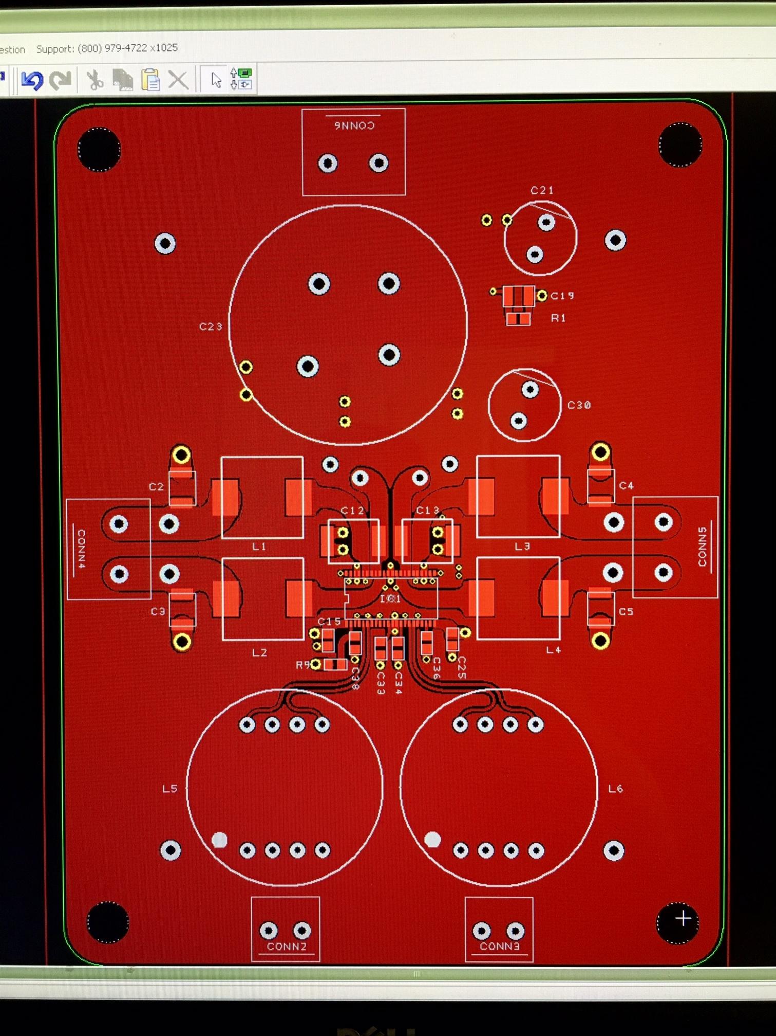

Round #2.... Hopefully an improvement over my last 'sub optimal' attempt
130mm x 100mm. Supply @ 15V. I only need a couple watts.
Nice. Are those spots for Cinemags on the input?
XRK971 - Thanks for the reminder I will be using the Cinemag Transformers for this board.
5th Element - Planes 1,3,4 are pours tied to ground @ the 4-pole Cap. Plane 2 is used as the 0V pour and also tied to the 4-pole GND.
DoctorEvil - The large round ic is a 'woeful' mundorf 4-pole 35mm cap. I changed the LC 1uf filter cap to a MKP10 100V. This should decreased the loop area. I agree, the other cap was silly large. Using vias for the bootstrap circuit is a necessary evil. I am not a big fan of the TPA3251D2's pin layout.

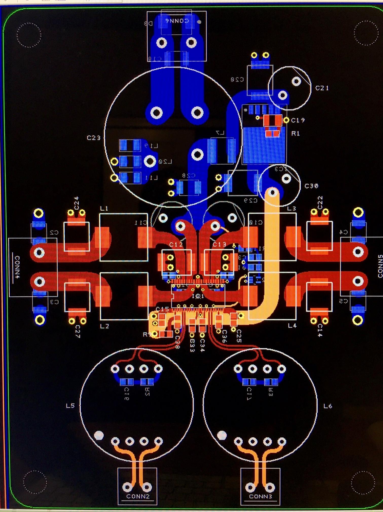

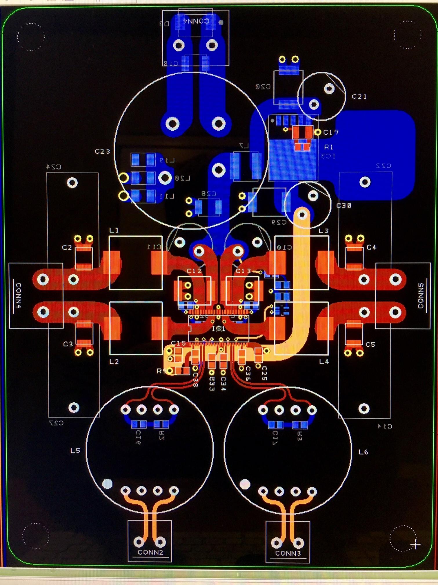

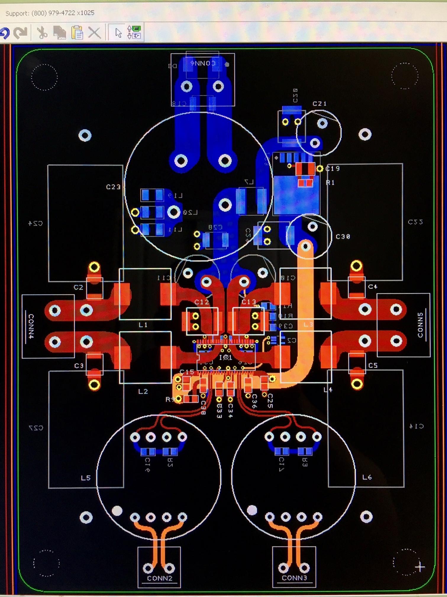

I have attached the latest reversion with the WIMA MKP10 and WIMA 2824 PPS in the LC Filter Position.

What's not to like about the pinout? It's rather functional as far as I am concerned.

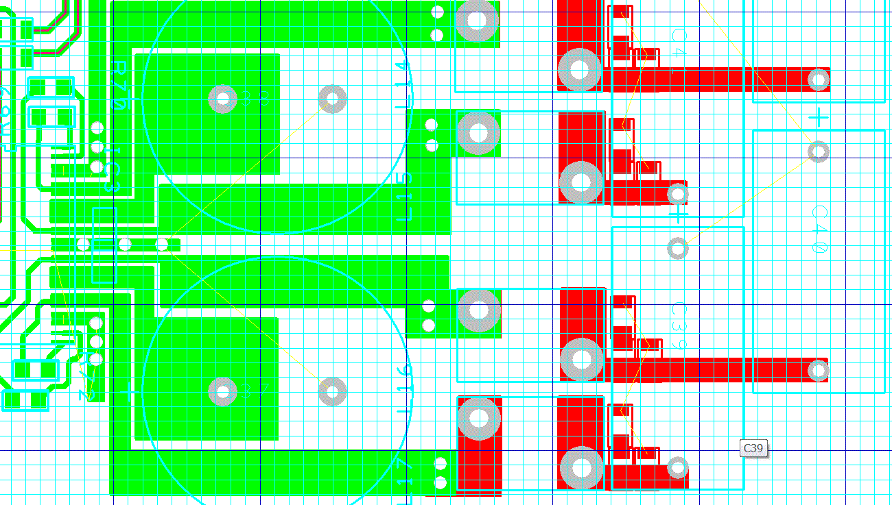

Here is my layout of the power side.
You'll notice that the power hasn't been completely routed as I used thick wire to do this. I wanted to keep the ground plane completely free and didn't want to route the power lines up and around the inductors.
My only gripe about the chip is that it's been built around a 44 pin package. It's tiny, especially vs the heatsink size, so why not make it 46, 48, or 50 pins etc?
It would be great if all of the pins on the power side were doubles, if not triples in places. I'd argue for doubles on every output pin and triples on the power and ground pins.
Either way there's nothing I have particular issue with with regards to the pin out itself, just the space constraints due to the tiny package.

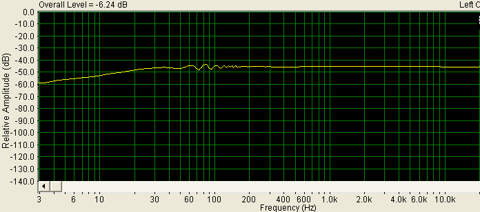

I wonder how good 56k modem transformers will do here. (It's not Cinemag nor Lundahl but hey.. )
Those:
P3356 - ETAL - TRANSFORMATOR, V.90, 56K | Farnell element14 Deutschland
Datasheet: 10Hz-55kHz (-3db)
A friend measured those to:
distortion at
1khz 0,024%
100hz 0,06%
sweep -3db at 18 hz

small transformers fall apart when volt*seconds get larger Eg high signal level and lower frequencies, sure you can just about dial in good numbers with lower impedances and smaller drive, <data scale> at -45dB
try -3 or -6dB at 30Hz with low distortion, maybe not good distortion
