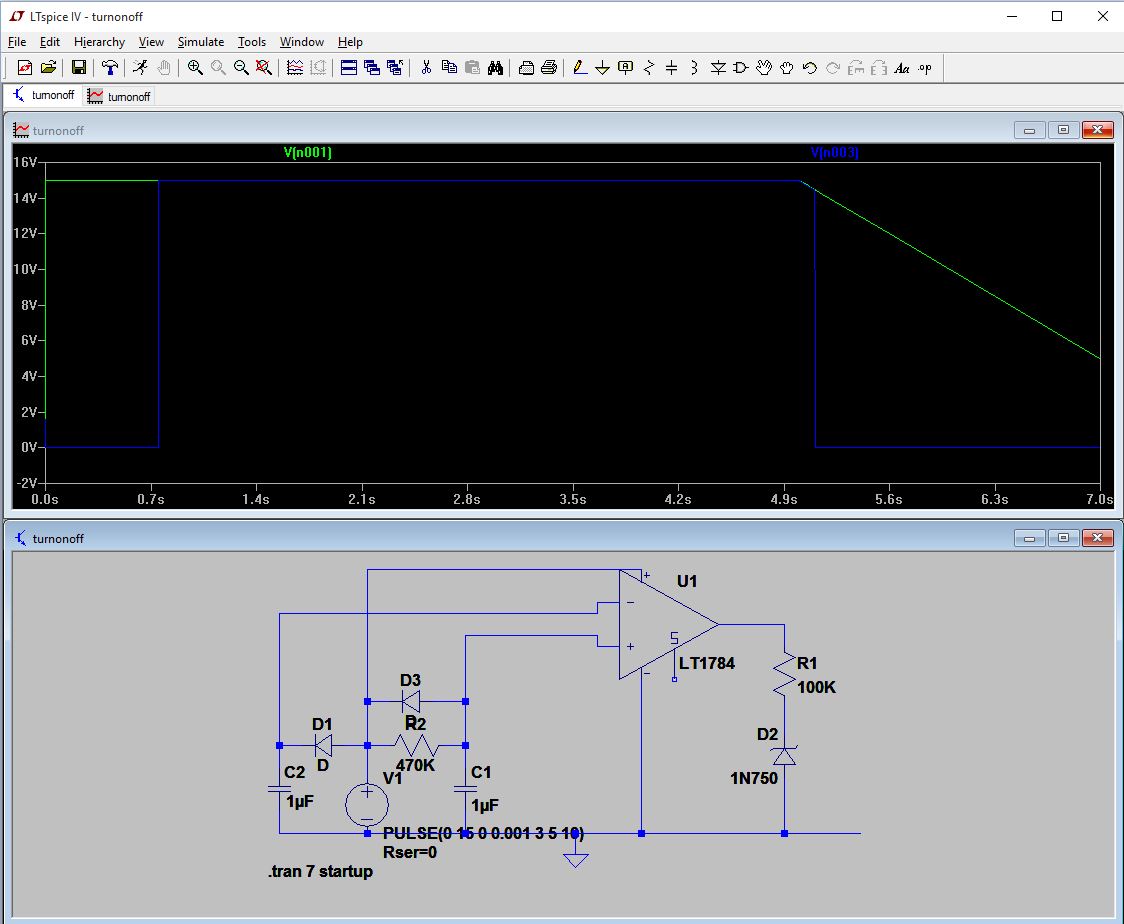

3) A turn on delay and instant off to avoid thumps, a opamp monitors the power rails and drives RESET.

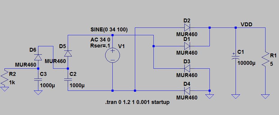

Hi, I still have my doubt about the split supply. One of the things I would worry about is that the -PSU is now directly in the signal path as the drive signal is referenced to GND by the op-amp stage, but at the TPA it's referenced at -V.
Any ripple or other junk in -V will get into the signal. In practice might not be so bad as the input is balanced so should mostly cancel out, but some chance of oscillation if the impedance of the -V return is high...

You may want to add a bit more hysteresis to your "voltage supervisor".
Thanks guys for the feedback, its appreciated.
I will go back and re-think the power supply and simplify with a single supply, and use a virtual ground reference for the opamps (along with dc input decoupling).
Regarding the voltage supervisor (manages RESET to avoid turn on / off thumps) the diodes provide the hysteresis - unless I'm missing something else. Attached is a simulation that shows this working.
No need for virtual ground for the OPA's even if you use single winding transformer... (Left side is the output for the negative supply, the 1k R is the load for the model only)
