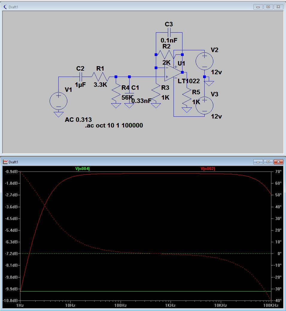

Guys, thanks for all the feedback.
I have updated the schematic to include the feedback as well as a couple more optimisations:
- TPA ICs setup in master / slave mode (to ensure minimum oscillator interference)
- Passive out of band filters on the inputs including DC decoupling
- Single earth and a simpler power supply. Rob was correct - trying to keep a split supply made it too complex and potentially would detract from the sonics. I adopted the charge pump idea for the negative rail and with regulation & low current draw is a better solution.
- Added more diodes for 1.5v hysteresis for the voltage supervisor
- Decreased the opamp resistor values to reduce noise
- Cleaned up the schematic so it is easier to read.
I think this is about it - do have a final look to see if I have forgotten anything!

Input filter plot
Input filter LTspice.

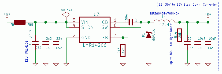

Looks better.
Two remarks. You have 3R3 resistors in the +12V line of the GVDD, but the reference design put the 3R3 in the VDD line only. Any reason to change this?
The LM317 is now dissipating a lot of power... 24VAC gives about 32V, so the regulator takes 20V, the +12V needs about 100mA per chip, so 200mA in total. This is 4W, needs big heat sink. I see TO92 in the diagram, 4W is not going to happen with a TO92... TO220 with a big heat sink will work.
But to save power, maybe consider the switching regulator from the reference design?
Rob
Thanks Rob.
I have been working off the datasheets and it does look like the datasheet and reference design conflict (d/s has 3R3 in the +12v GVDD line). I see a post on TI E2E commenting on the discrepancy. I'll change to the reference design.
Also good pickup on the LM317 - I didn't check the current draw for the +12v, not expecting it to be that much as it doesn't power the main drive. Ivdd and Igvdd is 90mA according to the datasheet however when adding the current used by the opamps it will be around 250mA total, so the regulator has to swallow 5W, too much.
I also tried modelling splitting the power supply and having the output of the bridge rectifiers in series with +15v being accessible from the bottom supply however both the charge pump and the Vgg supply would add significant load to the bottom supply as well as doubling the ripple/noise from both supplies to the +30v rail. So I'll implement a switcher.

Some notes/questions:
- Wouldn't it be better to decouple the pots from DC with 2 additional caps?
- Are you sure to come along with an 1.5A regulator, quiescentcurrent is already ~150-200mA
- You may want to have impedance matching resistors in your clock lines
- By that you can also implement slave mode switching1/2 (+/+ -/- or +/- -/+ (Datasheed 10.2.1.2.4)
- Why are you using JFets+Pullups+Zenners? (Why not :D )
- You may want to increase CStart later (up to 680nF), have your footprint ready for that
- Schematic readability would greatly improve if more GND-symbols are used rather than having extra long GND-wires
- FREQ_ADJ of slave must be connected to DVDD not GVDD
- You want to have the series diodes behind the cap of your LC-Filters to work properly
Keep it up.
Regards, Christian

Regarding 1.5A regulator, 5th Element sums it up, the near field speakers will be crossed over at 100Hz and never ask more than 5w from the amp, most of the power supplied by the 2200uF local decoupling. But I'll swap out for the 3A regulator just in case.

Regarding caps on the pots, I'm not sure they are needed as I already AC couple the inputs and any quiescent bias DC from the opamps should be minimal? I'd prefer to keep caps out of the signal path as much as possible (the main reason I'm using two TPA chips so that I avoid an electro in the output when using SE configuration). These pots will be set and forget not a regularly used volume control as volume will be set in the source (a PC). So 'scratchiness' caused by DC on the pot long term shouldn't be a problem and the current amp I have been using for years that this design will replace uses a similar scheme and the pots are dead silent. However I'm happy to hear of other reasons to AC couple the pots.
