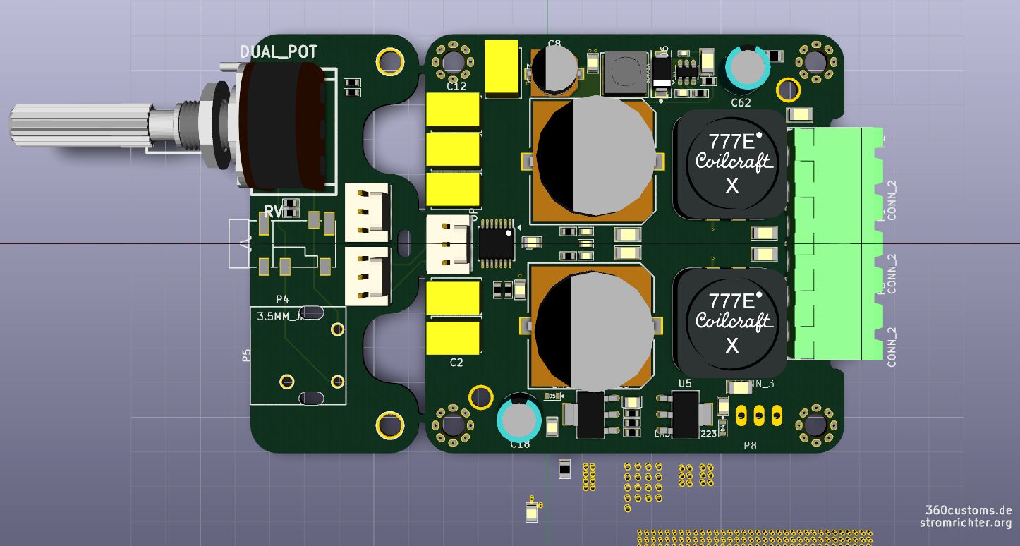

Work in progress, the "shrink mod".
Baseboard will be 60*60mm to fit in an enclosure, front panel will be an optional brake-away.

I used an lm46002 for its supposedly decent emi performance! Providing the layout is good.
Did you check them with a mobile phone?

Will let you know when i'm on the finish line. 🙂 It's actually a pretty tight fit.

Thing is, a BTL amp already has two channels operating 180 degrees out of phase. Assuming 50 percent duty cycle (zero volts DC output across the two outputs) and BTL outputs, one BTL leg (call this speaker +) will switch high while the other BTL leg for the same channel (call this speaker -) will switch low. Then halfway through the PWM cycle, they'll flip back.The power being delivered to the load, ie the audio signal, is completely different to the square wave switching of the chip itself. As far as I am aware all four channels switch together and are synchronous to one common oscillator.
When you wire up a slave with reversed clock polarity it means that as one chips output stage (say the masters) is switching off the others (thee slave) is switching on. Meaning there is always one chip on and one off, rather than both on and both off at the same time.
If you sync two of these BTL channels in phase, at the beginning of the PWM cycle speaker + on both channels will switch high together and speaker - on both channels will switch low together.
Now if you sync the two channels 180 degrees out of phase, speaker + on the "zero degree" channel will switch high at the same time as speaker - on the "180 degree" channel. Effectively you've got the same situation as if you simply renamed speaker +/- for the second channel, inverted the audio input, and did zero degree synchronization.
But if you sync the second channel 90 degrees out, the 2nd channel's switching events will lie halfway between the switching events of the 1st channel.
Of course all this assumes AD modulation (I haven't thought about how BD would work in this scenario, have to stare at some timing diagrams) and no audio signal present.

Your rendition looks amazing!!
Very nice doctor!
So there is no consensus about having the slave in phase or out of phase with the master clock? Given the BTL configuration there will be concurrent switching regardless of clock configuration so I don't think it makes a difference. The datasheet isn't very helpful in this regard.
