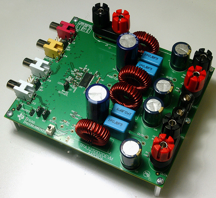

Anyone scanned through the EVM manual already?
http://www.ti.com/lit/ug/slvuam9/slvuam9.pdf
Source: http://www.ti.com/tool/tpa3250d2evm
Hey hey, good find. Creating the part now, gonna have the PCB/parts ready for when the chip drops.
It's a shame TI made the TPA3250D2 NOT pin-compatible to the TPA3251D2.

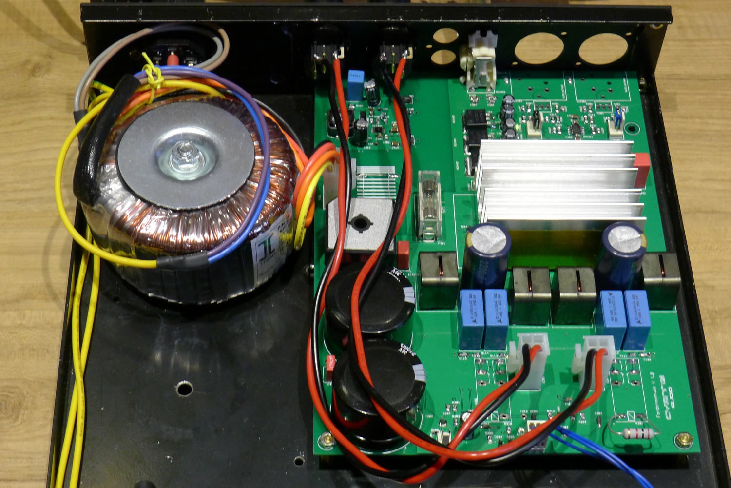

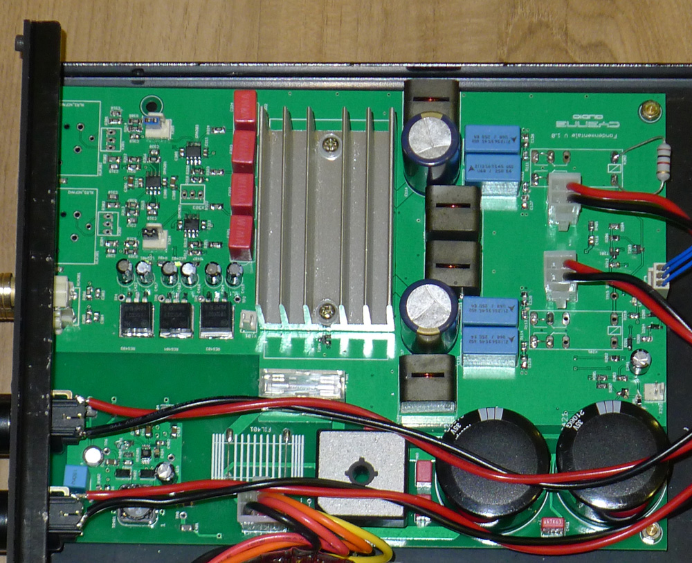

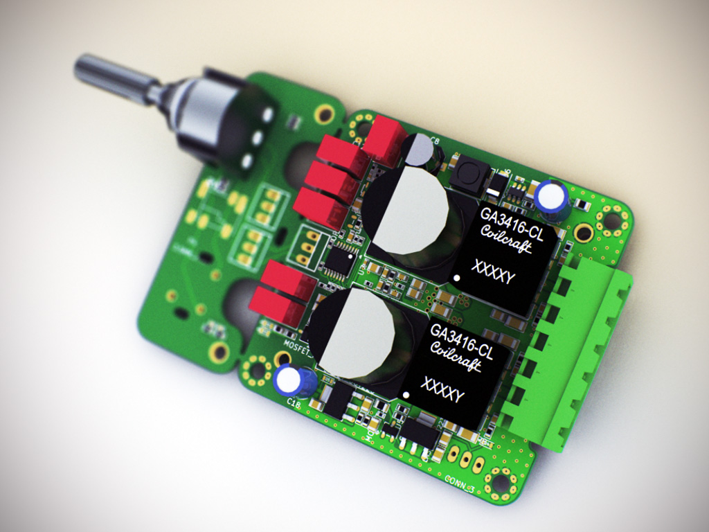

After some delay my amp
Just a short notice for people considering this chip for an amp.
I finished designing and building this amp.
Before this I designed class-A amps... 🙂
The sound of this chip turns out to be very good. It sounds like a class-AB amp. I compared with the eval board of the TAS5630b and the TPA3251 sounds much better (but has less power).
I also compared with the IRS-2092 ref design iraudamp7s. This is a much closer contest where the iraudamp7s offers more detailed sound but sounds a bit bright on some music. The IRS-2092 has noticeable more background noise compared to the TPA3251.
When cost / size / power use is not a factor, I still prefer class-A amps, but this chip comes close and does not have the typical 'class-d sound' of earlier single chip solutions.

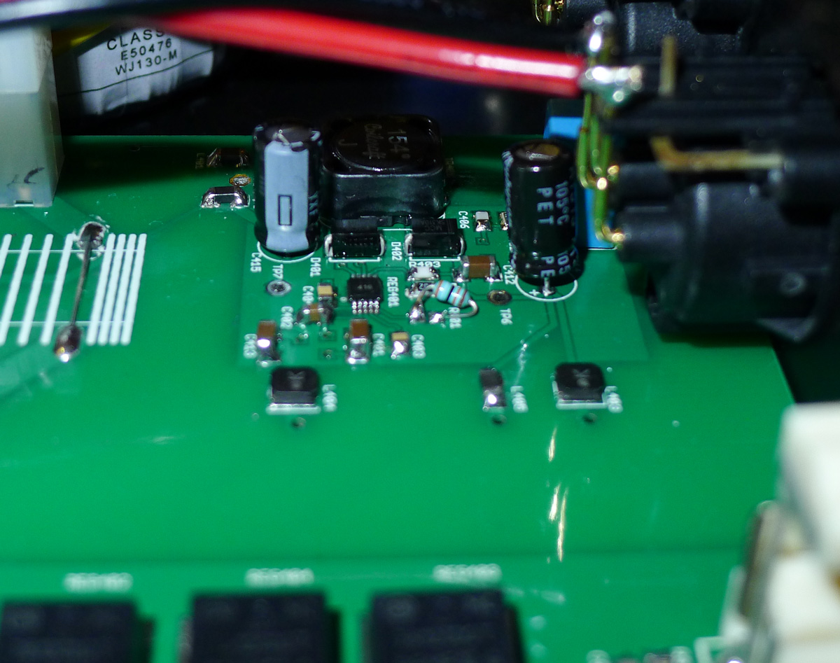

What is this switcher you used? Symmetric output for the analog front-end?
The front end power is from TI design "slva369a split rail supply with TPS54160". I changed the output voltage to +/-15V (R1 = 36.5k) to have enough voltage drop to use common 7812/7912 regulators as the now often used low dropout LM2940 / LM2990 are expensive, have high noise and the ripple rejection at high frequencies is not better than cheap 7x12 regs.
As the load on the switching regulator is asymmetrical (100mA from +, 20 mA from -), the output voltage is +14.8V / -15.2V, post regulators are needed to get a symmetrical supply. To get +12V for the chip amp, I use a separate 12V reg.
The 7812/7912 have only about -20dB ripple rejection at 1 MHz, so I added a 10uH inductor before them to get rid of the HF ripple from the switcher.

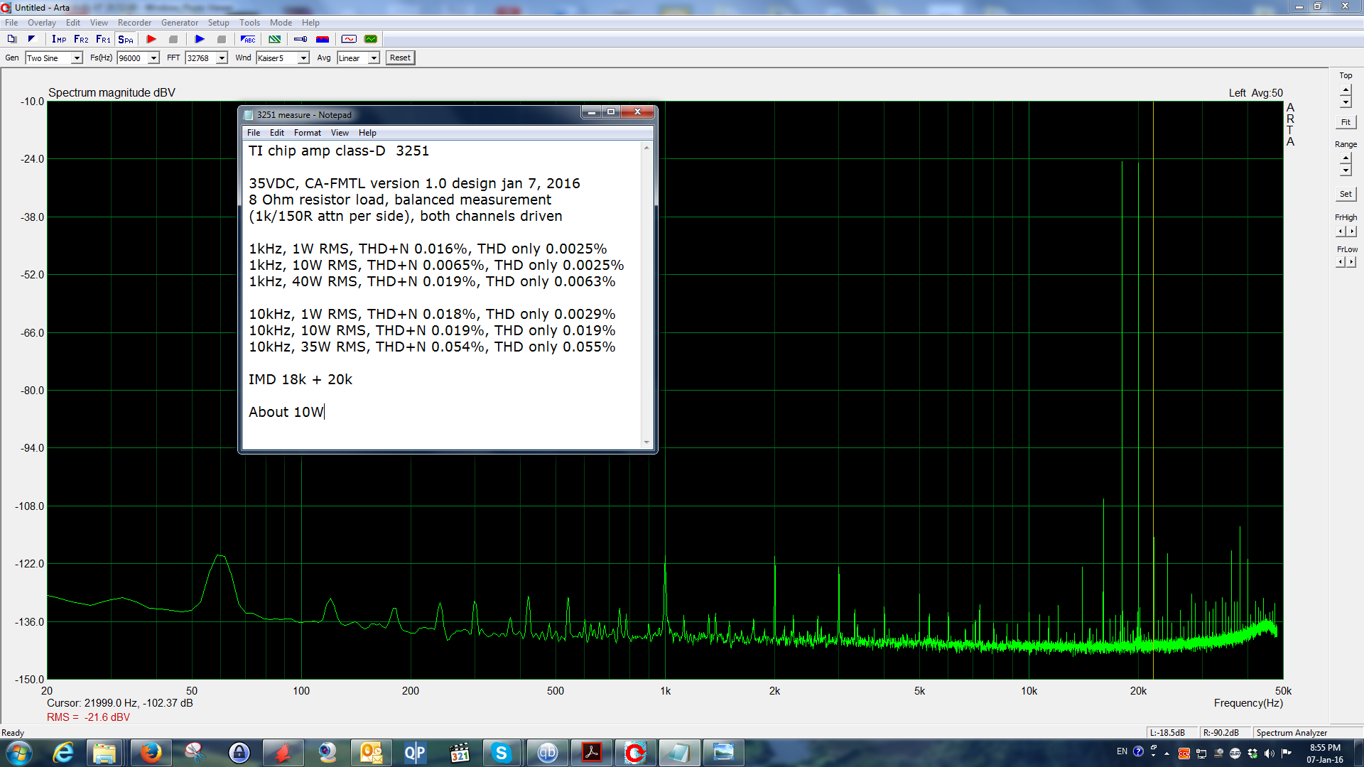

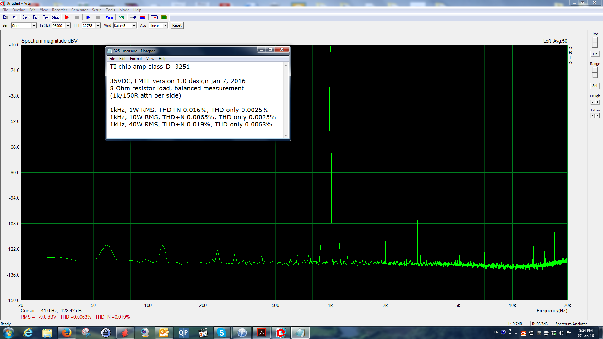

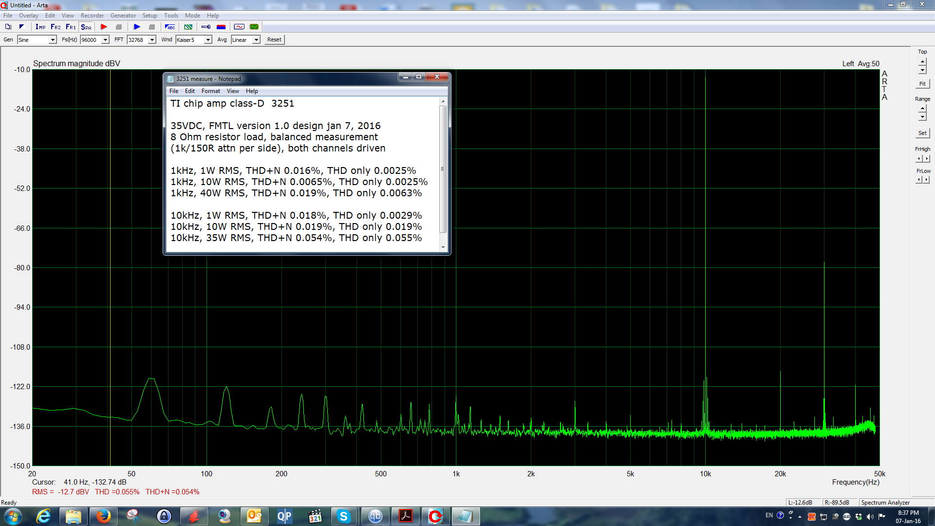

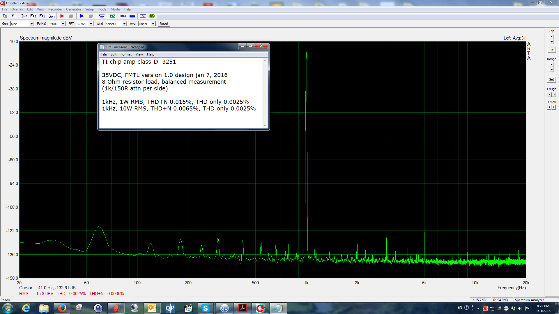

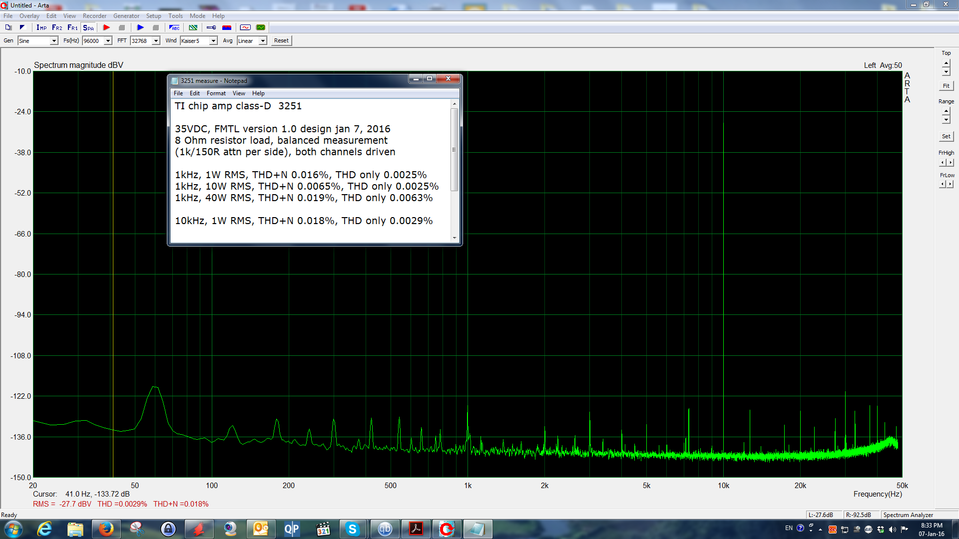

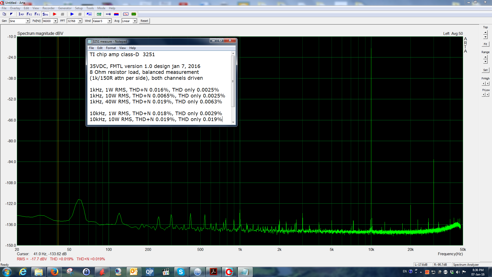

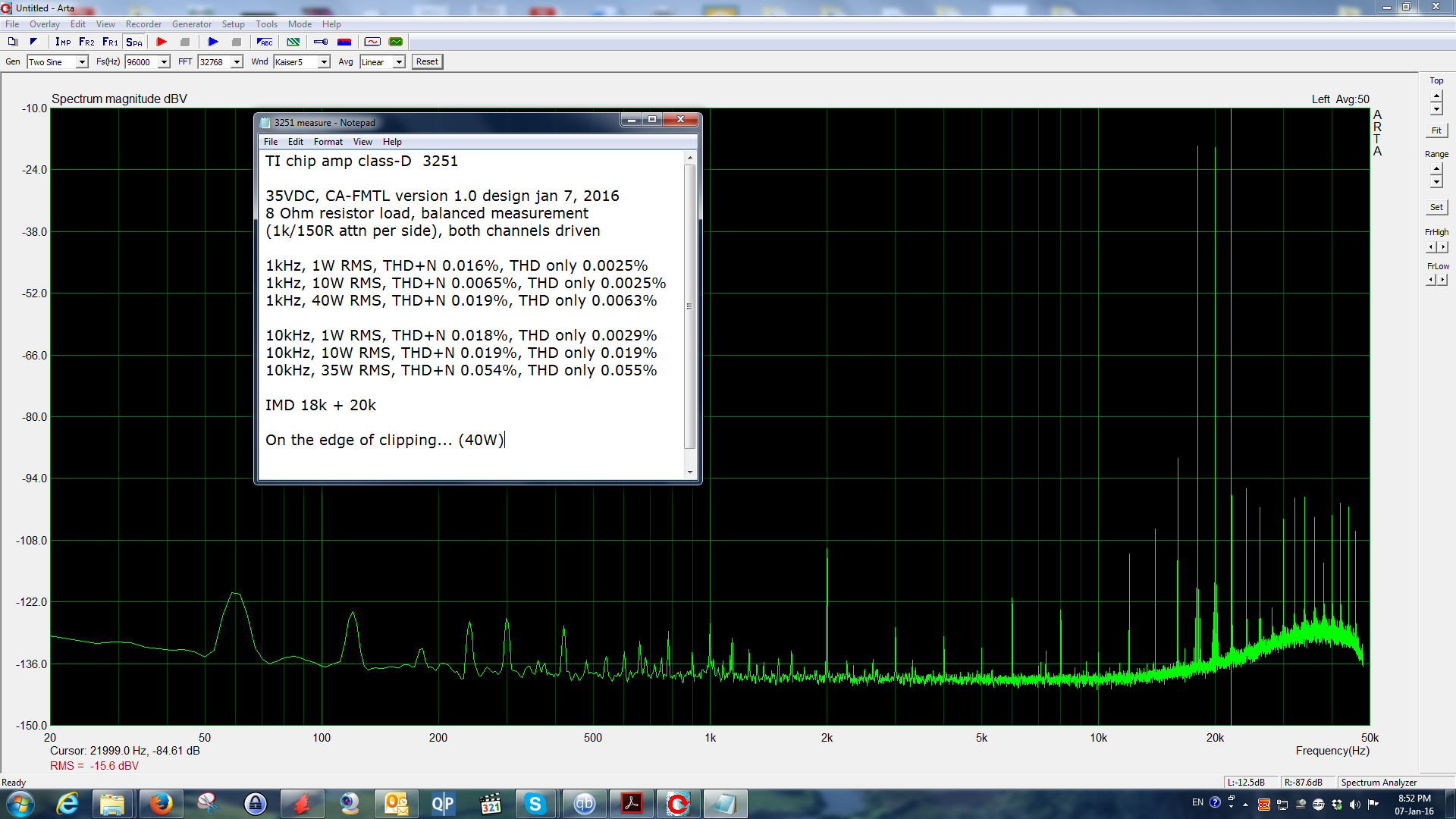

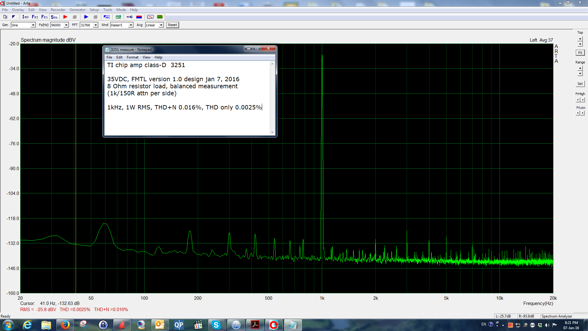

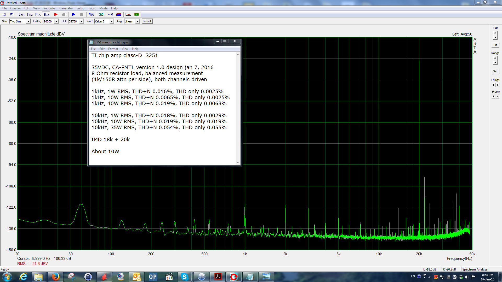

The objective side: measurements
Measurement done with Arta 1.8.2 and a Julia sound card in ASIO mode, using a balanced attenuator (2x 1k/150ohm) and the balanced inputs of the sound card. Sample freq was 96k so can see till 48k. PrismSound passive low pass filter was used to avoid interference with the class-D carrier signal.
Some observations:
1) At 1 kHz, the THD performance is very good. At lower powers, the spectrum is totally clear. Very good for a class-D.
2) At 10kHz, the distortion is higher, but lower than most class-D and also marginally lower than the IRS-2092 reference. However, a good modern class-AB does this better.
3) IMD 18k+20k looks very good for a class-D amp. Only at levels above 10W, the spectrum becomes a bit crowded. Also here the performance is a bit better than the IRS.
During test the heat sink was not very warm (<50 C)
Conclusion: better than I expected, the TPA3251d2 is a large step forwards in single chip class-D amps.
Hopefully useful.
Rob
Some observations:
Hopefully useful.
Rob
Cyenne Audio

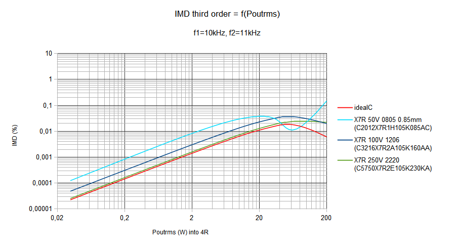

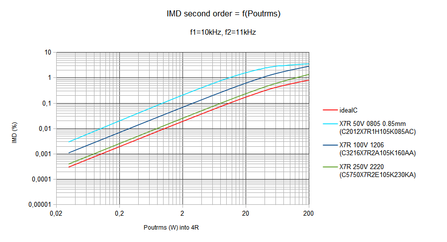

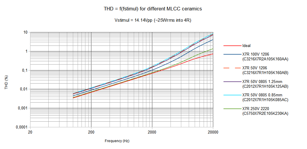

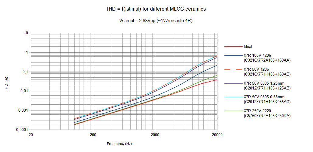

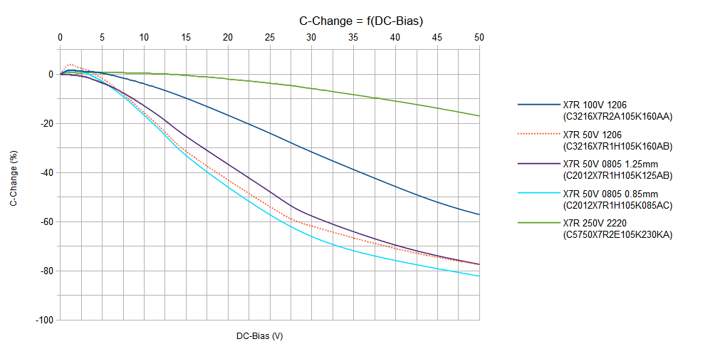

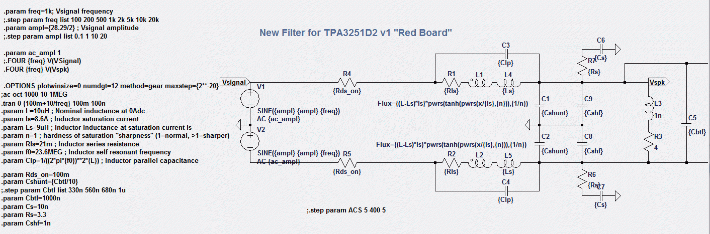

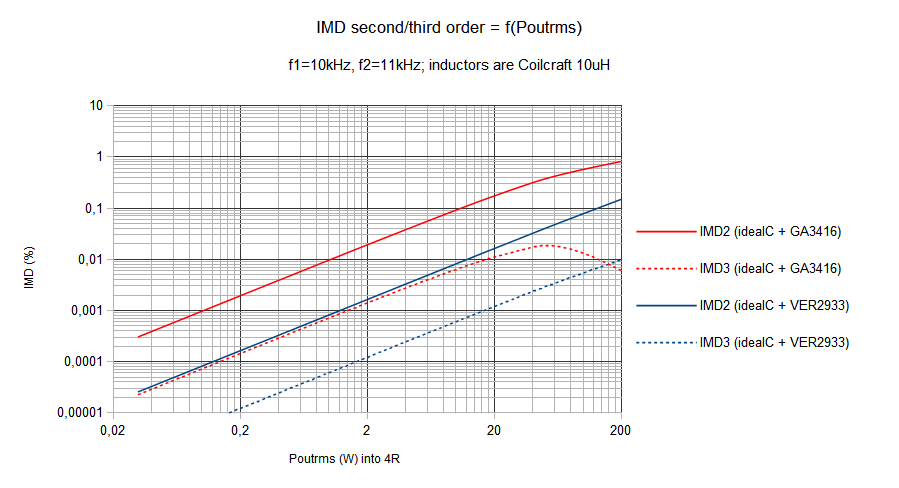

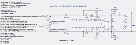

Hi Rob,
thanks for the input. I'd be interested to see the IMD with another inductor, as they have a quite "high" impact on performance.
From a simulation:
And may i ask for a measurement with MKT/MKS at the output, compared to the now used MKP?
Im still a bit unsure, if MKT/MKS would to the job in my shrinked down version of this amp. I did some simulations regarding this (THD, IMD) for MKP as the "idealC" compared to "oversized" ceramics" like shown.
The simulation is done with the TDK dc-bias modells which also includes C=f(f).
DC-Bias:
THD = f(Pout):
IMD for different caps:
The simulation is done on this setup:
All simulations are down with the parameters of Coilcrafts GA3416 (except otherwise noted), so the charts are biased with those characterics and the math behind the inductor-modell.
Christian
From a simulation:
DC-Bias:
THD = f(Pout):
Christian
