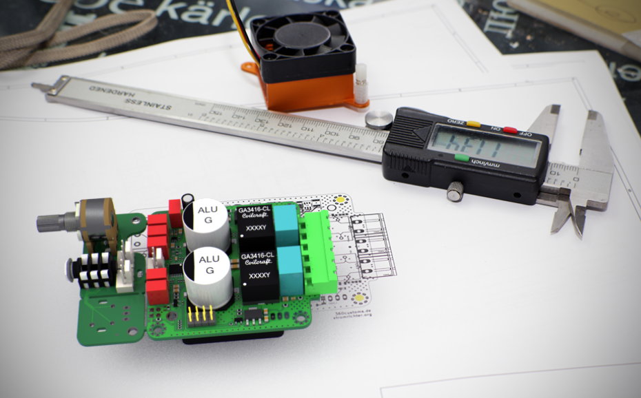

Work in progress, the "shrink mod".
Baseboard will be 60*60mm to fit in an enclosure, front panel will be an optional brake-away.
when will it be ready for final production ha ha
I'll send the production data to the fab in week 05 i guess. Fitted those bulky MKP, finally. 😀
Incredible! Is that an Optical-In socket on the breakaway next to the volume pot? Is a thermo fan controller onboard too?

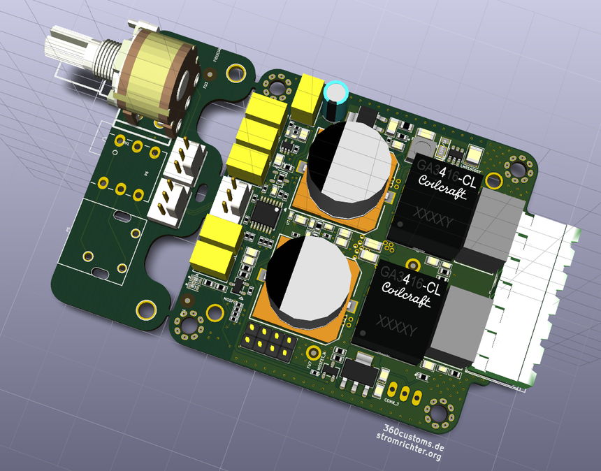

Its a tight and right looking design with very high quality components. It should spec out very quiet. I like the orientation of the TPA3250 mounted that way, rotated 90 degrees from most other designs.

No optical in this time - fan has 2-stage control (low/high).
Actually it's TPA3251D2, TPA3250D2 wouldn't need heatsink (or wouldn't benefit much from it).
Board should run fanless (with heatsink) in normal conditions, needs to be tested.
Actually the IC is directly under the heatsink, mounted "normal".
Ahh.... Still 'out of the box thinking'. Solves the need for a handmade heatsink while keeping the layout compact and tight. Very nice, no compromises, problem solving design. Its obvious that you have put a lot of time and effort into it. I expect it to be an exceptional performer, as I am sure you do too! Thanks again for sharing.

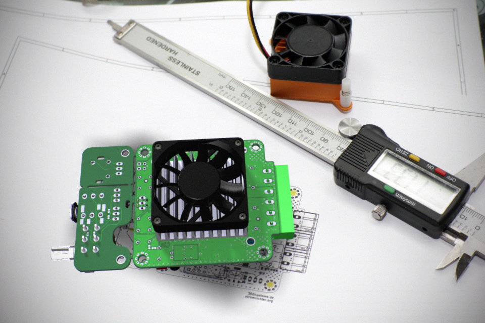

Got the heatsinks today, needed to alter the footprint and board a bit.
So finally, this is it.

I'll evaluate up to which power-levels the fan is not needed. As the implementation is shrinked down, at high output levels the fan will be needed to keep the system running.
At the "old/first" board (100*100mm) with its bulky heatsink, no fan is needed even at full sinewave output.
5thelement showed in the past that at moderate levels there is no need for a heatsink either. So, at levels below (would guess) 20-30W, no heatsink or fan is needed.
But you have to keep in mind, in small enclosures only passive cooling (convection) wont be enough, no matter what heatsink is used. Peak-power sinks into thermal capacity.
You're free to implement a different cooling, i.e. heat-bridge to case or something similar. I keeped this in mind when i designed the board - so when mounting this board into an metall case, you can have a pressfit-heat-bridge to the case without a fan. The board has 1.5mm space on the sides to slide in the usual chinese aluminum cases.
Alternatively you can glue (thermal-glue) metall of your choice to the IC. 🙂
