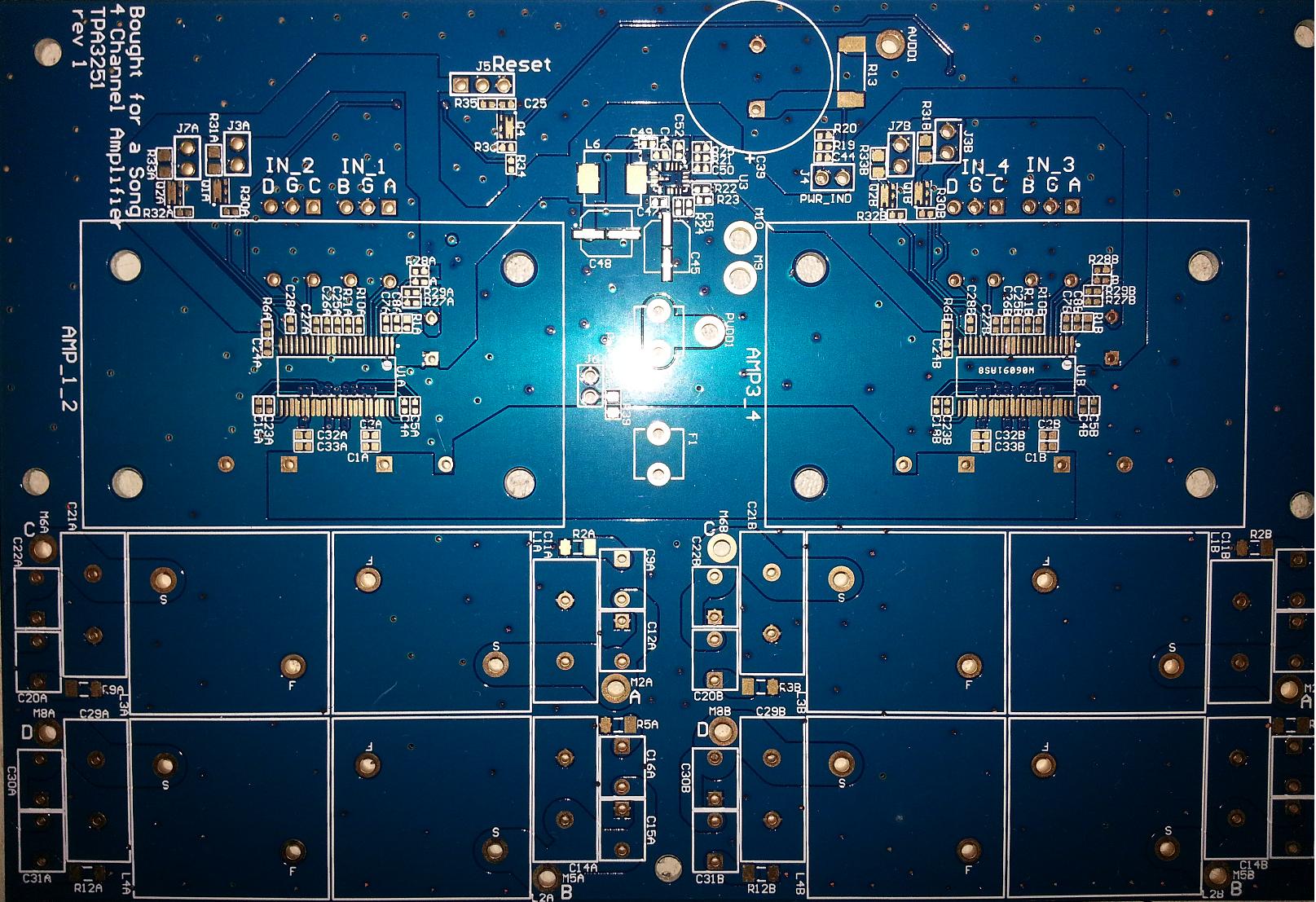

Been following this thread! Great information and posts, thanks for taking the time everyone. Attached is a pic of my board. Hope to have it running soon. Decided to go straight to 4 speaker channels per board.
Bulk capacitors are installed on the bottom of the board to move them a bit closer to the pins. 0402 will fit under the heatsinks. Looking forward to listening to them. Currently running the TPA3116 and these sound good. Pretty much TI reference design with LT8614IUDC#PBF switcher, a few more caps and Silmic bulks. Was on a budget so footprints are for 1D23A-100M ICE components, PP and PET caps for output filter.
Boards were manufactured by PCBway. I've gotten a number of designs done by them and all have been acceptable quality and on-time.

What drill size are your output connecting vias? Those look a bit small to me on the picture. Not tenting them would also increase thermal performance at this point as the resistance increases with temperature/current flow.

You are correct, holes are only 18mil (had trouble fitting larger ones in there) also should have cleared the mask between the output pins and maybe a few PWR and GND pins too. Probably not enough to force a rev at this point. When hand soldering I've had trouble with pin shorting when I've done that (shaky hands!) so I wanted to keep it cleaner this round. Looking forward to getting these on some drivers. I like the chips distortion graphs but I probably won't be able to hear a difference.

Would be interesting to see how good the switcher performs, (to me) layout can be improved at this point. At what frequency do you run that thing?
Everything could be better but the layout is pretty close to the datasheet. This footprint is very hard to work with. If you take a look at the recommended layout via datasheet, even that seems compromised (running power on a different layer while running back to the feedback pins?). Getting space for the internal vias requires some reducing of the annular rings that I normally wouldn't do and I didn't want to reduce the via size for manufacturing/cost. Let the compromising begin! I've used this switcher before so there is reasonable chance of it working (as well as it could for this board). Running it at 1Mhz I believe. Might have to change if it causes problems. Surprisingly, this footprint works quite well for soldering.
Also seemed like a waste to put a power supply on and only running 1 amp so the decision was made to copy another AMP on the board. This caused a few of routing issues. By no means was this meant for perfect end game designed sch and PCB. I think that would a 4 layer taking up more space.
The schematic and PCB were done in less than a working day as I came across this thread just before putting in an order for some other designs (could save shipping!!).

No problems with the layout in common 🙂 I also stumbled over the feedback connection in the reference layout. (the hell?)
My concerns are that the caps won't perform optimal at 1Mhz compared to proper ceramics at this frequency. (But those OS-CON might/will do.) 🙂

From the schematic, you also don't use pull-ups at the ~FAULT/CLIP pins like i did in my first layout. Works... 😀

Whew! Good to hear the pull-ups are not an absolute. I took a quick look at the amp reference and datasheet again and seemed like they were needed🙂. Would have been horrible to run 2 jumper lines to the divider circuit. I see the chips are finally in-stock where I can order so I'm off to the internet store!!

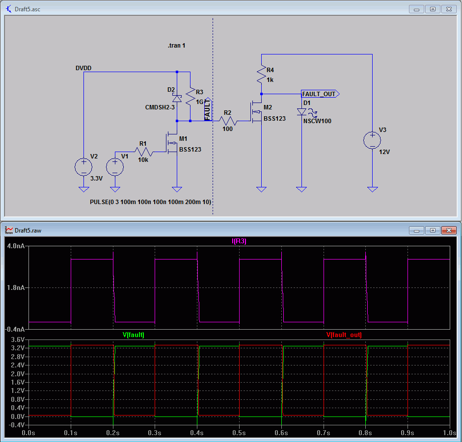

I must correct the above, there are internal pull-ups already (26k).
Beside this you can source some current from the DVDD pin, I.e. if you want to have external pull-ups, as long as current is <9mA to each pin.
Source: TI engineer
Source: TI engineer
