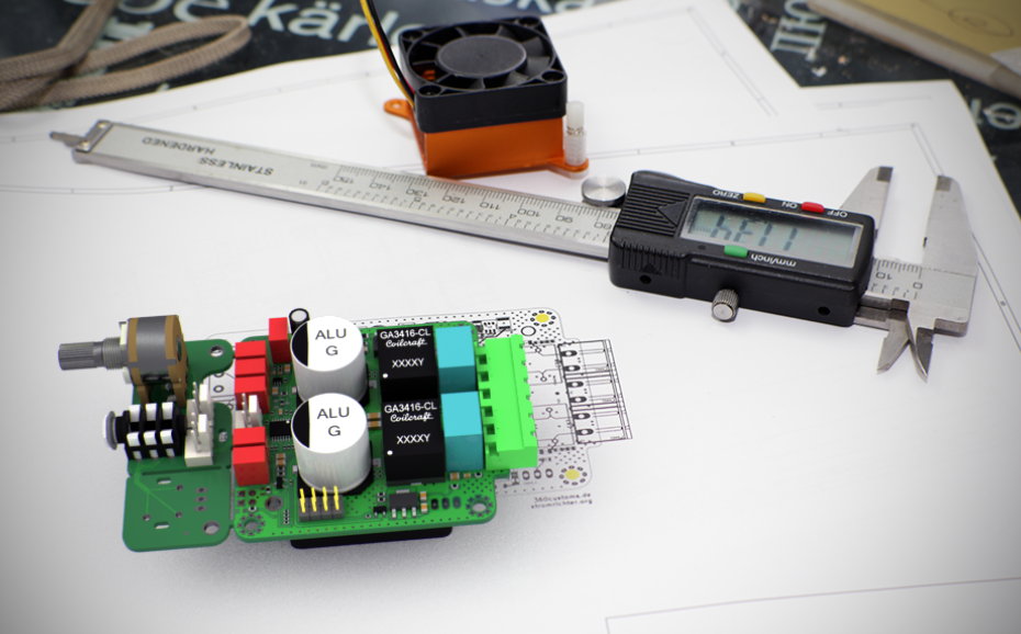

Why does this photo look like a render, or is it a render? Dr Mord's renders are so photo realistic I am not sure what I am looking at anymore. 🙂
Glad to see I'm not alone in noticing how many issues bottom-mounting the TPA3251 solves 🙂 Though even with that trick, squeezing it down to 6x6 cm is quite the impressive feat, especially with inclusion of all the voltage regulation on board. Quite nicely done.
I've been having fun with a slightly different approach given that my aim is multi-channel home theater duty. So size isn't as much of a concern as ensuring that the chip can perform to its peak capabilities, aka larger passive components. (Specifically, the ICE 1D23A inductors and 22.5mm pitch film capacitors on both input and output 1uF spots.) As well, since my intent is for usage in multi-channel I opted for off-board 12V regulation with separate inputs for the VDD and GVDD (could still be tied together of course.) Then for the same reason also included a 12V trigger input in the reset circuit - both allows for putting center/surround modules into reset when just listening to stereo and should ensure reset goes low before there's much of any fluctuation in voltages. Note that I haven't gone through to confirm part values on the schematic just yet, in particular need to get around to actually modeling the reset circuit.

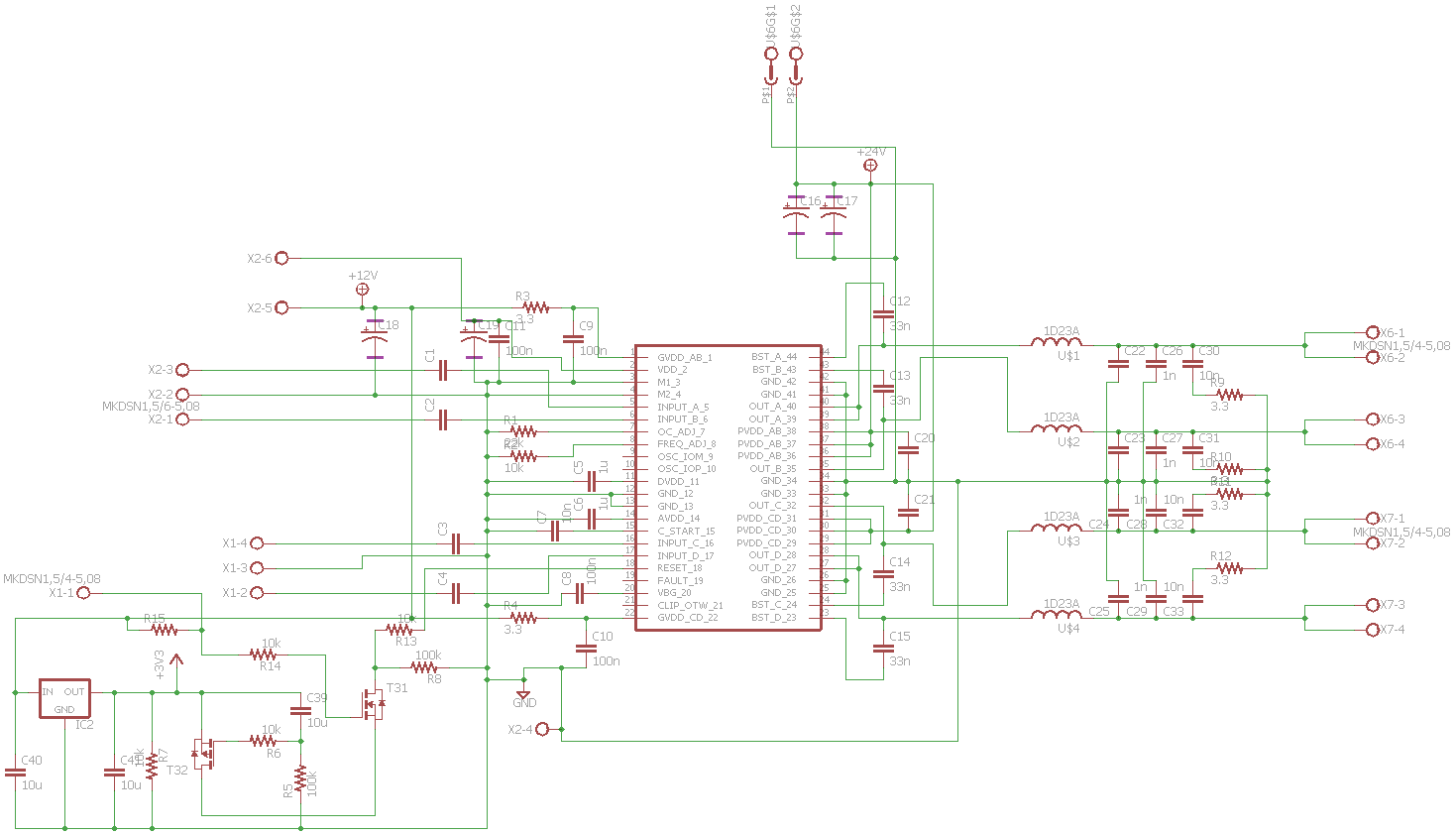

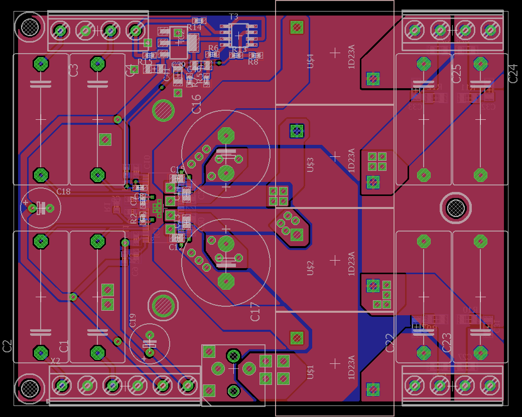

Would say, I will build another small batch 5-10 with this layout, test and characterize them and finally start a group buy maybe or build em just on demand. Alternatively I'll just make the bare pcb available together with a mouser basket for those who want to solder on their own.
Great work!
I'm in for 3 boards, either bare or semi-populated (everything mounted except no output filter).
I suspect that the output filter will attract the most debate, so a semi-populated version might be popular?
Mike

From what I can find on the 'net there are only two companies providing high current Inductors designed for Class D: Ice Components and Coilcraft.
Ice gets a lot of good reviews from people using them, but there is no hard data published by Ice to prove their worthiness. We get Isat & Idc, a footprint and a low price, thats it.
Coilcraft includes a current saturation graph in their datasheet that reveals a flat line all the way to the advertised saturation point, then drops into steep vertical as you would expect from a quality Inductor. They also list THD+N vs voltage/load distortion limits in the datasheet. Thats relevant data.
For sure, the Coilcraft Inductor appears a bit inadequate. But in most real usage cases the GA3416 should be OK, as most of us won't tolerate listening to an amp thats cranked into distortion and/or clipping and the GA3416 should get close to that range at 4R loading. So it looks like we are stuck with a less than desired Inductor for now. 🙁
I agree with Doctormord's decision on this... Until there is enough data published to base a decision on to use the Ice Inductor, I wouldn't risk having it onboard, potentially wasting my time and money on an otherwise exceptional effort.
Adapting the thru-hole Ice to the Coilcraft pads will be no fun task either, so I'm done worrying about it too.

There actually aren't any inductors (afaik) which would fit the board at this current rating. I'd chosen those because of the higher "linear" current over the other coilcraft dual inductors which could handle bit more rms current (temp wise).
Maybe a riser board/adapter would fit other inductors. 🙂
But at first I'm interested in how those puppies perform.
Considering 8.6A Isat 10% would theoretically give 147.87Wrms. (Of course not continuous sine wave due to overheating) So 8R will be fine, <=4R needs some thermal derating and burst mode analysis. As those high power output levels are mainly on the low end of audio increased distortion won't be necessarily a problem as the speakers do distort way more than the output filter.
Eldam, what supply are you referring to? You just plug in your power supply (min 16V, max 36V) and you're all set.

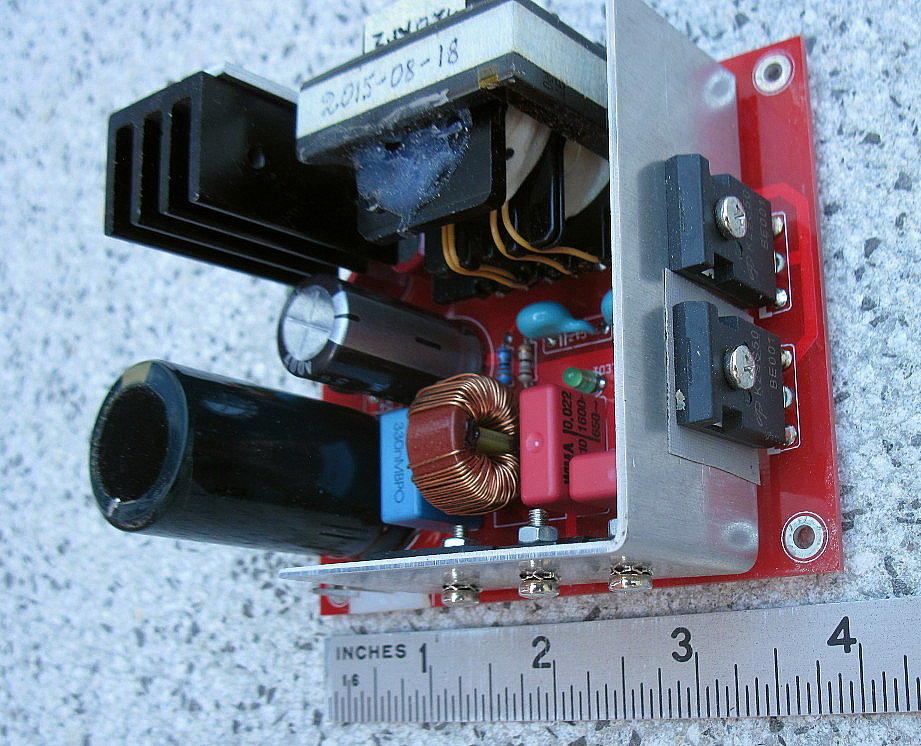

For the LLC converter you better ask "voltwide" directly, he's around on the forum here as well. The controller ic is this one:
http://www.onsemi.com/pub_link/Collateral/NCP1396D.PDF
Step-Ups i actually use for this amp with the mobile PA system is either a TL494 based 150W or a modified version of this one:
10/30/50/100W LED application driver (UC3843A) - #360customs
This one is based on UC3843A.
Both are not made for 350W continous output but handle the amp quite well with normal music program.
