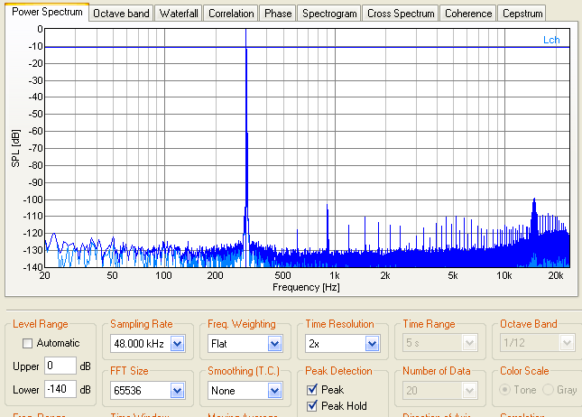

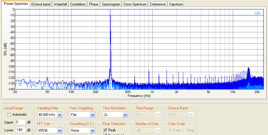

Measurements of my TPA3132D2 implementation with no load and no filter connected:
noname 1uF:
Murata 2u2F:

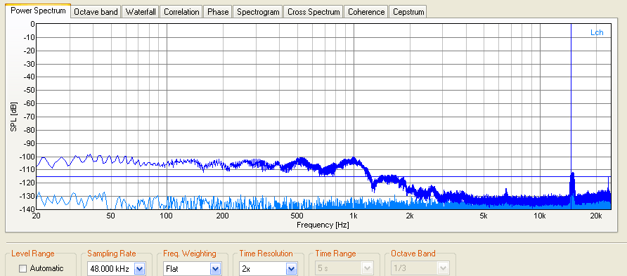

Murata 2u2F knocking sensitivity:

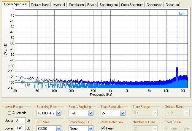

And lastly a DECT phone is dailing, 4cm above the chip, noname 1uF:

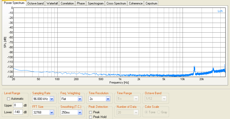

Additionally:
Reference:

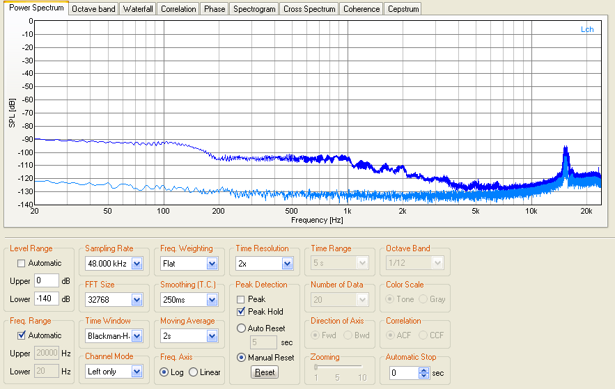

Knocking sensibility comparsion:
1uF noname:
Murata 2u2:

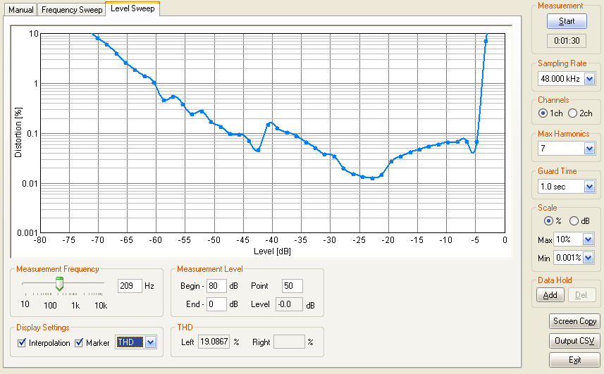

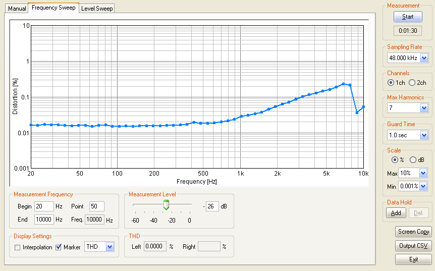

Frequency sweep at 12V, 8R+47uH load, 1uF noname coupling:
Keep in mind, that the datasheet is only showing 30dB, so only the range -35dB - -5dB is relevant.
Pretty much like the datasheet.
If acoustic noise is an issue, Murata offers low-noise MLCCs:
"Murata’s GJ8 series has been specially designed to reduce this problem and is available with capacitance between 1 and 10µF. The acoustic noise generated by 4.7 to 10µF GJ8 series capacitors represents an improvement of at least 10dB over ordinary MLCCs; for 1µF models the improvement is up to 30dB. The series is available in low-profile models with thicknesses of just 1.25, 1.60 or 2.50 mm depending on capacitance. Rated voltage is up to 50V. "
