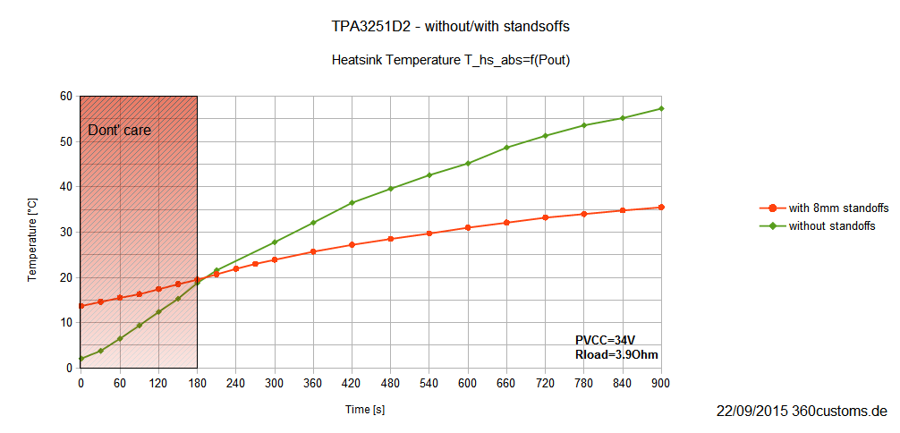

Having 8mm standoffs mounted to the board greatly affects thermal flow (stack effect):

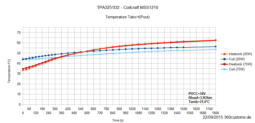

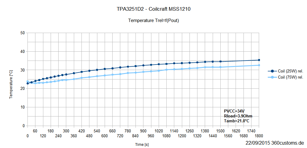

Temperatures within the MSS1210 inductors at different power levels. Actually can't explain why the inductors run cooler on higher Pout (would guess, it's due to the B-H loop hysteresis loss):
