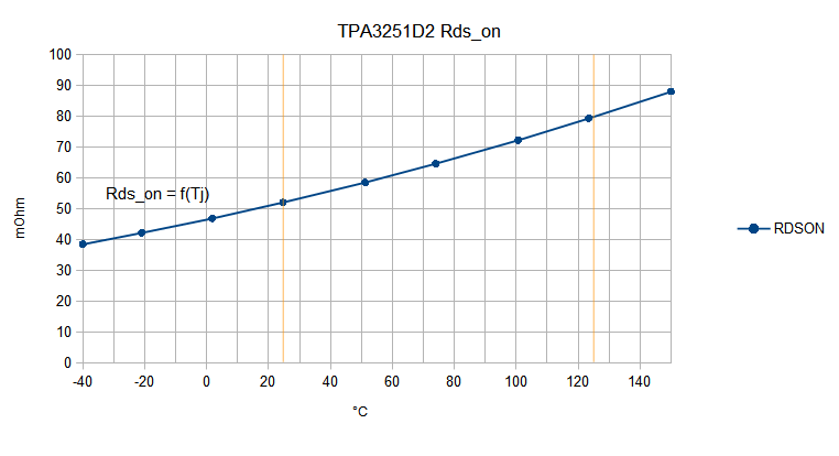

For those who want to know:
attachment.php

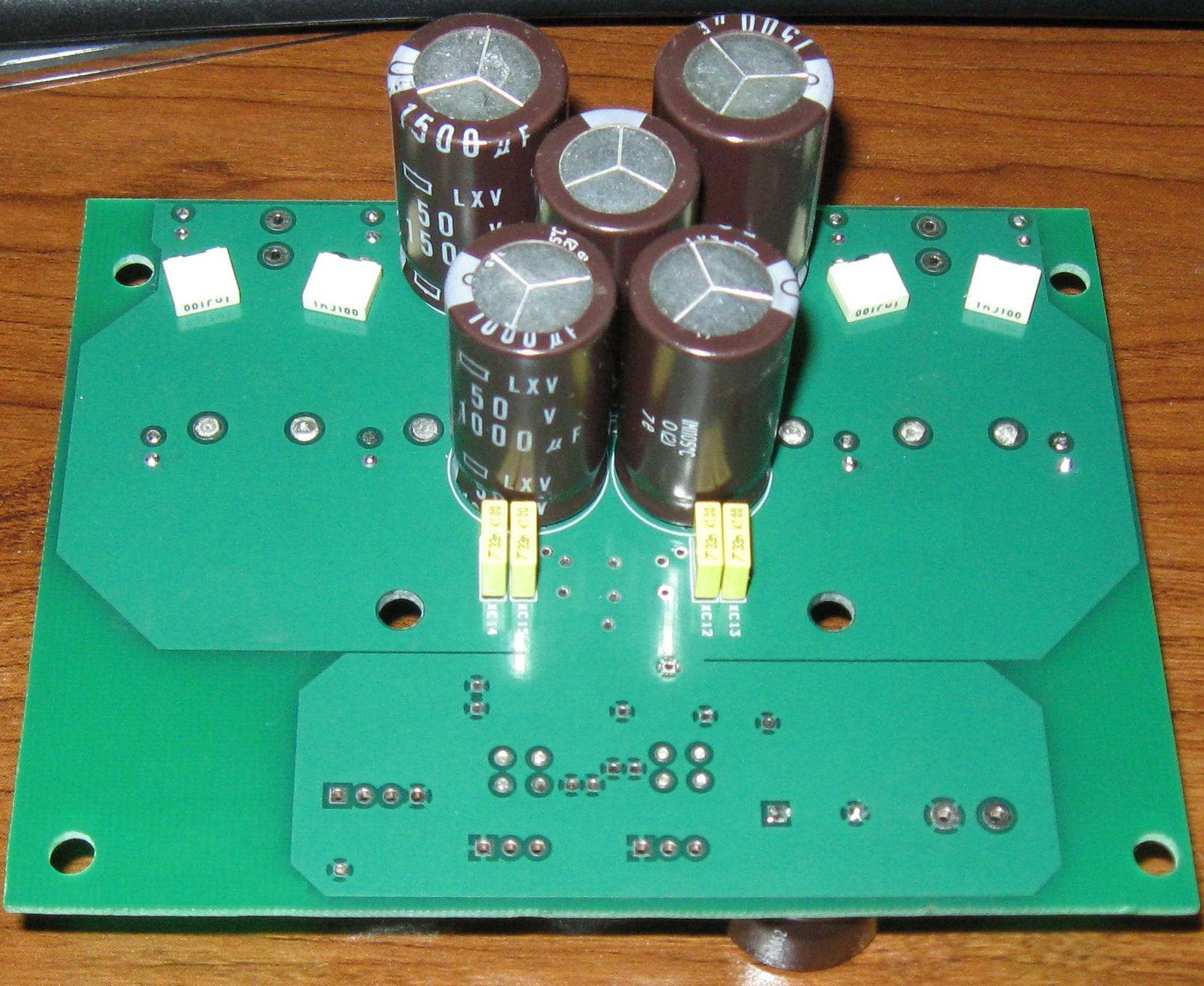

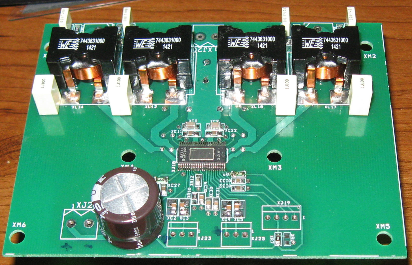

Working on it...Board stuffed except for connectors, just need to ask the machinist at work to do some machining of the heat sink.
