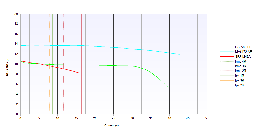

Inductors:
Bourns SRP1245A-100M
XAL8080-103MEB

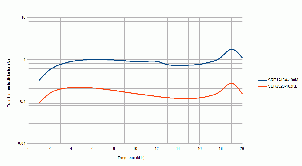

Comparsion between some:

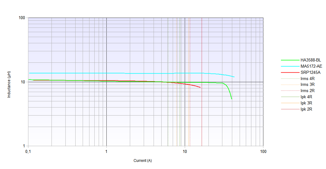

Lin scale:
Log scale:

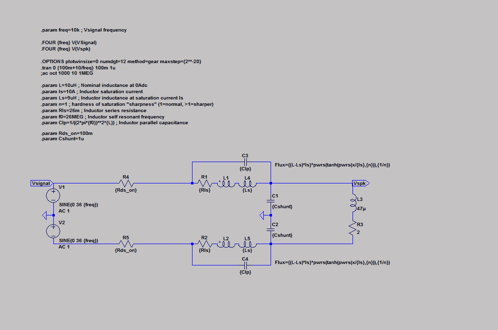

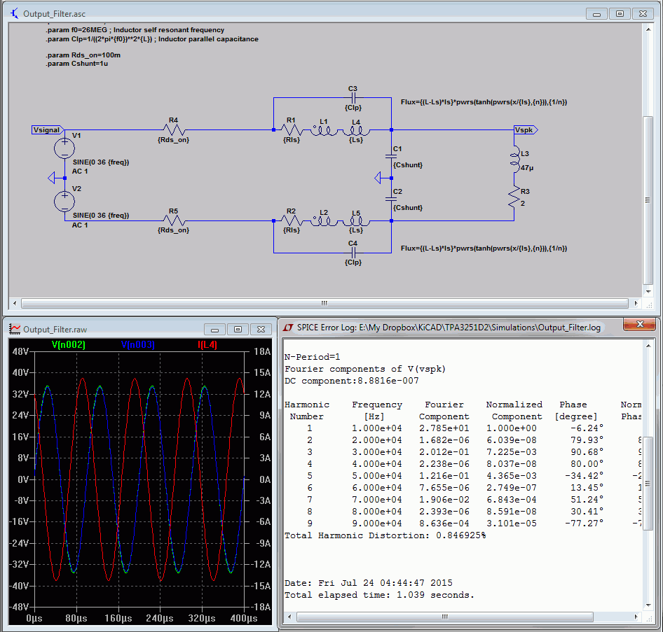

The simulation for the Bourns:
The chart is for full power at 2R load, so 1% inductor THD wont be that bad:
Did another forced cooling test - the amp is putting out ~73Wrms into 3R9 (per channel). So 146Wrms or 206Wp at the moment (continous output 1kHz). Peak performance is still better of course. (Junction temperatur, of course, is always beyond 125°C)

So you're also seeing a rise towards low frequencies of harmonic distortion.
Are you refering to post #341 and Plot #167_12121.png?
The plot is based on simulation results made in LTSpice with only the inductor modell data.

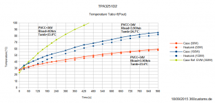

With regards to the excessive chip temperature I can't help but wonder if the thermal interface pad that you are using is partly to blame.
I don't use a pad anymore, the heatsink is connected metall-to-metall with thermal grease only (but is not overmilled at the contacting spot). The excessive chiptemp is not mainly a concern, as the heatsink is going up "straigt" to ~85°C within 10 minutes, so it is supposed to work.
TI state that you should have a good solid electrical connection to PCB ground from the heatsink.
Would guess this is more due to EMV/EMI.

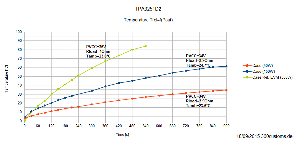

From my conversation with TI i know now, that the 175W/350W where measured in a different way. From the conversation:
The full power testing is done with a forced air system that regulates the power pad temperature to 75C. That provides a constant reference point for comparison, independent of the heatsink used. We actually drill a hole in an external heatsink and embed a thermocouple to monitor Tcase.
Which means, i actually can't reach full continous power neither by convection (with this heatsink) nor by forced cooling. Holding the power pad temperatur at 75°C is really a different story in the way of proper cooling.
But, as said, dynamic full power is possible, tested with 3R9, both channels loaded (even without forced cooling).
Even the EVM isn't capable of running full cont. output for longer periods of time. (seconds/minutes)
Ah that makes more sense.
Wow that's quite something, if completely unrealistic.
Well this is good news and really all that matters.

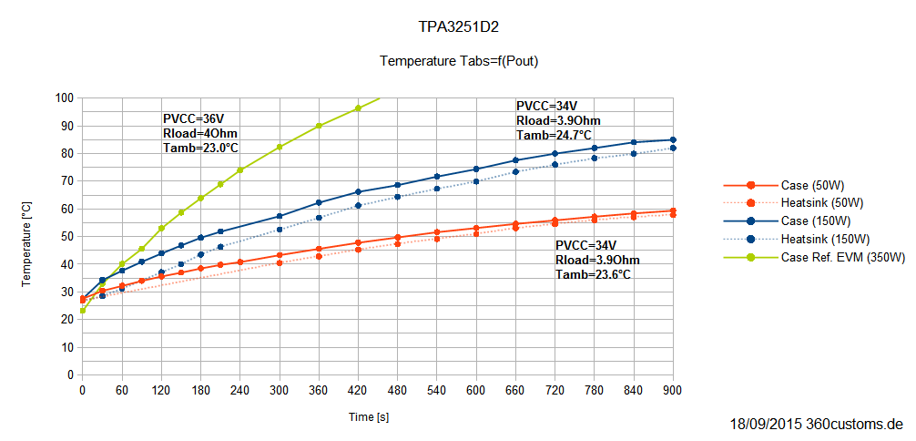

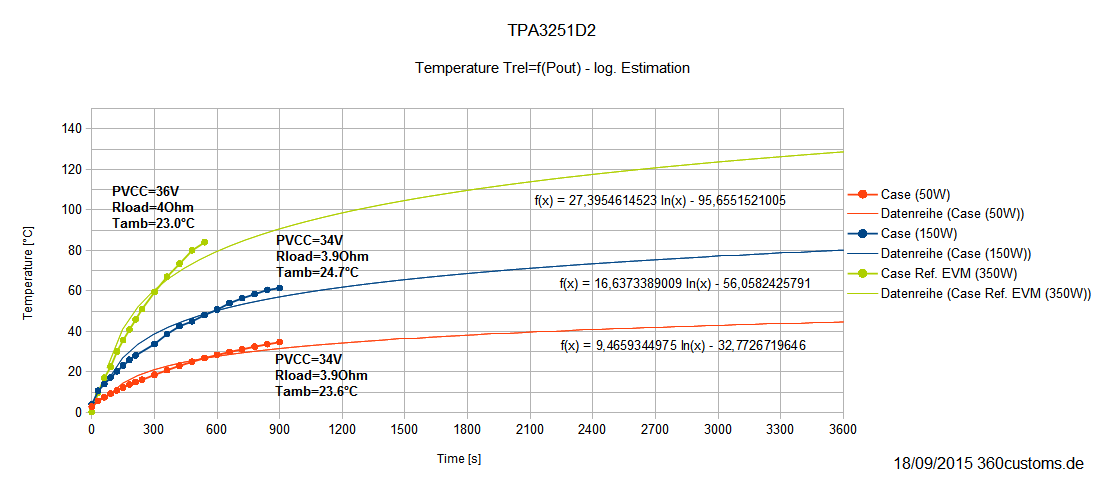

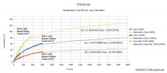

Did another measurement, now with overmilled, plained and pollished heatsink.That heatsink where in no way flat as intended, more like concav.
Tcase is measured at the contacting surface right next the IC, Theatsink is on the surface right obove the IC between the fins. These data is compared to the EVM performance, which i got on request from a super-friendly TI employee. 🙂 (Thanks for that) Case temperature at the EVM is measured with a probe embedded in the heatsink 1mm obove the chip.
I actually can't get above 150W (Prms) as the power supply is limited. First diagram is absolute temperature, second one is relative to ambient temperature.
The measurement shows cleary how important a good thermal connection is with this IC.

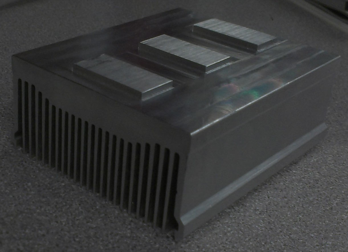

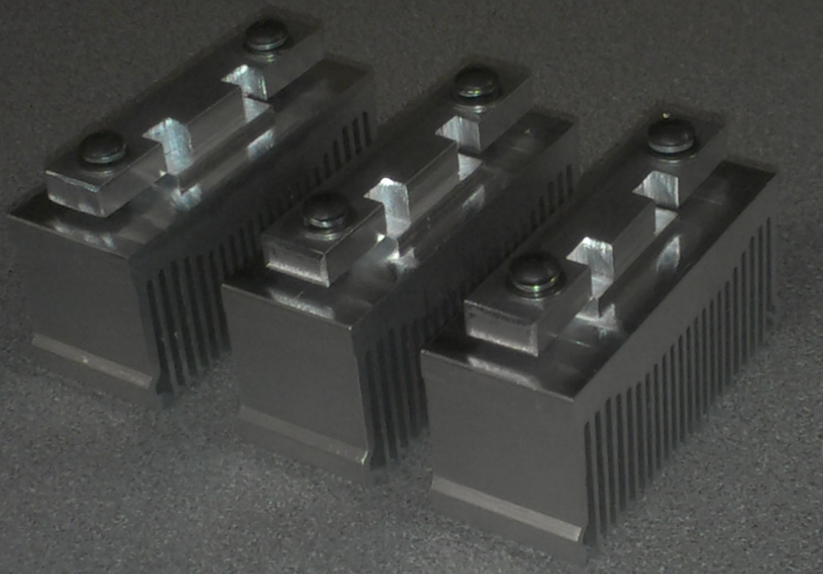

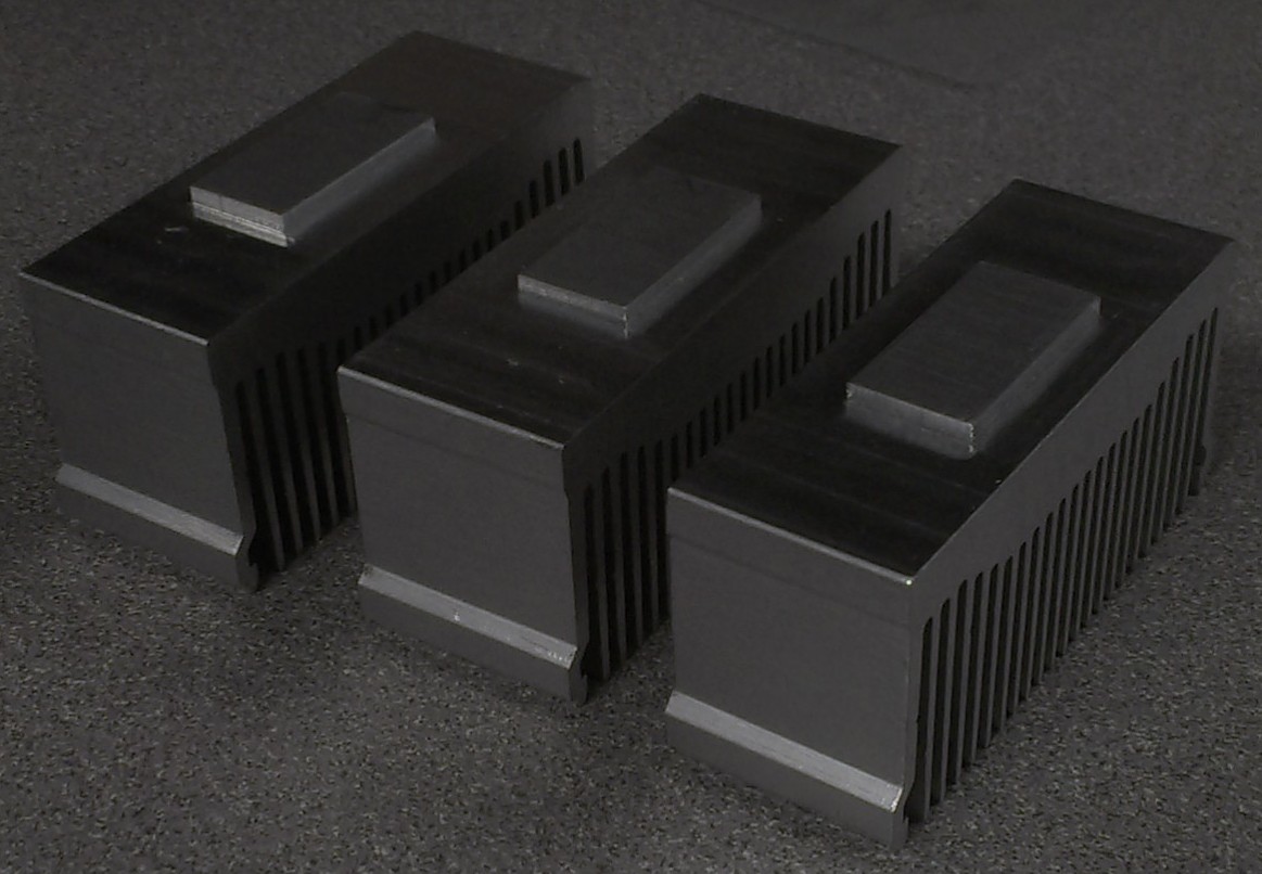

A surplus computer heatsink machined (thanks to machinist at work), then I sliced it and sanded edges.
Then I made the PCB back support (with notches for the bootstrap caps).
Install later today.

Looking really good. To my knowledge, the fin-profile is made for forced cooling rather than convection, so performance might not be optimal in still air as the fins are to close together, so that they heat up each other more than they can convect. Tests will show.
Is the contact surface milled/sanded as well?
