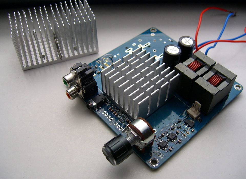

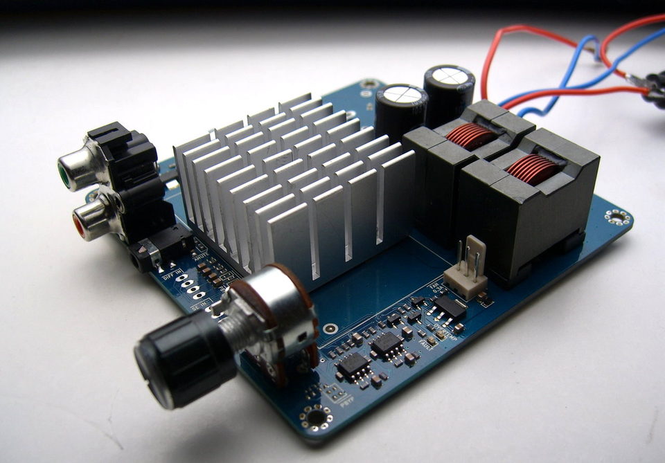

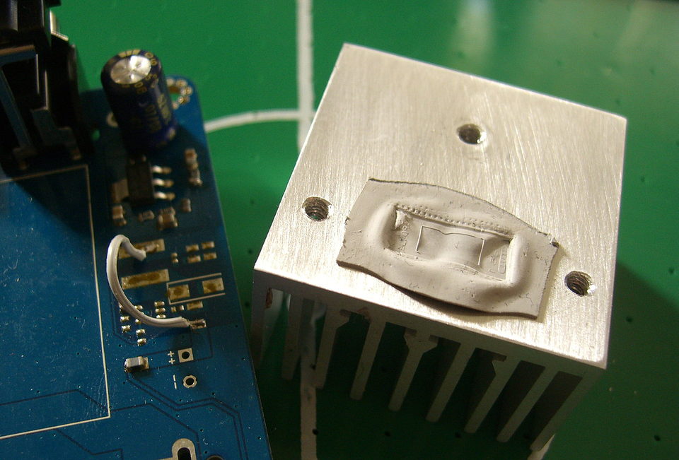

Some pics of the setup.
The initial thermal i used with the smaller heatsink:
The heatsink mounted to the board:
Replaced with the "real" heatsink featuring 3K/W:

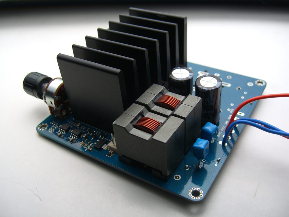

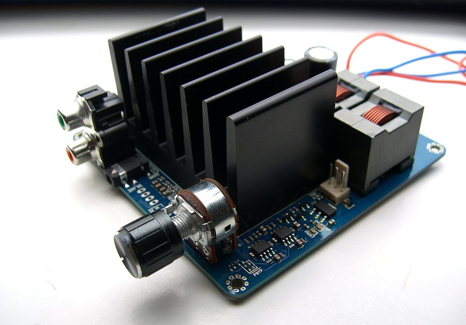

Your renders are getting better and better ;p
These are photos in a lightbox I think - too much gritty detail and bits of dust and blemsishes to be renders.
But if they are indeed renders, wow!
Agreed, and the depth of field / focus falloff is fantastically realistic if a render. Great looking amp either way!
Sent from my iPhone using Tapatalk
Dont really think they're renders, hence the emoticon. But dr Mords renders were so good that the picture and renders really look alike. With a bit better lighting it would be very difficult to extinguish

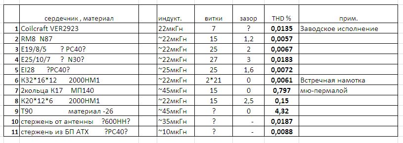

doctormord, it is a pity that you are using VER2923. The distortions introduced by these inducters is 2-3 times higher than the inductor wound on RM8 N87 ferrite.
Source, measurements, link, implementation?
The results of measurements (sorry that in Russian):
Thanks! Don't worry, i had Russian at school. 🙂
Do you have any more information about the test arrangement?
- Class D
- TPA3251d2
