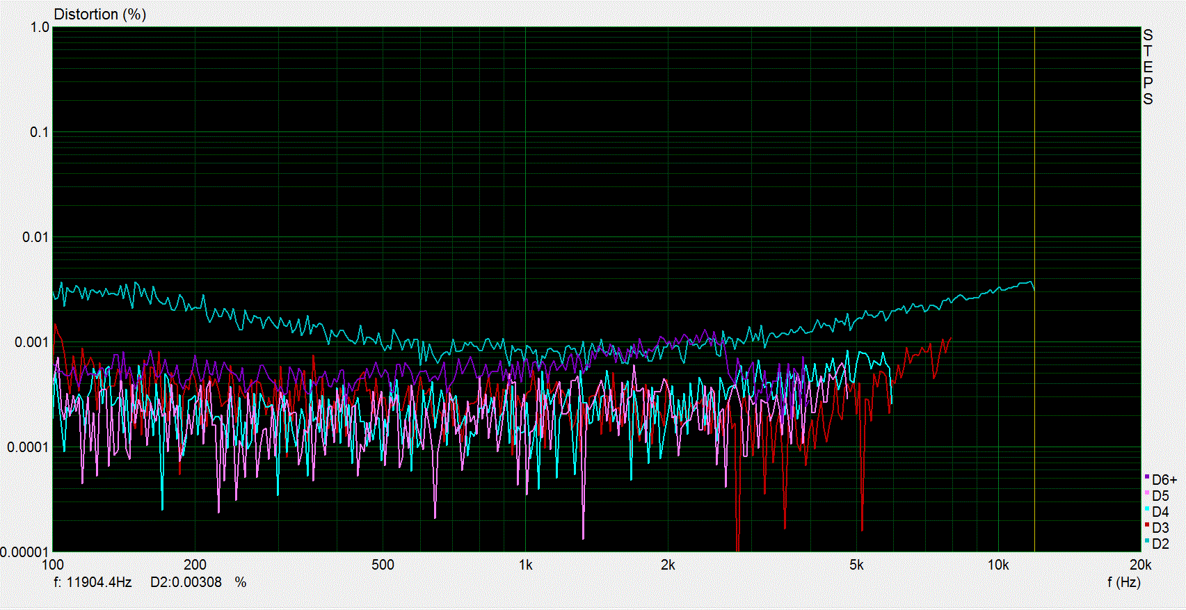

Well right now I am having some trouble with rising 2nd harmonic distortion towards lower frequencies. I don't know what's causing this nor how to eliminate it.
The problem is worse when the amplifier is powered by batteries than a 19v laptop brick. And improves with some large bulk capacitance applied to the rails.
It's present on both channels even with only one channel driving a load, which is odd. I have posted about this on the E2E forums.
This is not a problem at lower output powers and the absolute level of 2nd order distortion is pretty low.
I gave up trouble shooting for the moment as I wanted to listen to something.
Currently I've got them powering the tweeters in my active 4 way and they sound very nice. Nice and smooth.
Here is a preliminary 2.8VRMS into my 9.4 ohm load, albeit with the 2nd order rise.
This is with a 20kHz measurement bandwidth and is most certainly heads and shoulders above any class D amp that TI have ever produced.

5th element, any initial subjective listening comparison / objective performance comparison with other popular class D amps (tripath, hypex)?
It's difficult to say because my only reference systems are completely active so require more than two channels for a decent assessment. This is why the board is built for 4 channel.
My original idea was to build the 4 channels and seee how they perform. If I liked what they did I'd replace one system with the 4 channel board and then possibly replace the 6 channels in my main system with them.
So far I'm using them on the tweeters in my main system and did some critical listening and really liked what I heard. Nothing to complain about at all and I'm really keen to get more channels up and running they sound that nice. Very pleasant top end.
I have hypex ucd400 but those run the subs and my tpa3118 builds are incorporated into other systems.
Thanks 5th element - a well implemented amp is hard to tell from another well implemented amp. Regardless the TPA3251 sounds promising (pun intended!).
