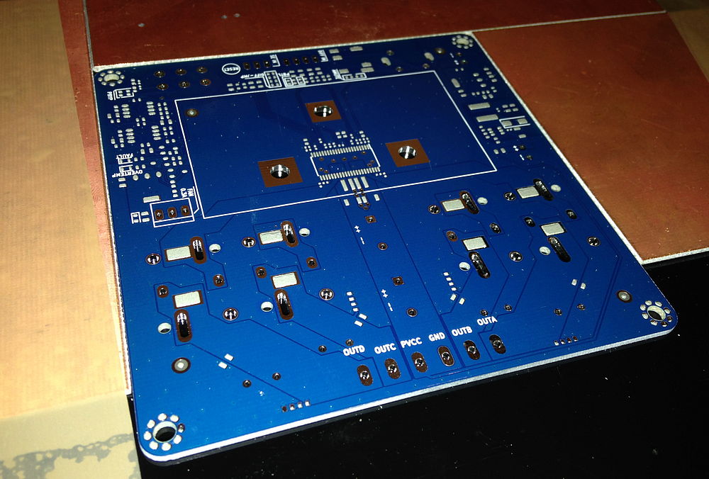

Is it a good SE to Diff PCB ? ( link below )That's ridiculous. 😀
Edit: PCBs arrived. 😀

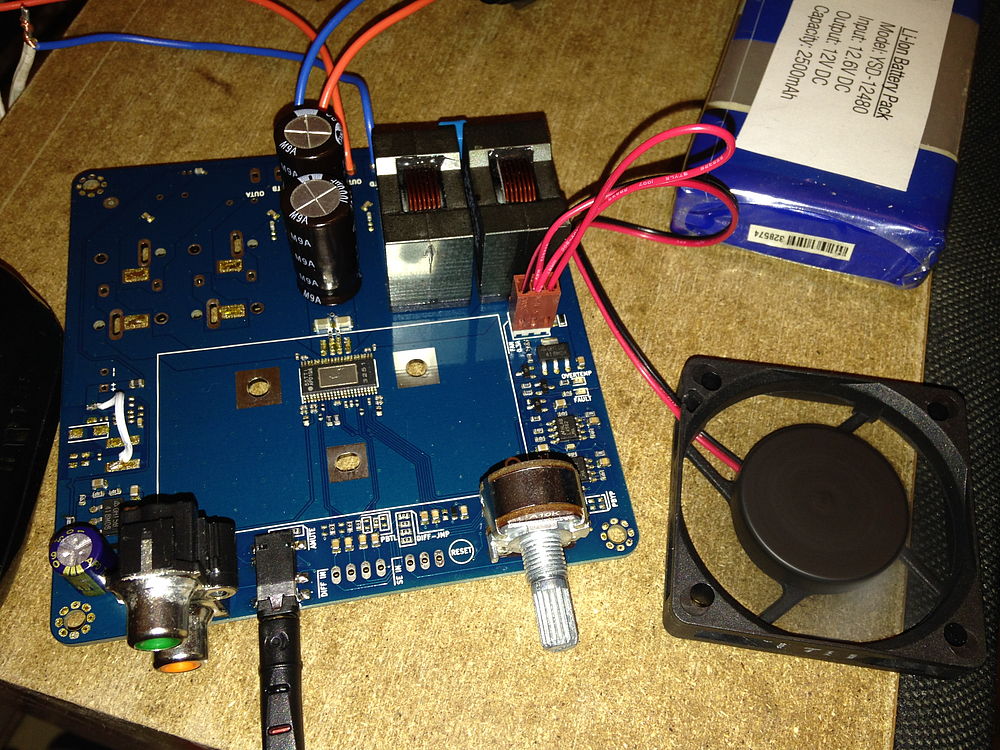

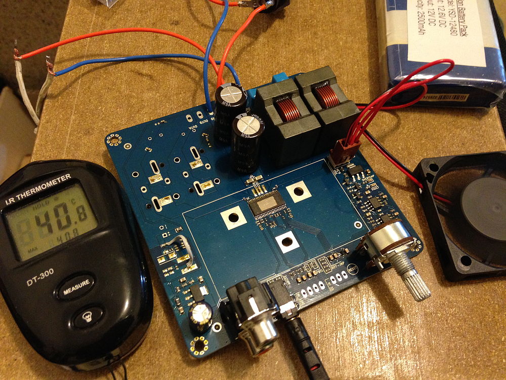

It's alive, actually in a "worst case" setup.
This means:
- noname Low-ESR-Caps
- no Step-Down-Converter (PVDD linked to linear regulators, so actually 18V max)
- X5R high-capacity MLCCs
- LM4562 opamps (the good ones)
- no EMI-snubbers
- no 0612 100nF direct decoupling
Things only can get better.
It works without heatsink at moderate levels, gain-stage and amp are dead-silent, really. It's actually "no-noise". Fault/Overtemp works, 2-stage fan works, no power-on-plop but power-off-plop when not muted. Setup is one-channel-only at the moment, other channel will get different inductors. Heatsink is getting done next. Power-in is fused at 6.3A fast.
All in all, success! 😀

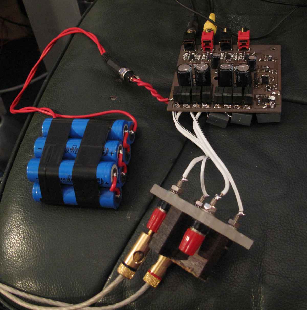

Thanks to doc's generosity, by providing me with one of his samples, I now have two of my channels up and running. The chip arrived early on this morning.
The pictures aren't fantastic as the lighting here is pretty dire, nevertheless have some pics.
I am currently running these from 7 Li-ion cells in series, giving about 26 volts. The high efficiency of these chips allows battery operation without needing vast amounts of capacity. If these pan out I will add in 2 more cells to bump the voltage up to around 36 volts and implement a charger that keeps things topped off when the amps aren't in use.
As doc says these do run cool, the idle losses are no joke, you can use these without a heat sink at low power levels. They are also quiet. Quieter than the TAS5630 that I have used in the past. This was one of my concerns as you need low noise for use with higher efficiency loudspeakers.
Measurements will hopefully be coming up in the not too distant future.
those Li 18650 unprotected cells. what's your charging strategy?
FWIW series batteries the cell balancing may be an issue if not using matched* cells.
*same make, same date codes, and shared life history. or can simply go out of whack as they age >check each cell
really cant stress this enough guys for safety always fuse a battery!
the wires maybe red hot and smoking so you cant turn it off
Yep these are unprotected 18650s harvested them out of a dead Dell laptop replacement battery a couple of weeks ago.
Cell balancing was something I was concerned about but as these are identical I'd be surprised if it would cause a problem.
I was going to use a constant current/constant voltage, dual control loop, switching regulator from LT in combination with a micro controller for battery monitoring.
