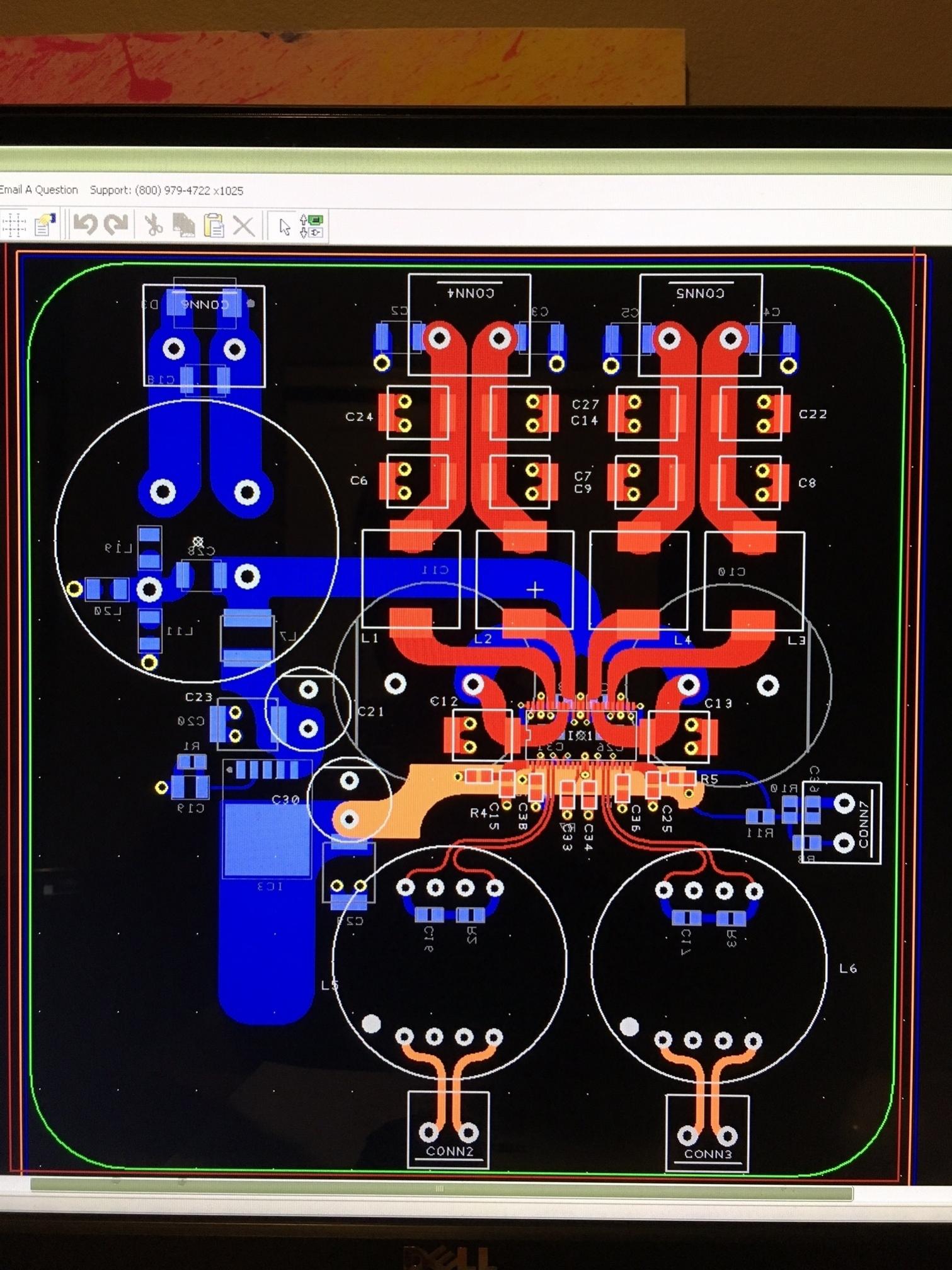

Would it be of interest to test yet another layout? So I would send you one of my PCBs with all the "special" parts (buck ic, inductor, ferrites) included.
(Actual got 2x3000uF on board, capable of 2x4.5A ripple)
Can do doc but all my TPA3251s are already soldered in place and are in use. I would rather not desolder any and risk destroying one. TI were kind enough to supply me with some preproduction models to try and solve the rising THD issue as they apparently weren't aware of it either.

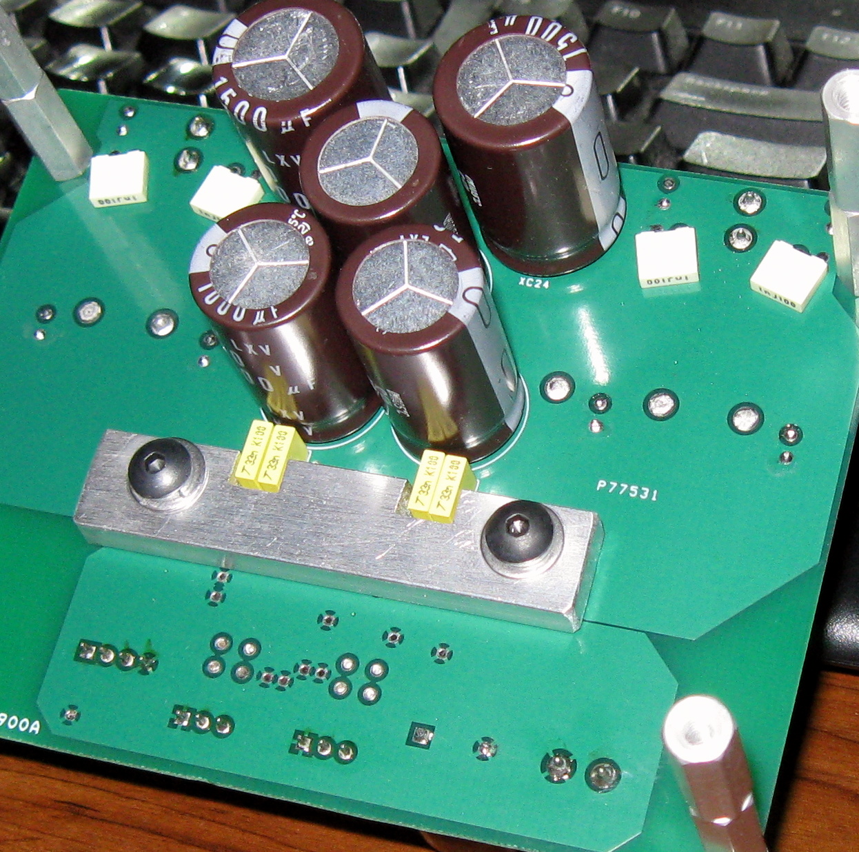

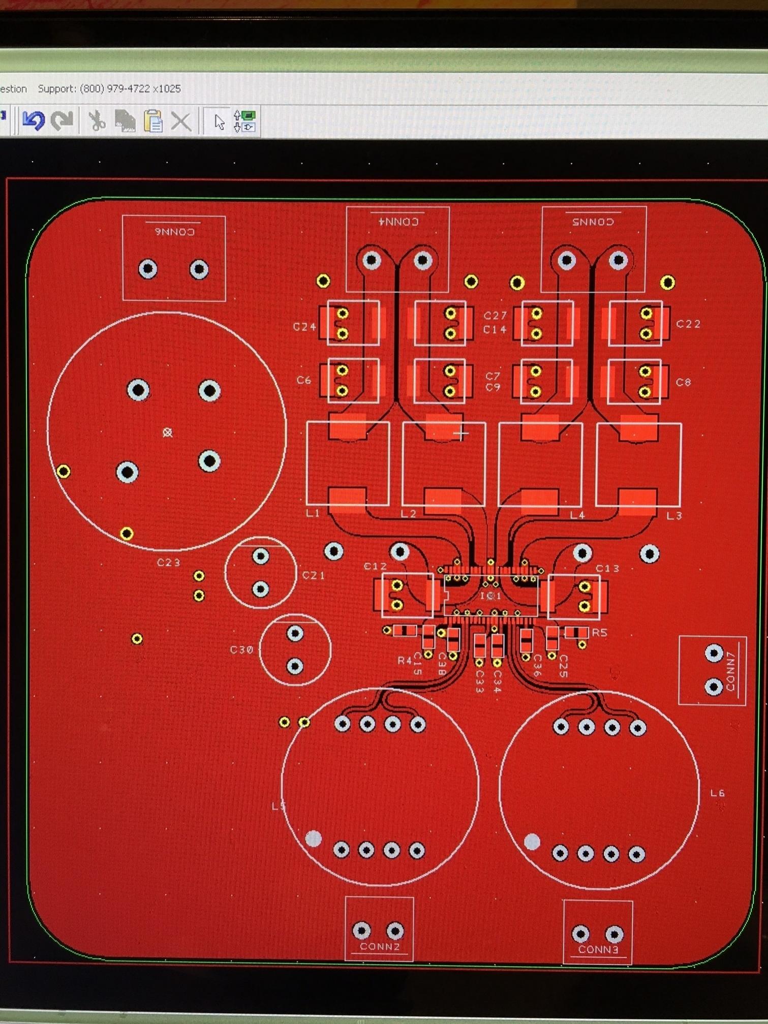

I plan on operating this chip @ 15V. I will be using 10uh Wurth PD XXL , Mundorf caps, Wima PPS, Jensen Transformers, Linear LTC3083, and the Sanken HWB 60W.
110mm x 115mm 4-layer 2oz HR-370 PCB
7447709100 Wurth Electronics Inc | 732-1241-1-ND | DigiKey
http://cds.linear.com/docs/en/datasheet/3083fa.pdf
http://www.jensen-transformers.com/wp-content/uploads/2014/08/jt-11p-1hpc.pdf
http://www.wima.com/EN/WIMA_SMD_PPS.pdf
HWB060S-15 Sanken | HWB060S-15-ND | DigiKey
the pcb is based on the tpa3251d2. digikey is stating availability in mid Nov. i like using the Mundorf 4-pole as a filter. i am using 25mm 40v 10,000uf caps to feed the chip. i am open to suggestions ?

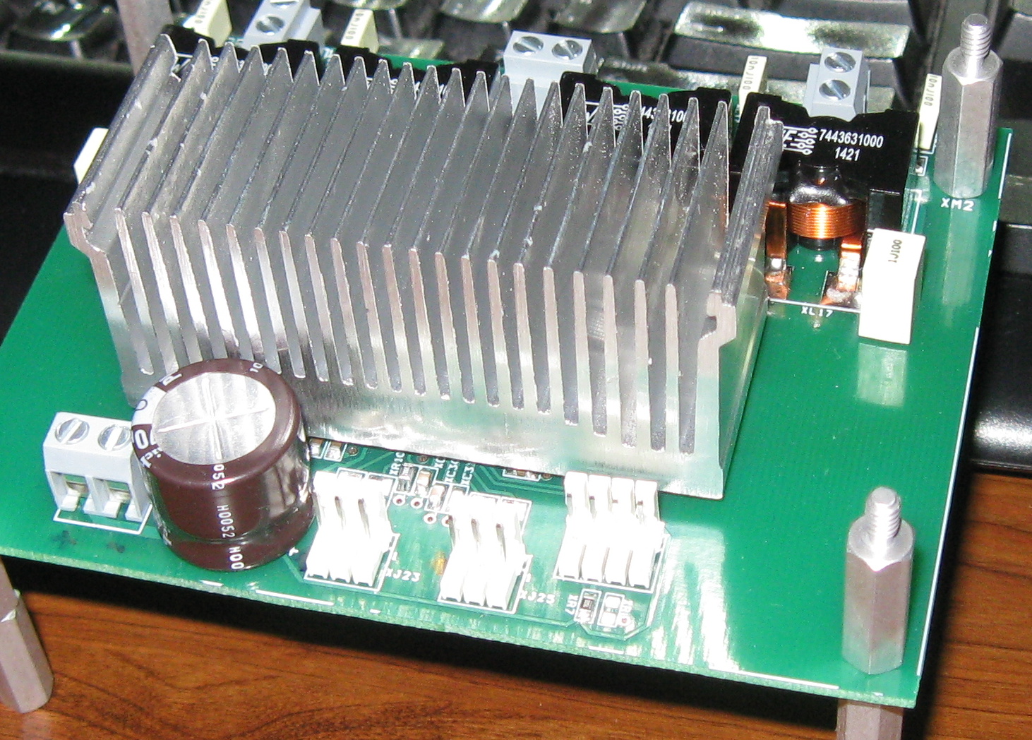

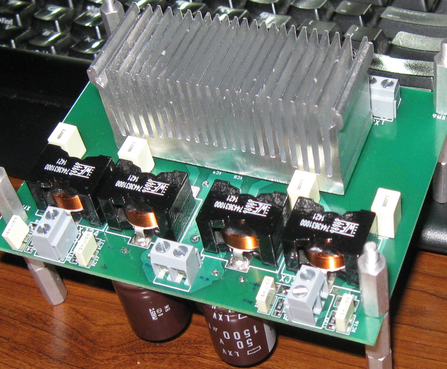

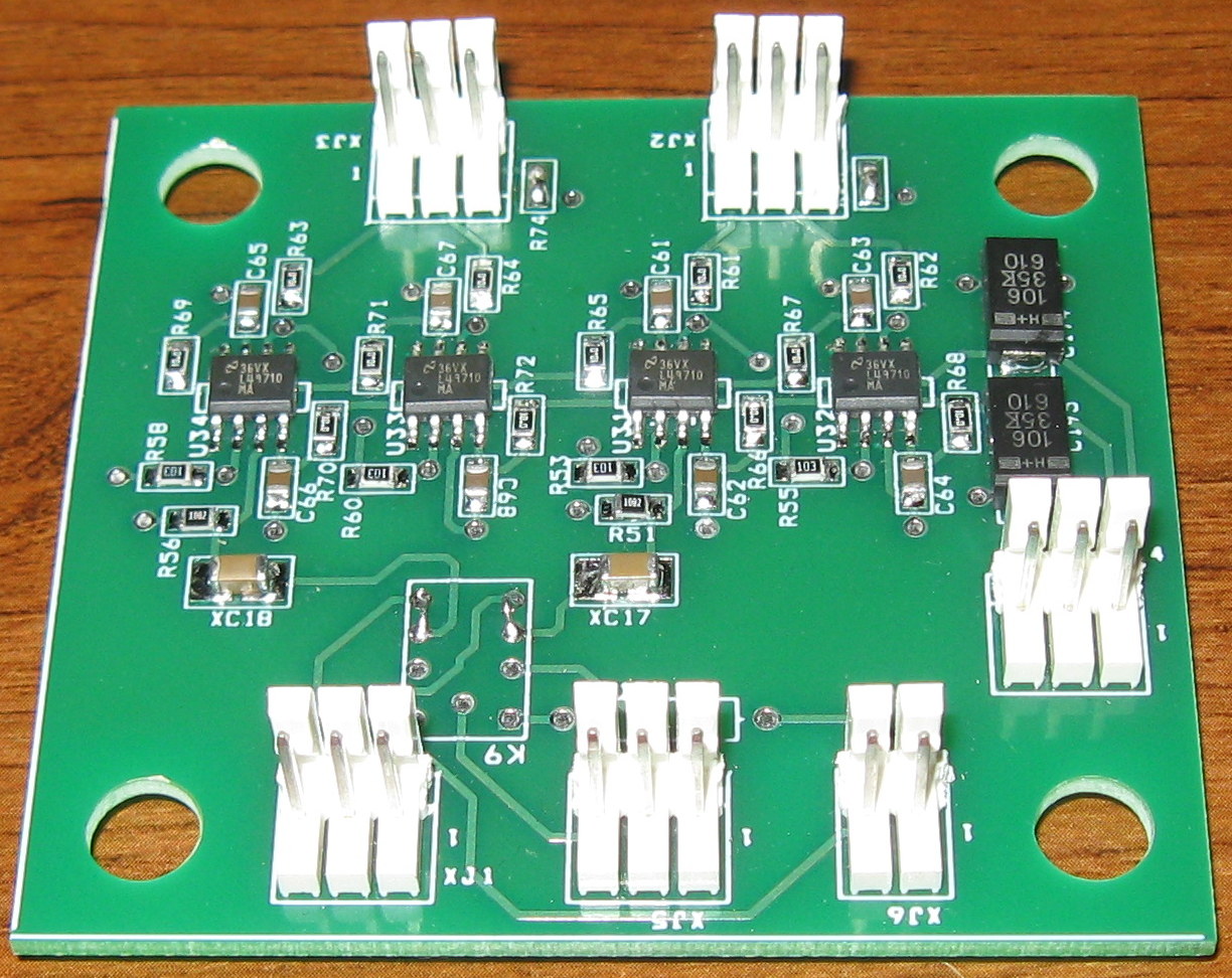

Pixs of board with heat sink and SE to diff amp.
That's what I thought 😀
I hope you can measure the system to make sure they aren't affecting the performance!

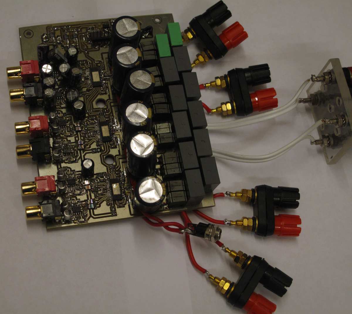

6 channel version.
This lets me use the TPA3251 in my main system on the three main drivers. It sounds excellent. 😀
Do you have crossovers between the amplifier and the drivers? If not, you might want to try eliminating the output filter from the amplifier, as per the TI whitepaper on eliminating the Class-D output filter.
I've done this on my TAS5548/TAS5614 amplifiers, works great.
