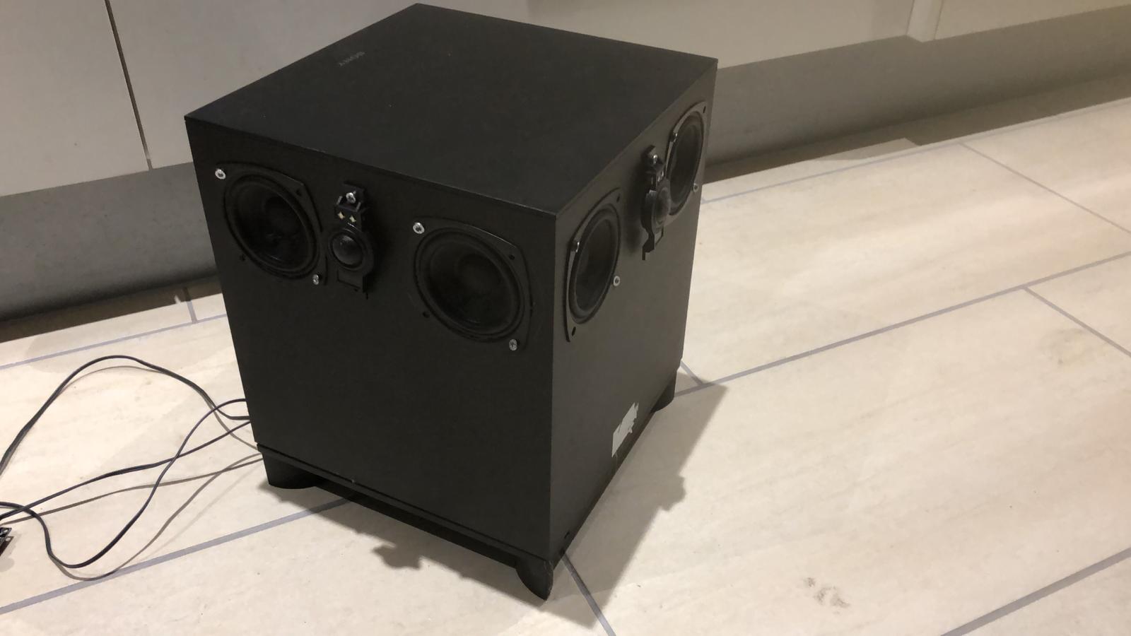

hello
i made today another portable musicbox.
An old sony homecinema subwoofer with LG speakers.
Amp is dual TPA3116. One for the bass and one for the highs.
Always same problem. When getting louder amp stops playing.
I made a video with the problem.
And some pictures from the finished box.
Each side has 2 mediums, 1 tweeter and a crossover
Total 13 drivers :)

It seems your power supply, an SMPS "brick"?, is powering the board directly. The board has only two decoupling capacitors (1000uF?) and that means the supply voltage may swing a lot such that the UV or OV protections are activated and causes the amplifier to disable for a period (self-clearing).
Looks good.

I added two 3300uF decoupling caps. Change supply. 19V Notebook PSU and 18V9Ah battery pack. Always amp shuts down.
I have with all tpa3116 this problem.
I will test tda7498 or STA326/STA508. But I'm not sure if it would help.
On the other side I have some powerful IRS2092 but the need symmetrical supplying. For portable use not good.
