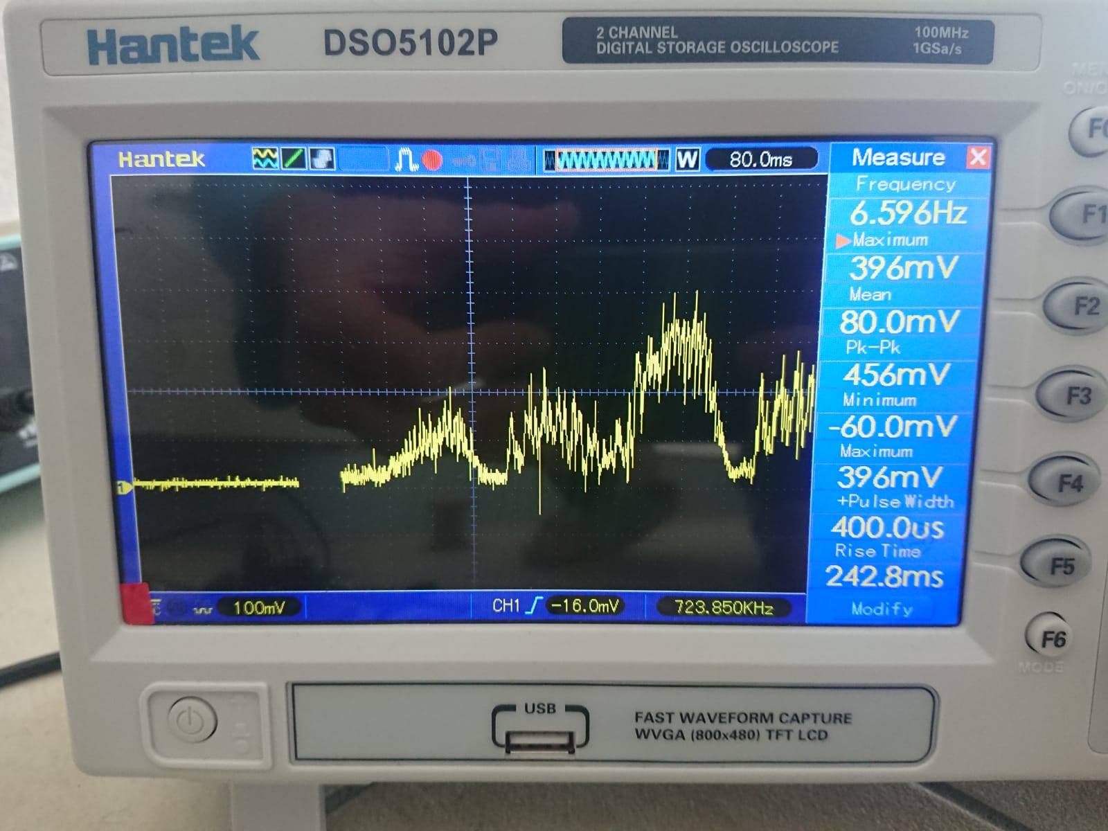

So I tested the TPA3116 and put a 0.22uF capacitor on the shunt.
I have high peaks. You can see when bass comes and when amp shuts down.

its the hole amplifier. The amplifier has 2x3300uF and stock 2x2200uF capacitor.
Powersupply is Lithiumbattery. So no ground problems. Battery can handle more than 18A permanent and BMS has 50A peak shutdown. So no problem with that part.
I thing some times the amp gets higher peaks but dificult do save them^^

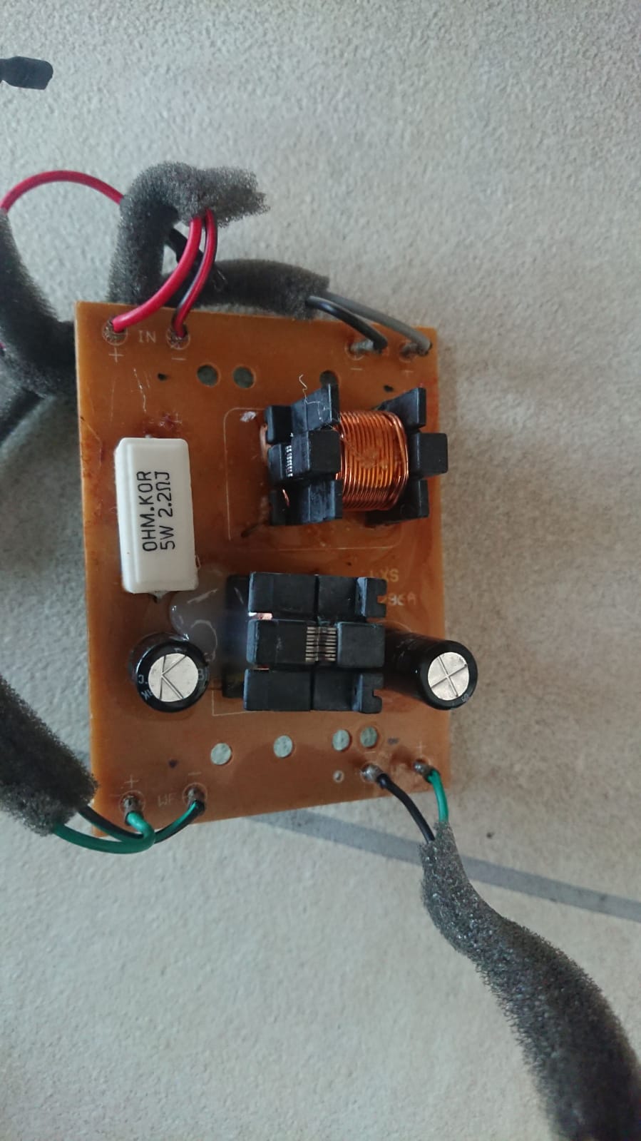

Hi Hans,
I think I know what your 3116 Problem is. You take a passive x-over and bi-amp it.
Because of the high pass beeing separated by a capacitor, the amp has no load in the lower frequncy region. The 3116 does not like it to be driven into a virtually open output. To verify this, just try putting a (rough guess) 12-20 ohm resistor at the output of the amp driving the tweeter, then connect the x-over and tweeter.
To get around this problem, use an active cross over and remove the x-over.
Lege einfach einen 12-20 Ohm Widerstand über + und - des Hochtonverstärkers, damit der Chip einen ohmsche Last hat, für die niedrigen Frequenzen. Es reicht für einen Versuch ein kleiner Widerstand, mehr, als das der Widerstand nach kurzer Zeit durchbrennt, kann nicht passieren.
Hi Turbo
Thanks for you reply.
I have Crossover with coil and capacitor for medium and tweeter. So is this the problem? Four pieces are inside the woofer.
Same problem also with TOA SL-152, JBL Control 5 and Cabasse ....
Thanks for the german part :)

I planed to use these D-amps for a bi-amped "active-passive frequency divided" box too and fell over this problem. I use DSP´s now, as they are cheaper than any decend passive x-over components anyway.
As far as I have experienced, it is no good idea to put a capacitor in line with the load of these chip amps. Up to the cross over frequency of capacitor/ load resistor combination the amp sees an open output (the load decreses with frequency). Which might /will trigger the overload circuit of the chip, if low frequency´s are played or even destroy it.
It is usualy a special feature of an amp, if it can drive a pure capacitive load.
A possible solution:
For example, if a 30 ohm load would satisfy the 3116´s amps output, in extreme this would be about 7 watt´s "burned" in a parallel resistor, which would make a 5 watt item enough for music, even played very loud.
Also, praktisch einen Kondensator in Reihe mit einem Lastwiderstand an den Ausgang des Verstärkers klemmen, bedeutet das mit sinkender Frequenz der Widerstand verschwindet. Der 3116 mag einen offenen Ausgang gar nicht, manche brennen dann sofort durch. Früher gab es jede Menge Transistorverstärker, die das auch machten, war natürlich blöde. Die Frage ist jetzt für Dich, reicht vielleicht ein 30 Ohm Widerstand, der im Bass nur ganz wenig Strom in Wärme umwandelt oder sogar ein noch höherer Wert, damit die Ausgänge zufrieden sind. Schau, bei 3 Ohm 70 Watt bedeutet bei 30 Ohm 7 Watt Leistung. Sollten also 30 Ohm reichen, wäre ein 5 Watt Widerstand sicherlich im Betrieb völlig ausreichend. Ich bekomme böse Schimpfe wenn ich nur Deutsch schreibe, zu recht in einem englischen Forum, finde ich.
