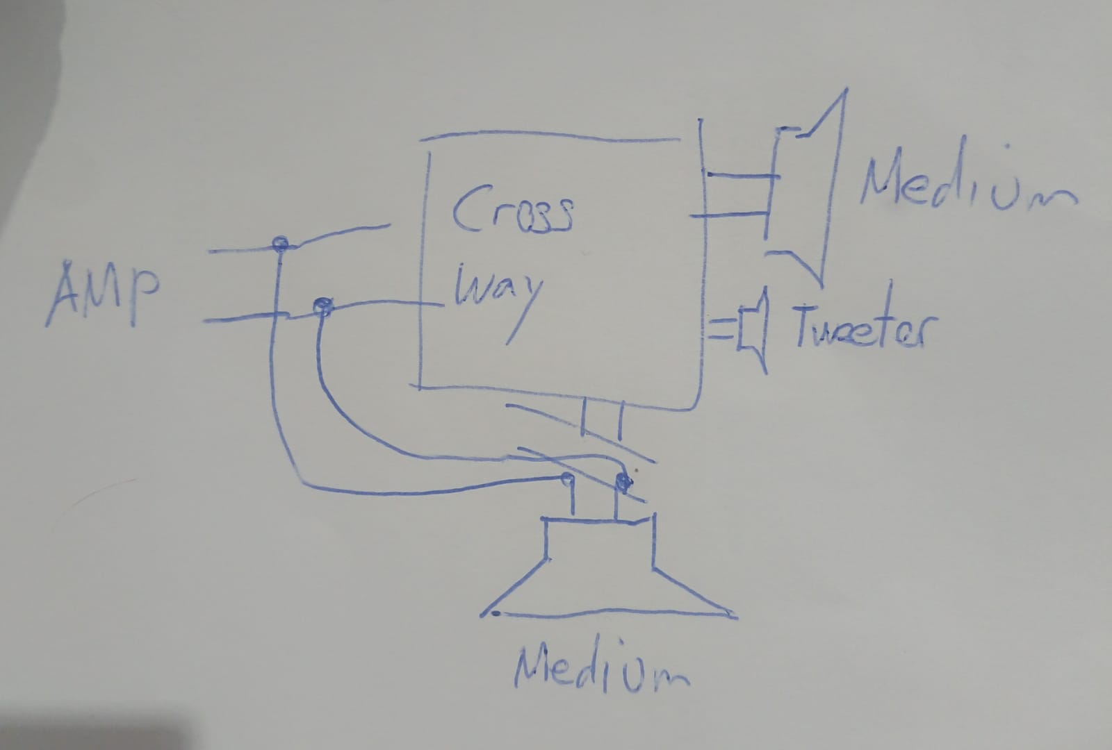

So could this be the solution?
Instead of drive both medium chassis from the crossway I can plug one direct to the amps output?
But I have also the problem when I drive only the sub chassis. This is direct connected to the amps output with no crossway or something like that.

What you propose should be much better.
If possible, try for a moment to connect one mid-tone driver directly (without cross-over) to each of the outputs of the TPA3116. Add the bass driver directly on the sub-channel. Any cut-outs?
A TPA3116 and a TAS5611 can react very differently to a partly insufficient loading.
You can leave a class AB amplifier playing without a load. For a class D amplifier, no load may destroy the amplifier.
You have two problems. First, load the D-amp in a way that does not trigger it´s protection or destroy it.
Second, keep the undesired (sub driver) or harmfull (midd/high) frequency away from the speakers.
You can not use the midd high driver without x-over, as it will distort and burn at relative low level.

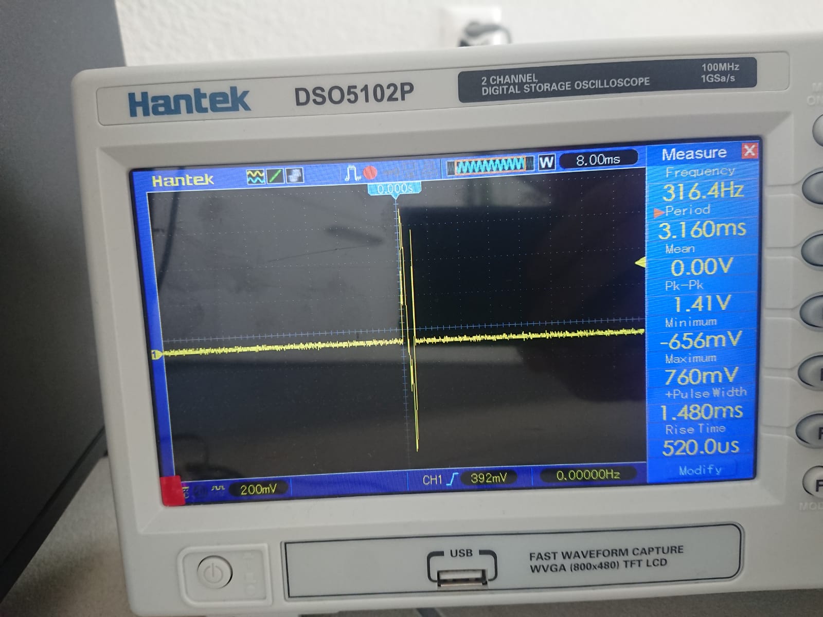

So I made mesurement one channel medium/tweeter.
the peak is between two shutdowns 🙂
If it is still current with your 100mOhm shunt resistor it looks dramatic.

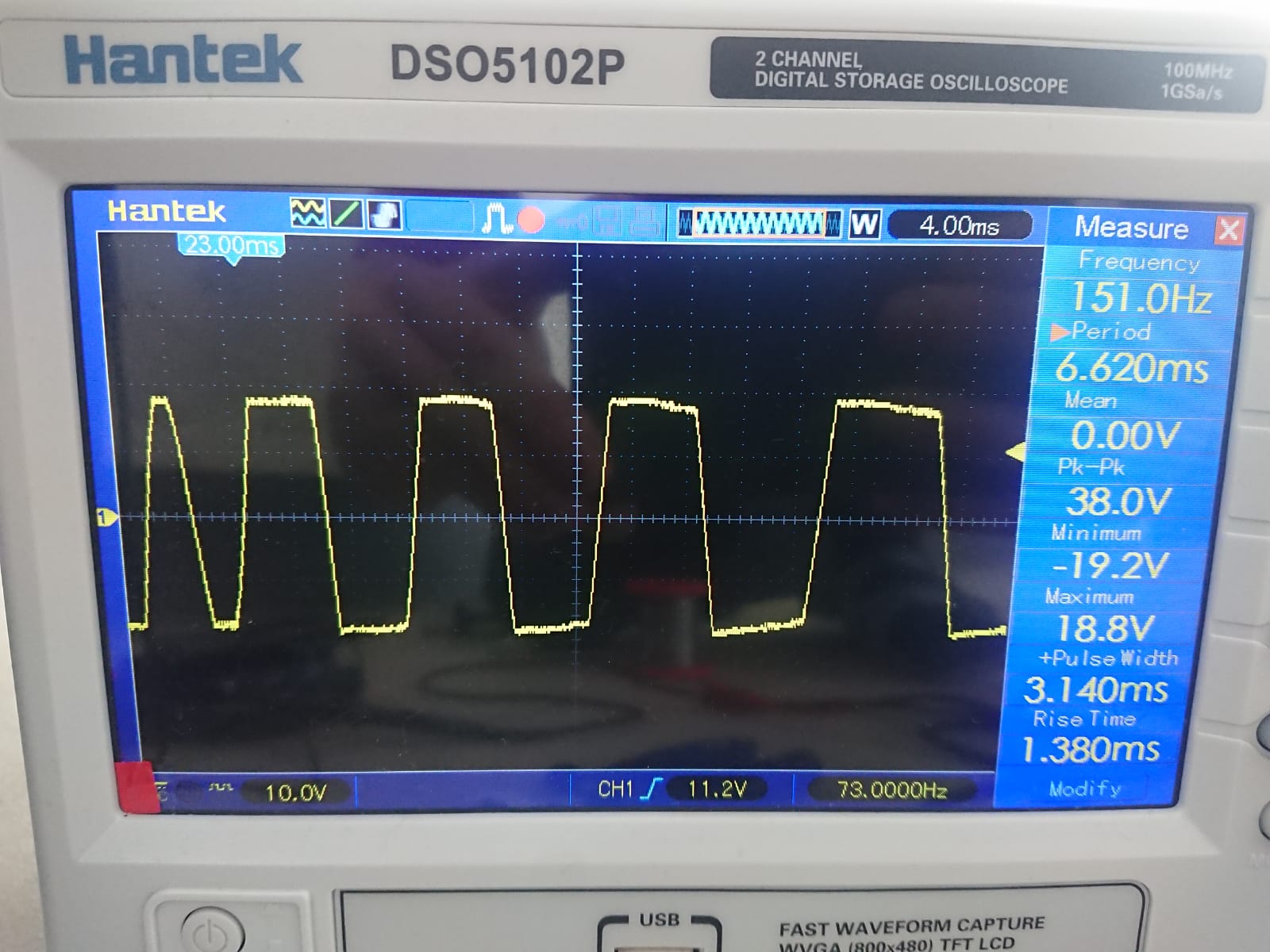

I assume what we see is a variable frequency signal on the sub-channel with so powerful a signal that the amplifier saturates. Correct?
Could we please have the same output with 100Hz fixed frequency and the signal reduced so there is no saturation?

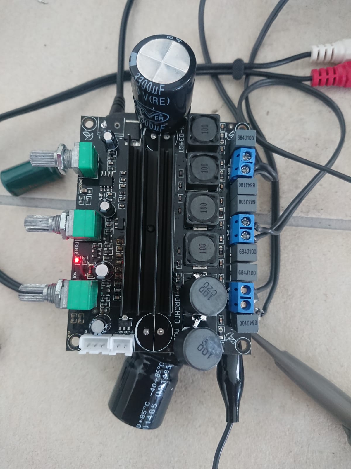

Uhm, I broke the trace of R2 tinkering with other things, trough hole components soldered to smd into so little space is a nightmare. I can't find another spot to solder to. In the photo is the 473 resistor under the green circled one.
Maybe I'm ready to buy a better pcb...

Hot air rework station is an absolute necessity for this kind of repair work. And set properly it will not damage anything as the air is below soldering iron tip temperatures even. Oh and a jar of flux and ceramic tipped tweezers too...Working with SMD PCBs is a challenge and when the PCB-traces and pads start getting ruined it is a nightmare to repair.
Well, I have evertithing I need and I'm not new to this kind of things, but my problem was differend, I overturned the third hand on the pcd and it did hit the resistor who was a little tall and already soldered on the smd spot, ripping them off 🙁

I made a video with 100Hz sinewave.
Many thanks, Hansueli,
It shows that this amplifier channel works. Clipping a bit above 15V (a bit early with a 19V supply or you use the battery?) and not very pretty clipping (not a flat horizontal level) but at least the amplifier does not shut down. The amplitude is varying but I believe to see as a reflection in the scope-screen that you are turning the potentiometer?
If you put an Ohm-meter on the speaker you used for this channel, what value do you get?
