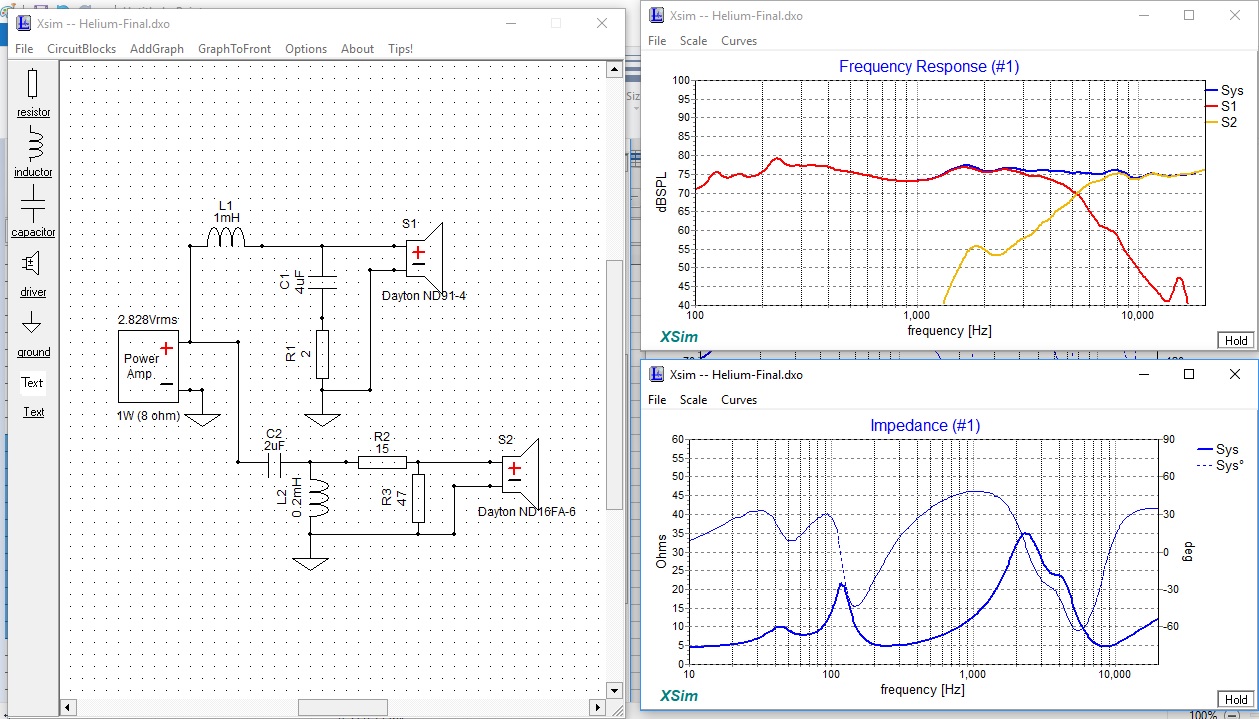

I have a speaker design sorted, based on Scotts' Helium Micro’s.
The original Helium project uses 2x Dayton ND16 6ohm tweeter & 2x ND91 4ohm woofer, according to Scott this would be considered a 5ohm speaker. (See below)
There is also a variant on this design based on Dayton ND91 8ohm woofer, this would obviously push the impedance of the speaker higher. What ohm speaker/impedance would work best with the 2.0 TPA3116 ?

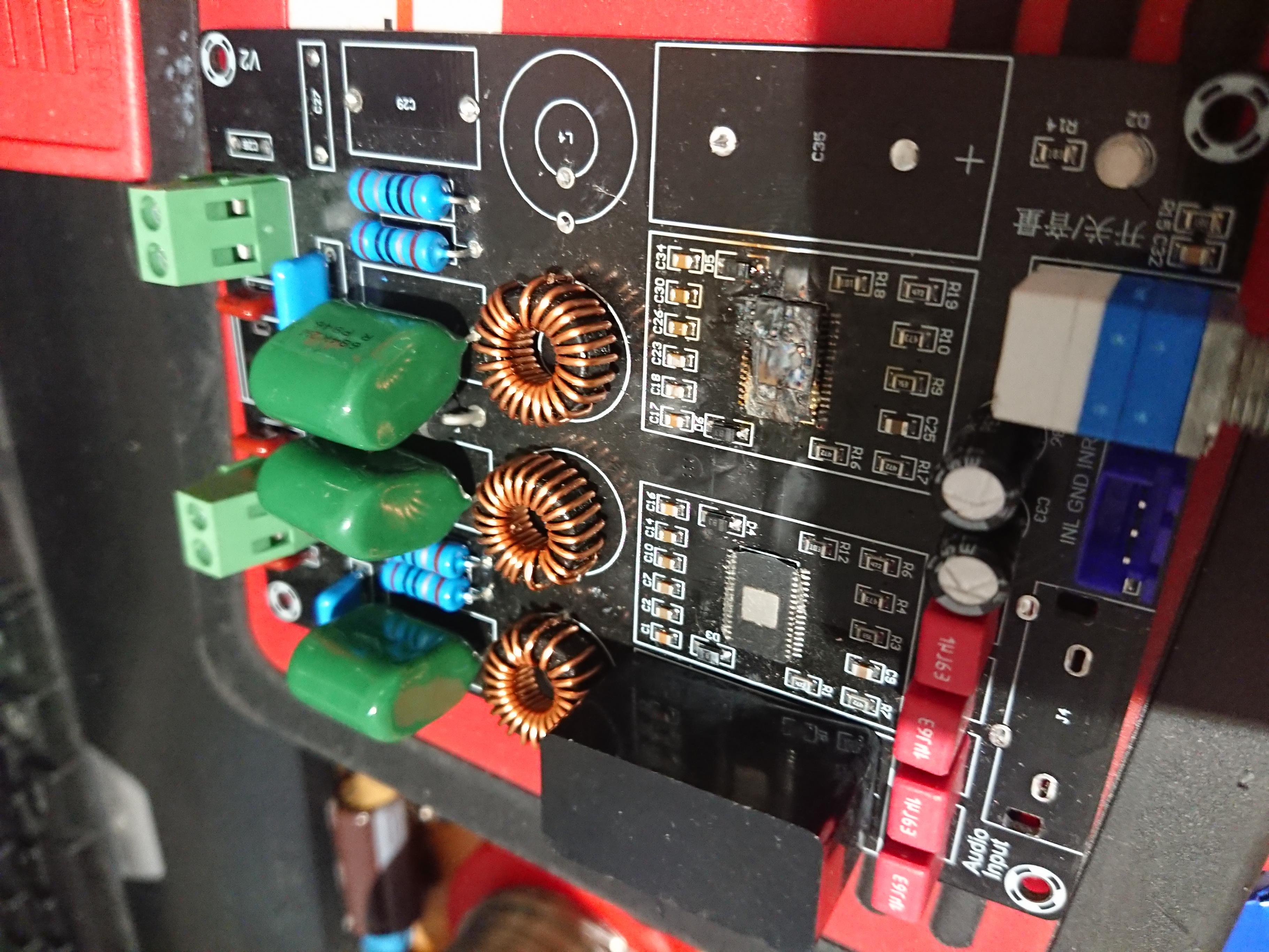

I had the XH-M590. Heatsink was only glued to the chip. No thermale paste.
Very thin pcb trace from tpa3116 to capacitor for the power part.
This problem is on almost all tpa3116 board. If you look at tas561x board or sta516 you have better copper trace for handling the current.
My XH-M590 had after first test one channel burned. Only tpa3116 board with smoking dead

I have the same board as hansueli and also same problem. It pulsed DC through one channel. ONLY after I pulled the heatsink off. I think the glue was too strong and I pulled a chip pad.
It worked up until then so advise DONT remove heatsink.! I was drawn to this board by the large foil output caps.
