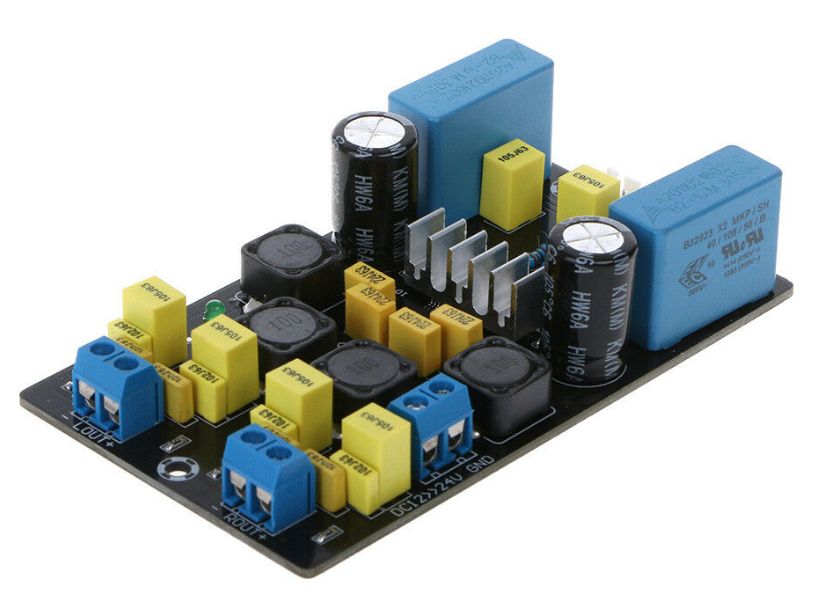

So the board I ordered isn't quite like in the photos on Aliexpress!
£8.02 18%OFF | JINSHENGDA Amplifier TPA3116D2 50Wx2 Official Version Finished Stereo Digital Power Amplifier Board -R179 Drop Shipping
JINSHENGDA Amplifier TPA3116D2 50Wx2 Official Version Finished Stereo Digital Power Amplifier Board R179 Drop Shipping-in Amplifier from Consumer Electronics on Aliexpress.com | Alibaba Group
Some components are SMD that aren't in the listing. The resistors nearest the outputs for instance are SMD. At least the caps and gain setting R are still all through hole.
This maybe is more Yellow/ black board as they have swapped a lot of the blue caps!

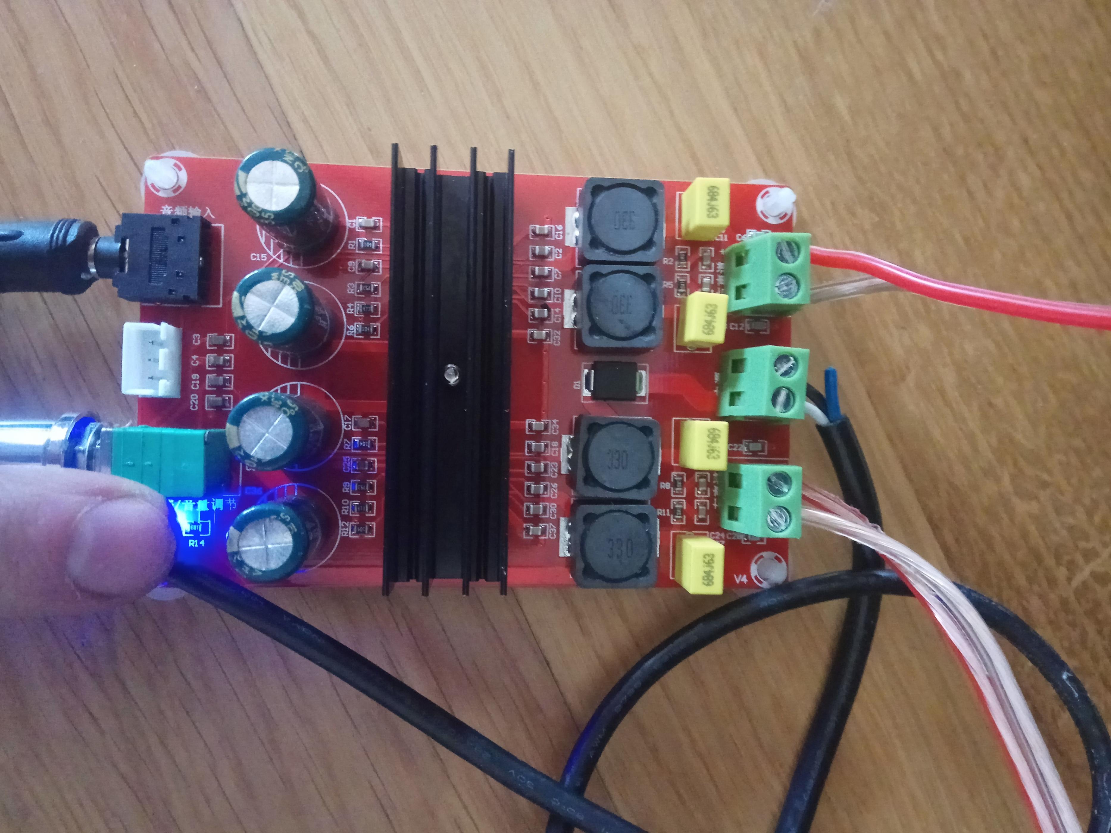

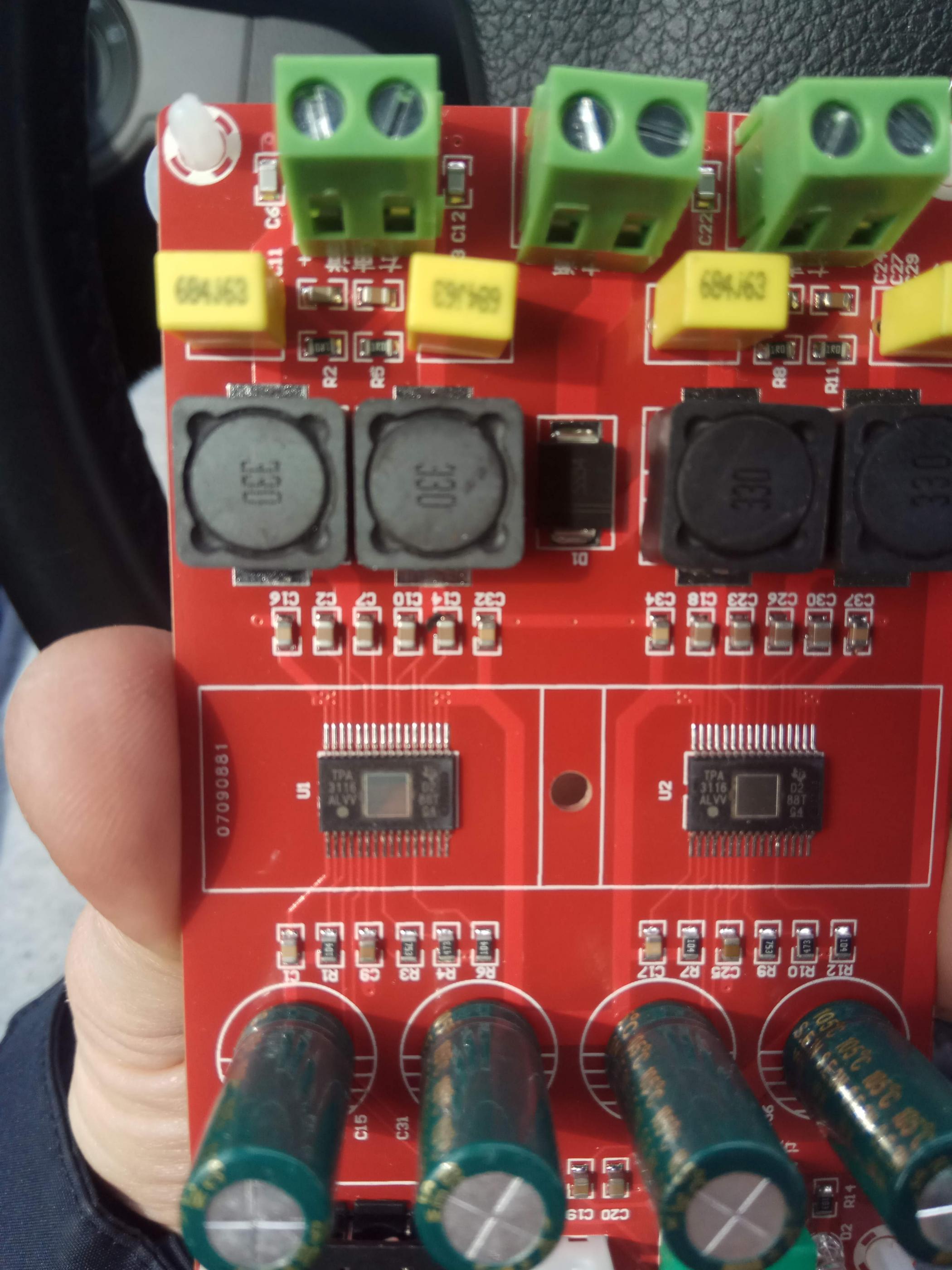

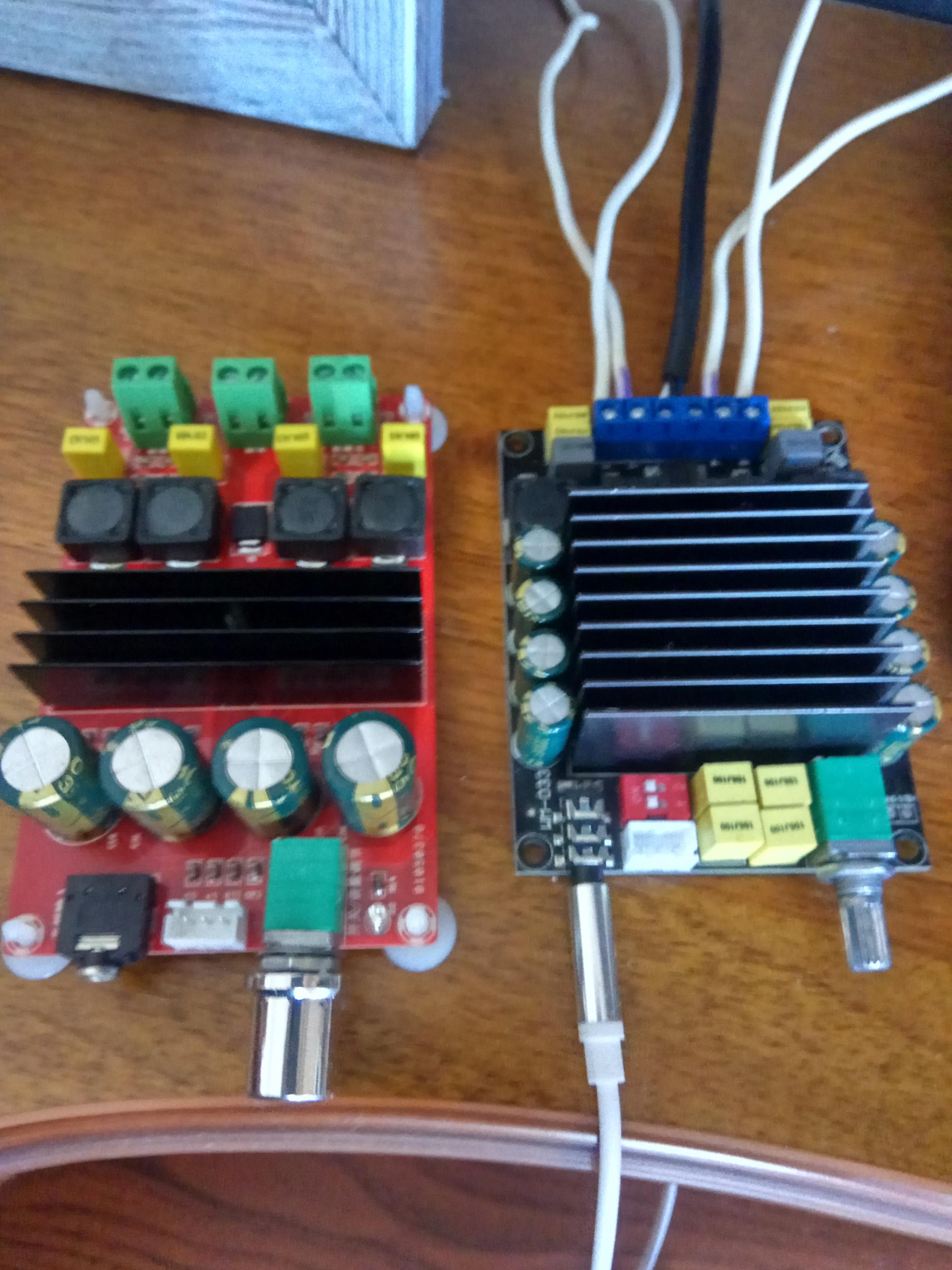

Oh, sorry mates. I noticed that especially mine tpa3116 board topology weaker than others budget friendly items based on tpa3255&tda7498 chips. I am not in position yet to dive deeper with coils&gains changes, just comparing out of the box. However even this tpa3116 sounding far better of many oldschool AB amps. Here is the photos of mone

Your two chip 3116 seems to have output coils with too much uH for it´s size. Such 330 will have a far greater resistance than the "normaly" neccesary coils with 100. Depends of the load you drive, of course. So if one may make a prediction from the picture, your chip amp should suffer from some missing "umpf" in the lower frequncy, weak loudspeaker control and distortion with higher volume.
Just a guess.
I have a quite similar looking single chip 3116 amp that sounds just fine.

hi anatonliy
that red board looks like a dual chip version. try to read my thread and set the gain down! --> 20db..its not so difficult.
https://www.diyaudio.com/forums/cla...tpa3116-2-0-100w-dual-chip-7.html#post5808616
change the coils like turbowatch2 wrote to 10µH--"100". then its sounding fine.power supply not to high...chekc the ratings on the caps..about 24-34V should be ok. max is 36V so keep 2 Volts less then that.
chris
Chris, I tried this tpa3116 board with Canton SC-L and B&W Rock solid monitors both are 8Hom resistance and low frequency are quite well pumped with 19V/7A adaptor brick from LCD monitor, even with 19V/4A I see not significant difference. Perhaps will read how to reduce gain and replace coils since you're voted for better performance after twiking. Have no idea why China's masters won't do proper design out of the box.... And yes, this board is double chip with bridged chips. Actually I have two boards. BTW ,is it possible to make them works as double bridge mode getting two voards in mono for LR channel s?
chris
It is my understanding from the data sheets that the absolute maximum supply for the TPA311x chips is 30V
I would say that most people run them at 24V or lower and if you wish to push them and be safe then operate at a couple of volts less than the 30V of absolute maximum.
