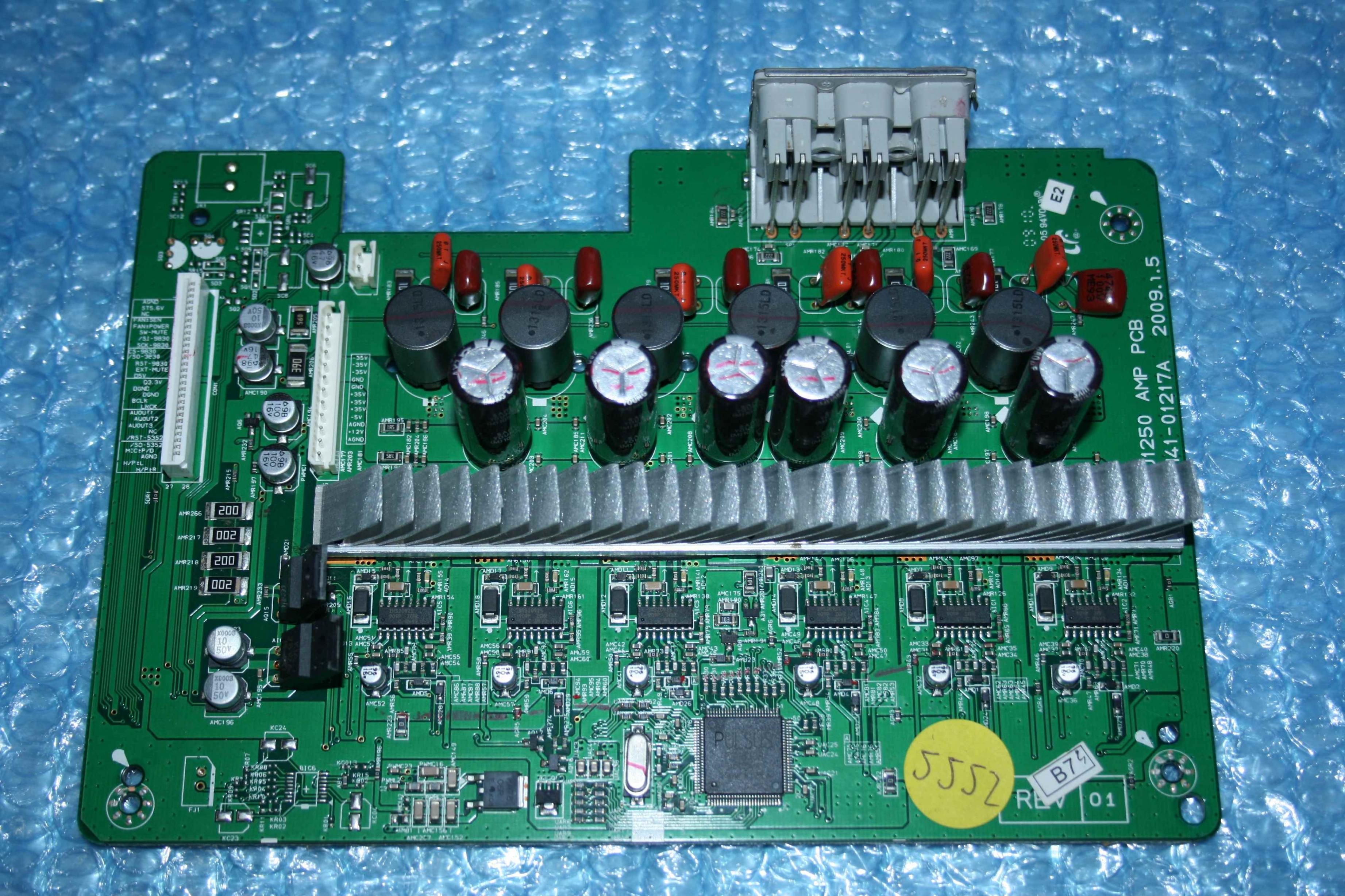

I got this board for cheap:
Thanks!
I really like this board, the tpa3116 has a good reputation and the layout has a minimum number of components to get in the way of the signal.
Unfortunatly the power rating is 100watts x 2 peak, 50 watts rms x2 which is probably too low for me. Can you explain the paralleling two channels into one chip that you mntioned, how can that be done.
